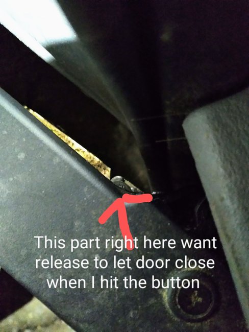

Okay. I thought that I attached that part. So, it is hard to understand what you are looking at as I am not sure what you are seeing as "releasing the door"
Can you get a picture of these parts that you are looking for and I will see if I can find part numbers? Thanks

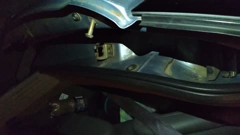

I took the van to a shop finely and they couldn't solve the vans issue. so now when I hit the button to close the door instead of the one click and not releasing to close, it has gotten worse. now it's like multiple clicks and grinding sound at the same time.

This is what it's doing now

This is where it first started

It turns out that part I sent you just keeps the door from closing on its own and when the door lock motor assembly stops working that part will not release because it has to go through steps and if one of them doesn't work, they all don't. does that sound about right?
Jan 6, 2022 at 10:21 PM
Okay. Again, I suspect you have a motor issue. That grinding noise that you are hearing is the motor trying to move the door, but it doesn't move.
I understand you may want more proof and I don't blame you, but I am not sure I am going to be able to give you that proof without the scan tool to monitor what I stated earlier.
At this point, all I can tell you is what I would do and that is replace the motor.

I understand. There is not a way to check this manually because if you use a test light then you are just finding out if there is power getting to the motor.
However, you already know that it is because you can hear it engaging. The problem is, it is not moving the door and the grinding that you hear is the motor gear slipping in the track.
So, if you want to do more testing, remove the door panel and lay inside the vehicle and watch the operation of the track and motor and I am sure you will see it slipping.
This means you need to remove the motor and inspect the track and gear to see which is worn and normally it is the motor.
