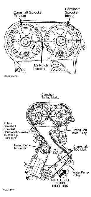

I need to know how to set the timing belt on this car.
Oct 29, 2019 at 6:26 PM (Merged)
MHPAUTOS
  • 31,937 POSTS
Hi there, Engine timing belt set up as per pic. Mark (mhpautos)

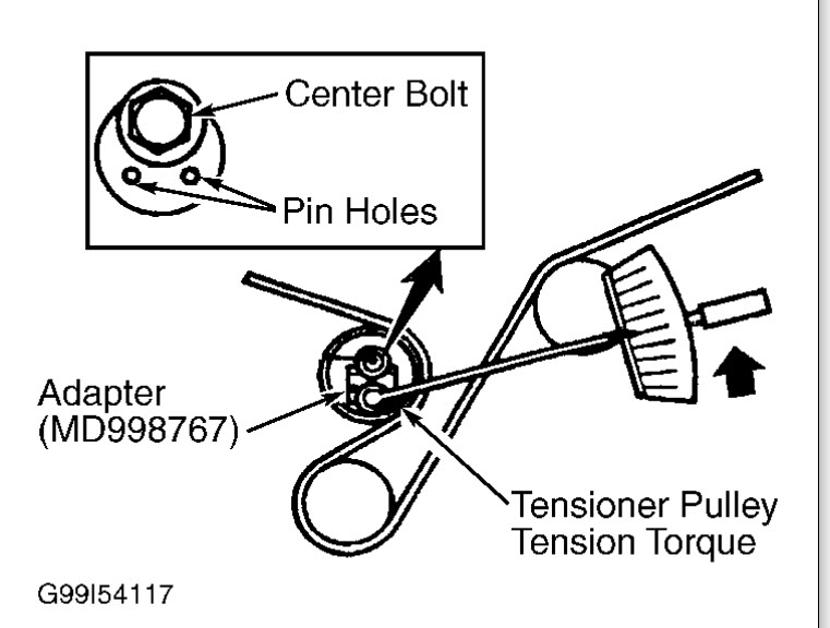

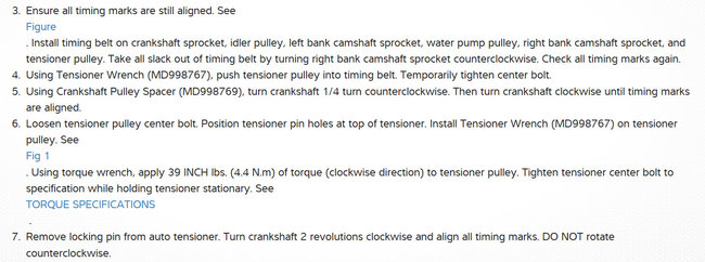

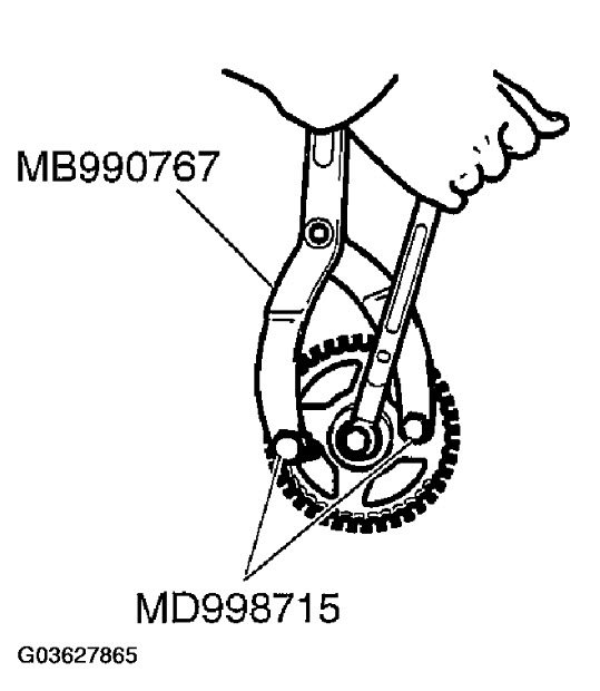

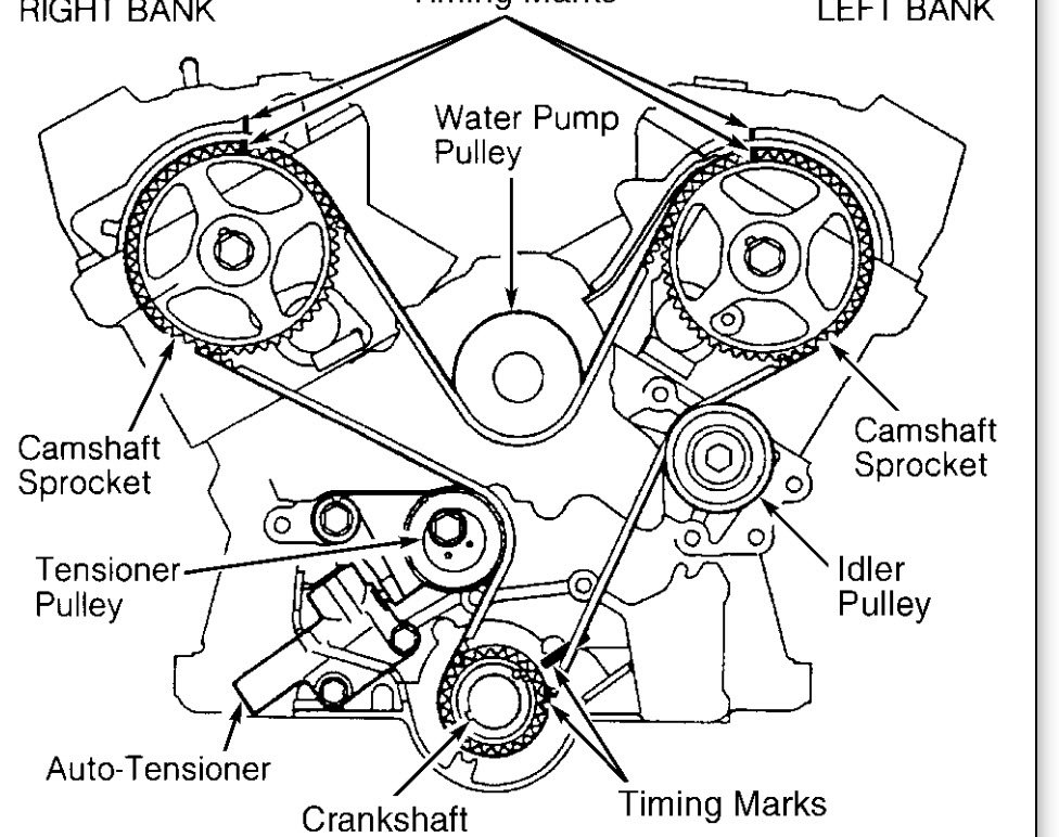

ALLEN HUCKABEE

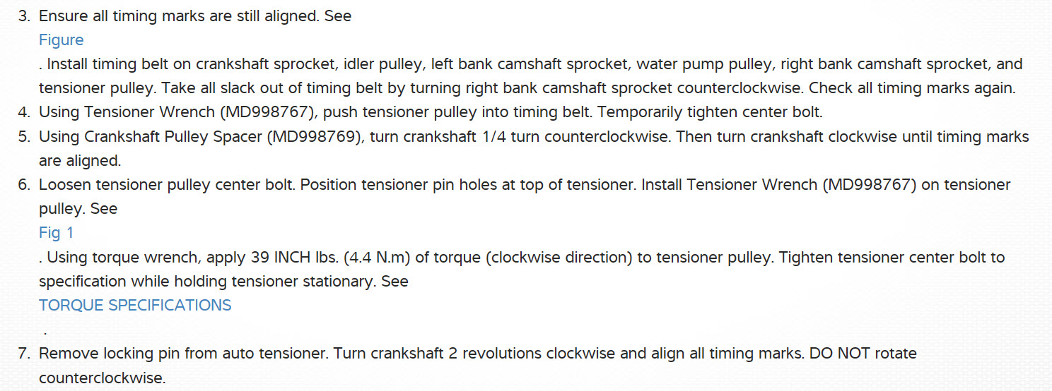

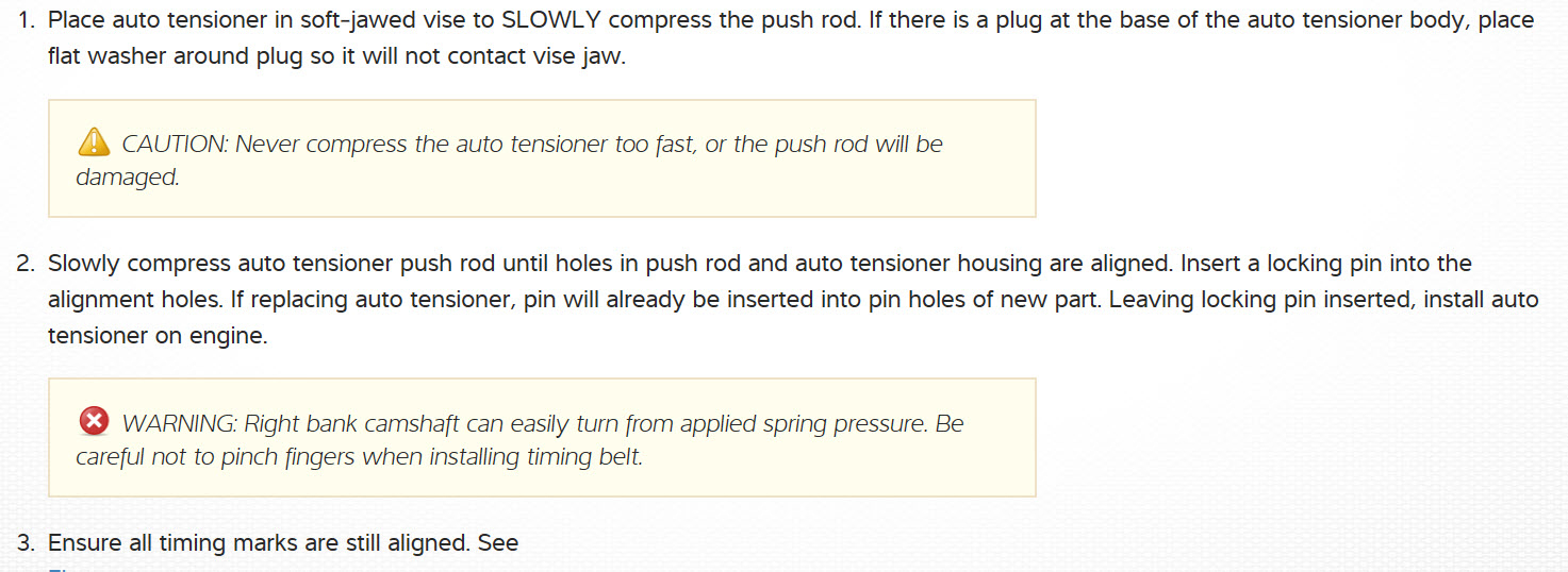

I am in the process of aligning the camshafts to install a new timing belt, but I cannot get the rear camshaft (number one cylinder) timing mark to align properly. When I turn the camshaft, to pops by the mark and is about nine teeth off (see arrow in attached image).
Any suggestions?
Oct 29, 2019 at 6:28 PM (Merged)
HMAC300
  • 48,601 POSTS
you may have not backed off auto tension-er and pinned in place. see instructions and recheck your work to it.

HMAC300
  • 48,601 POSTS
once you get cam in place you may need to lock it down so it does not move. also, this is an interference engine so do not turn engine over while belt off. See special tool picture.

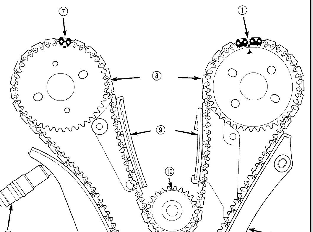

RANDY SHARP
  • 165 POSTS
When you have the gold links on the chain lined up with the mark on the oil pump housing and the mark on the crank and the the gold link, and on the right bank the single gold one lined up with the round circle , and the left lined up with the arrow in between the two gold ones. Is that when on the cams you suppose to see the timing marks the dots and the 12 pins with the piston at TDC on the exhaust stroke?
Oct 29, 2019 at 6:29 PM (Merged)

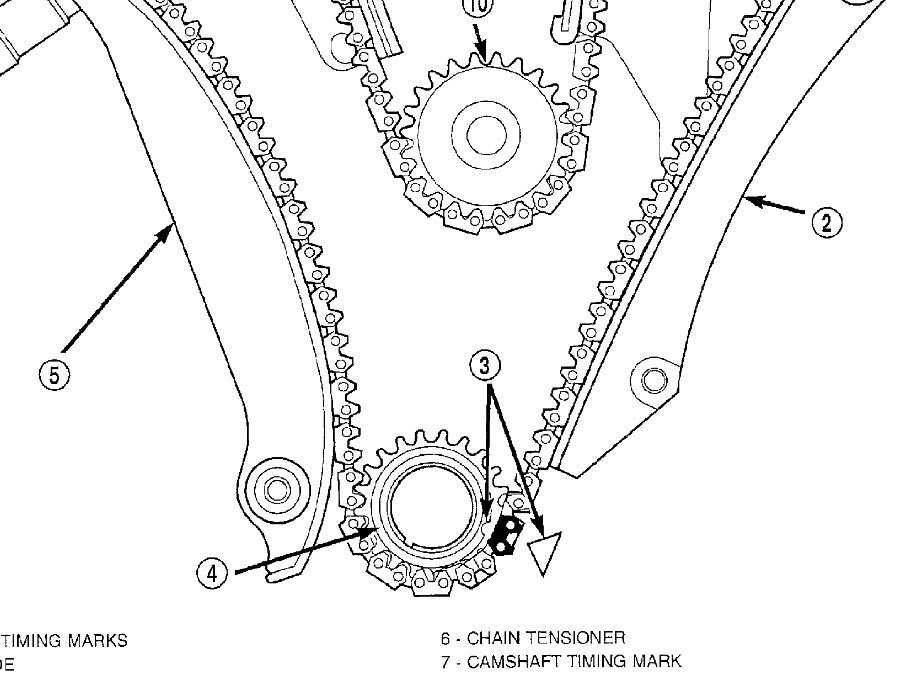

HMAC300
  • 48,601 POSTS
see pictures for diagram left hand side must be done first then force oil from tensioner and lube chain with engine oil prior to install. also either rent a manual from here or buy one so you do not install it wrong it is a lengthy process.
