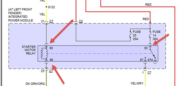

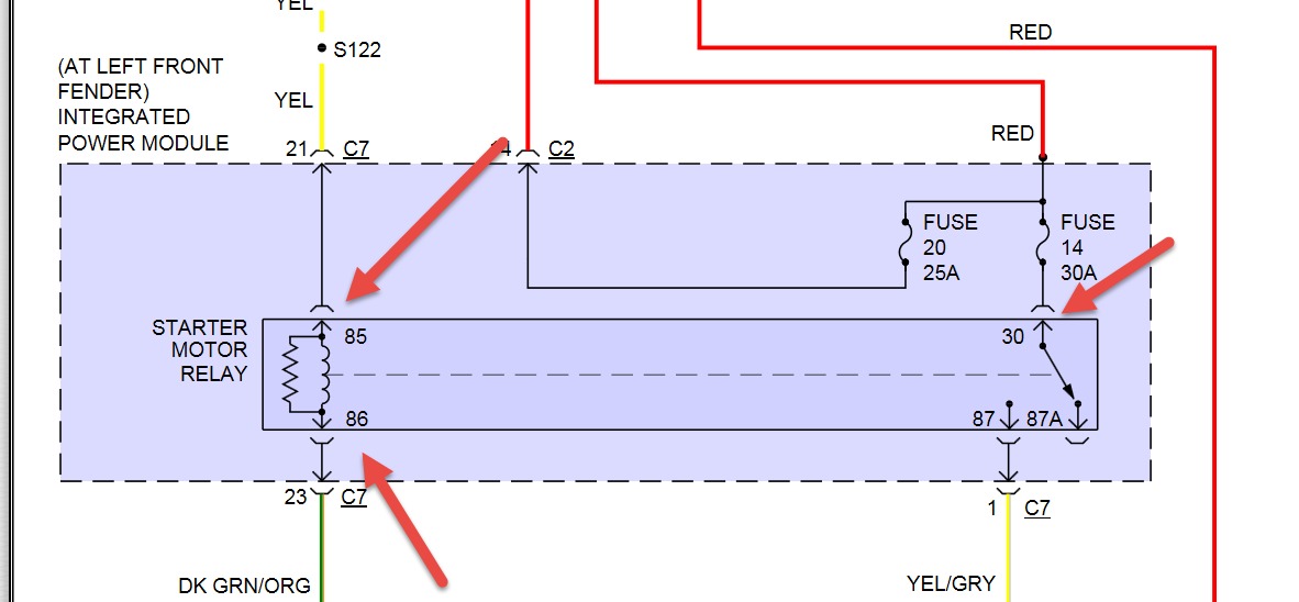

if you get a test light to light at the where arrows are in pic then it's not the pcm it's either bad contact at relay or the yellow wire leading to starter is shorted oryou'll need to get it scanned. I have no further comments nor suggestions.
