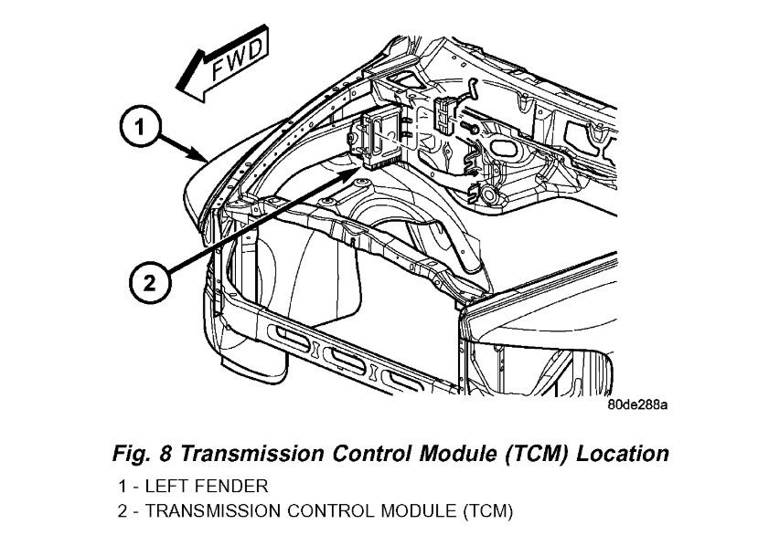

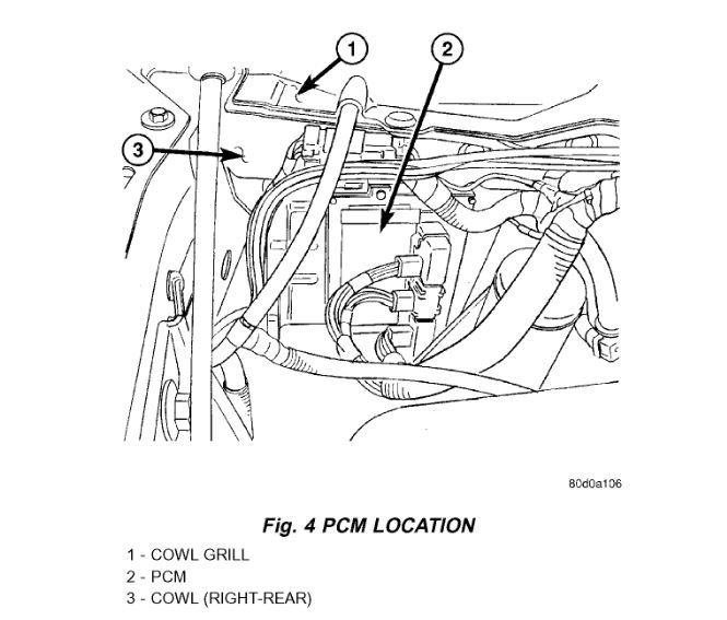

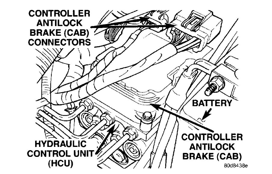

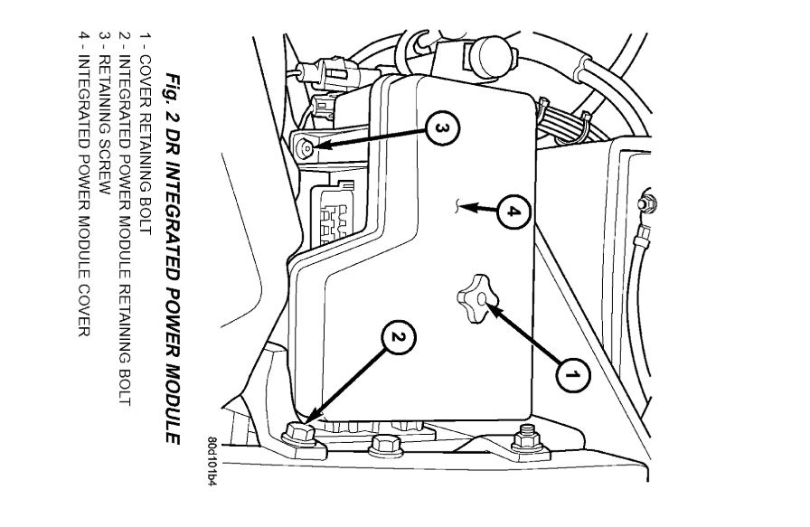

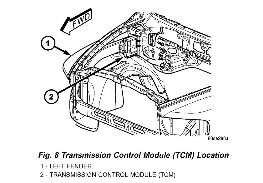

I need to know where the different modules are to try to correct a NO BUS issue.
Jun 9, 2021 at 1:30 PM (Merged)
Good afternoon,
I attached locations of the PCM, TIPM, TCM and the ABS module for you.

thank you. Is there any other modules that I can unplug to try to figure out which is causing me all this grief?
The instrument cluster is a module but if it was an issue, you would have functions in the cluster that would not work.
Start with the ones I listed.
