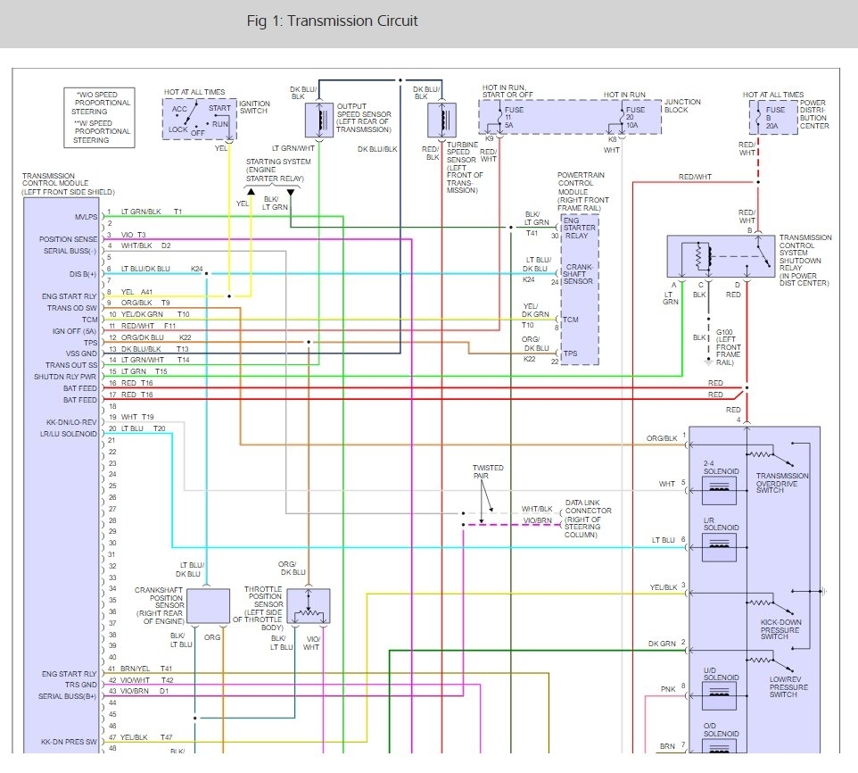

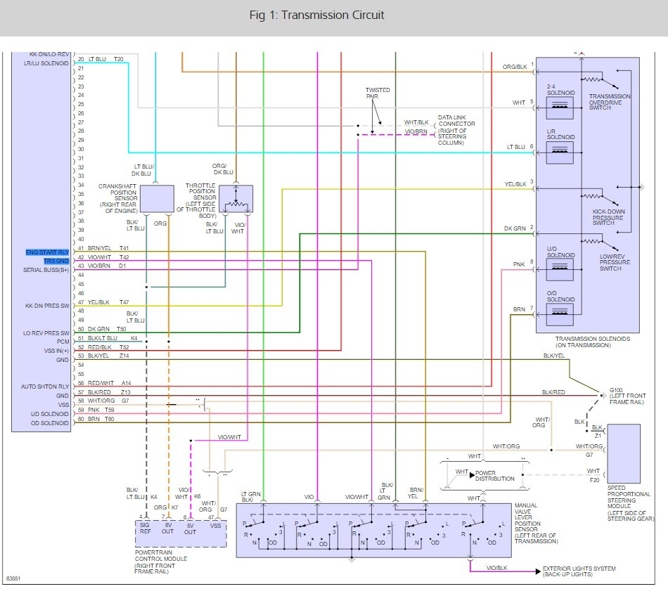

If I can offer my two cents. It sounds like it could be a overdrive transmission solenoid that has shorted causing the computer to shut down. The computer cools and then it starts working again.
Here is a wiring diagram so you can do some checking. Use a volt meter and check the resistance of all solenoids to see if one is shorted, here is a guide to help you too.
Please run some tests and get back to us so we can continue helping you.
