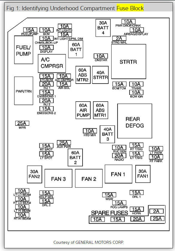

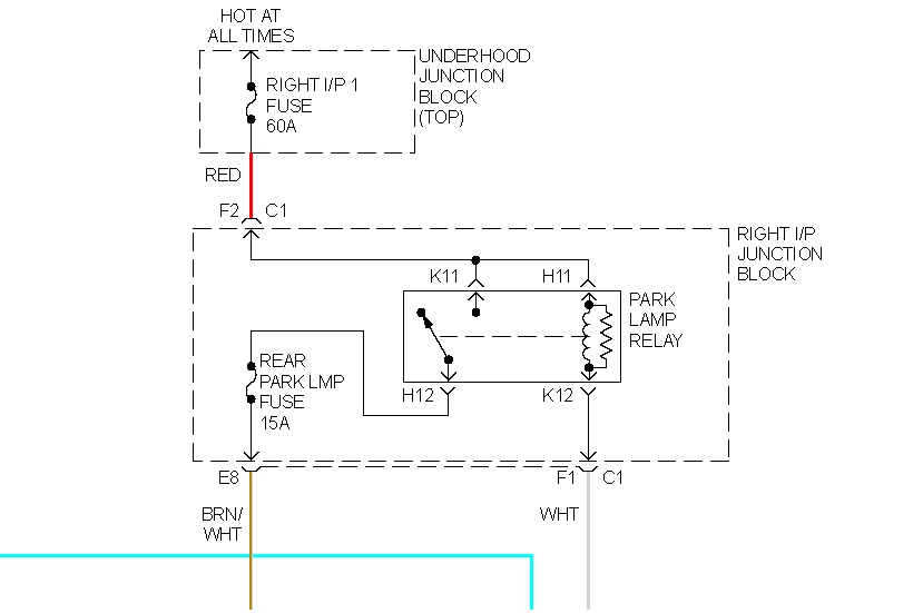

The dash cluster has to be removed to access the bulb sockets on the back.
