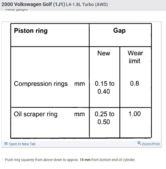

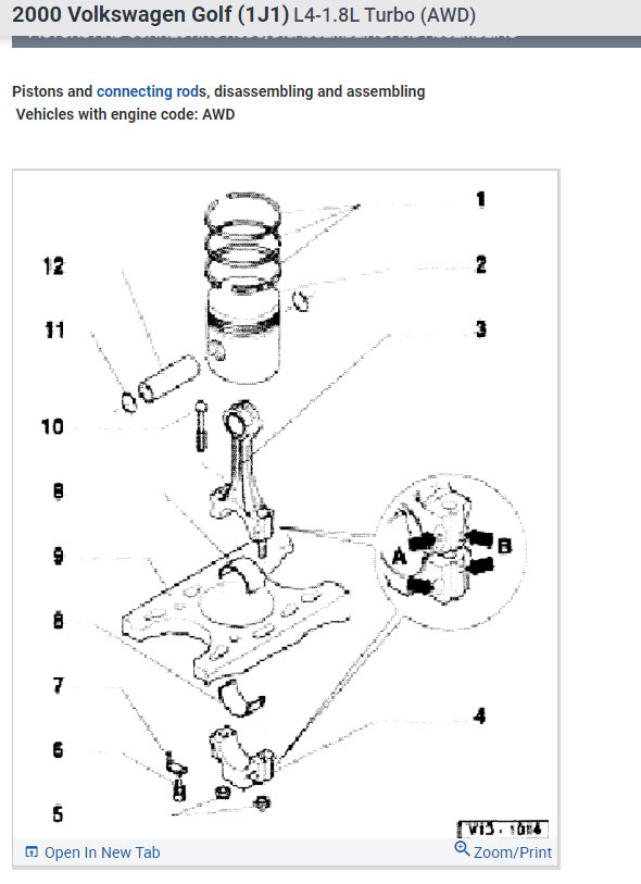

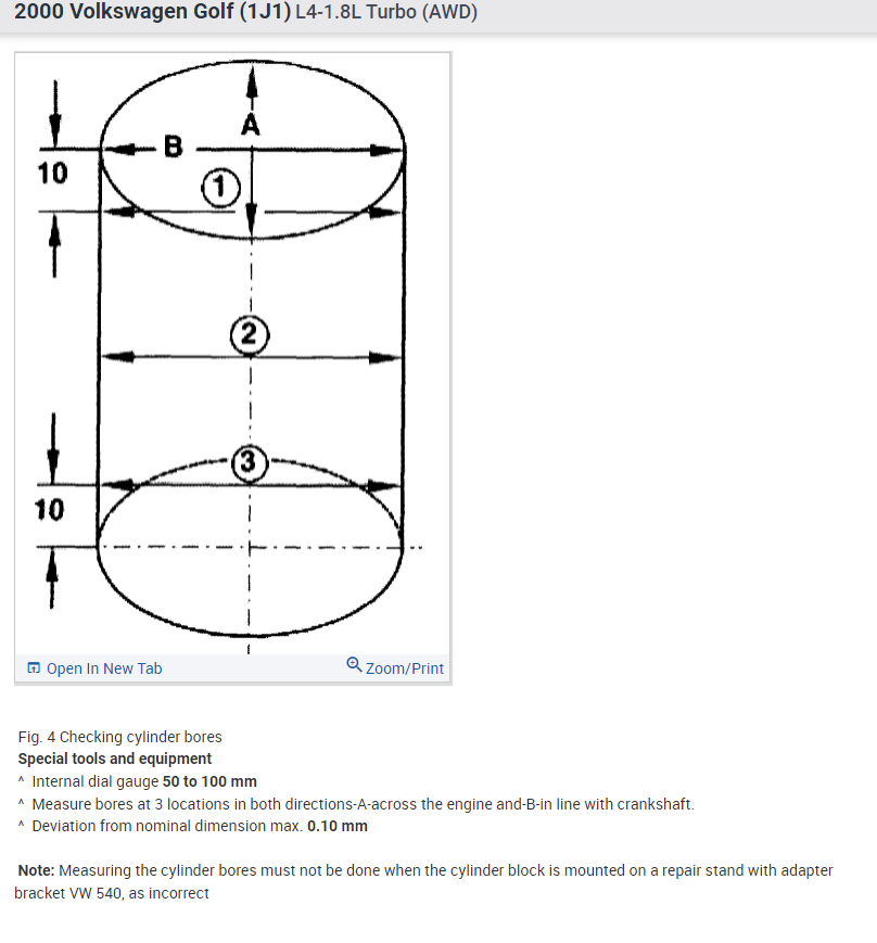

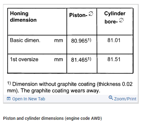

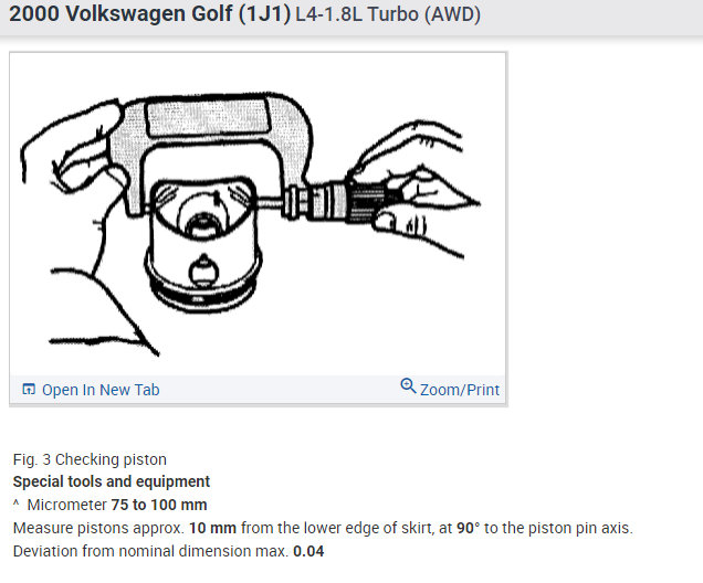

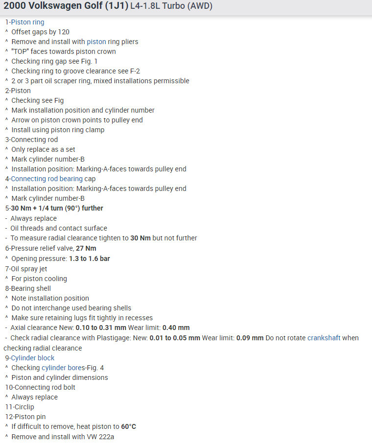

If adding the spoon of oil raises the compression then it points to the piston rings.
You will likely have to change the piston ring in order for the compression to improve.
The popping noise you hear is possibly backfire, due to the un-burnet fuel:
https://www.2carpros.com/articles/engine-backfires-while-running
https://www.2carpros.com/articles/how-a-car-engine-works

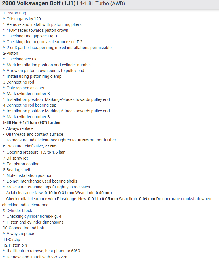

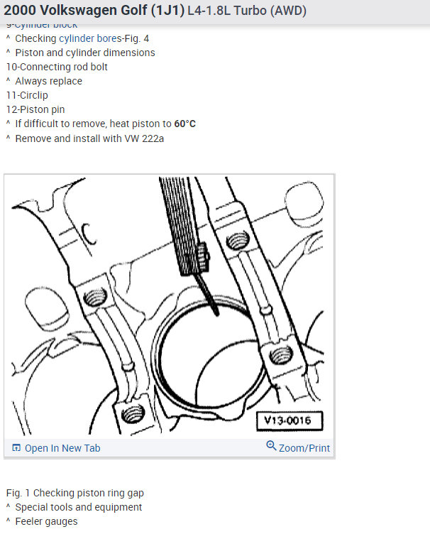

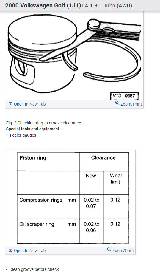

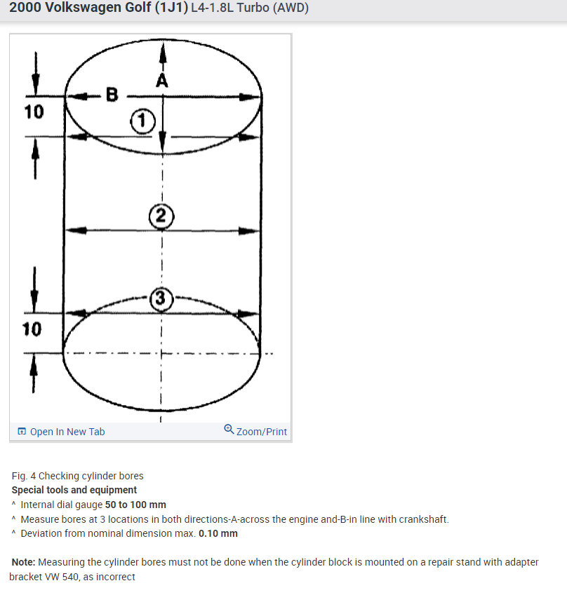

I have attached the basic ring replacement procedure for your reference.
