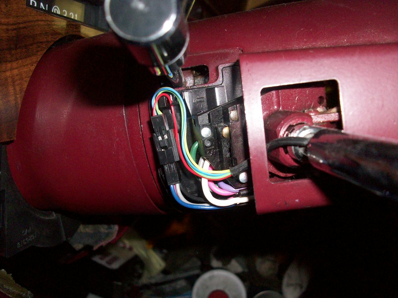

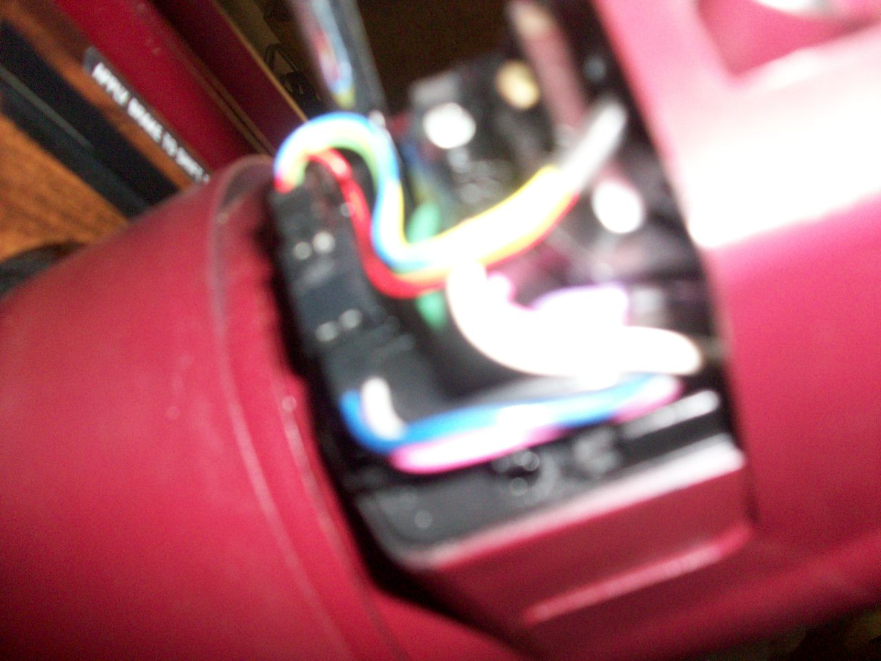

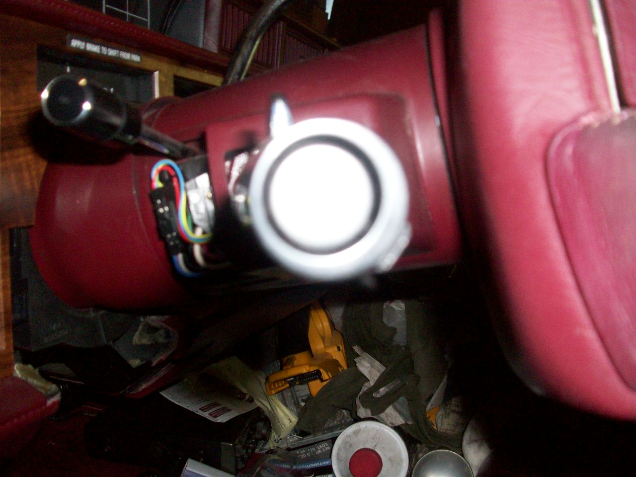

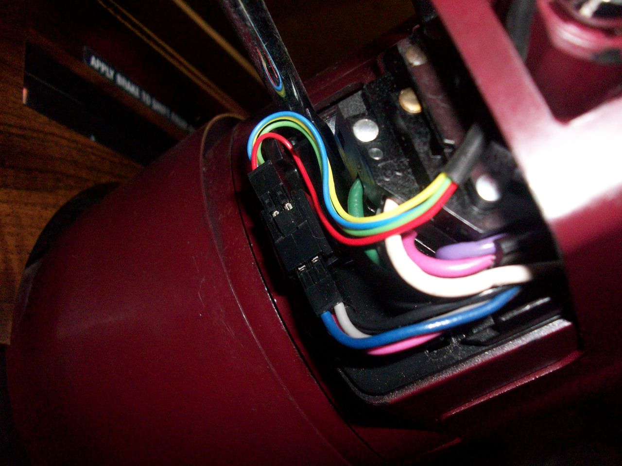

SEAN03
  • 523 POSTS
Ok so I was looking for the brown wire but could not find it. Here are some pictures maybe I am looking in the wrong place.
Oct 26, 2020 at 12:26 PM (Merged)
KHLOW2008
  • 41,814 POSTS
Wire colors seems to be different from the schematic in our database.
There are 4 wires, ensure at least one of it has battery voltage when ignition is turned on.

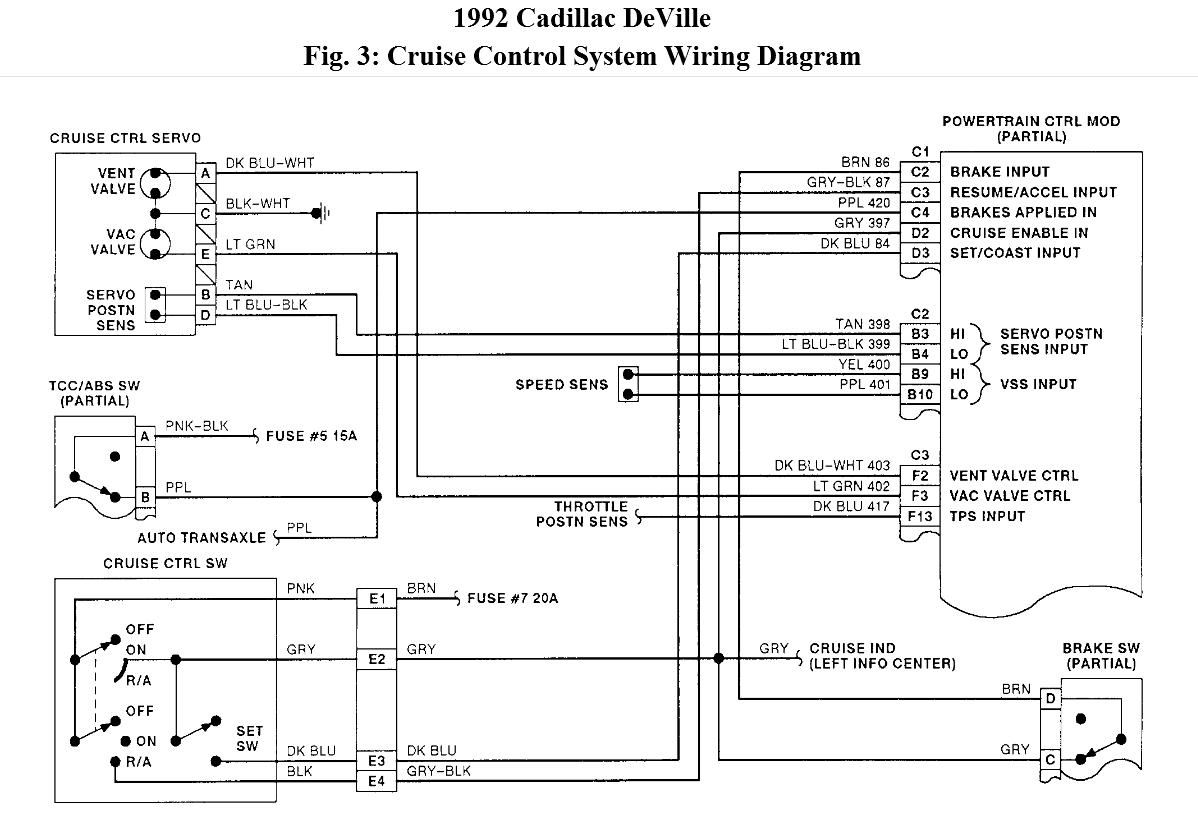

SEAN03
  • 523 POSTS
Ok I blew through the large hole and you can not blow through it. Their is no codes in the system. The small hose has a good vacuum. The number 7 fuse is good I changed that out today. I checked for the voltage before I put the fuse in. It had 12.2 volts which is good. I got confused on the diagram. With the grey pink black and dark blue. How do I check this. Do I put the positive volt meter on one and then put the negative probe on the other. If you could explain on how to do this I would greatly appreciate it. Thanks for all your time and help.

  • 3,544 POSTS
u needed to do what khl said.test for power with key on on the pink wire and ground on black.as simple as that.
SEAN03
  • 523 POSTS
Ok so I just did this a few seconds ago after you posted I put the positive on the pink wire and the negative on the black wire. It showed 12 volts exact on my volt meter with the car on the run position not started.
Oct 26, 2020 at 12:27 PM (Merged)
