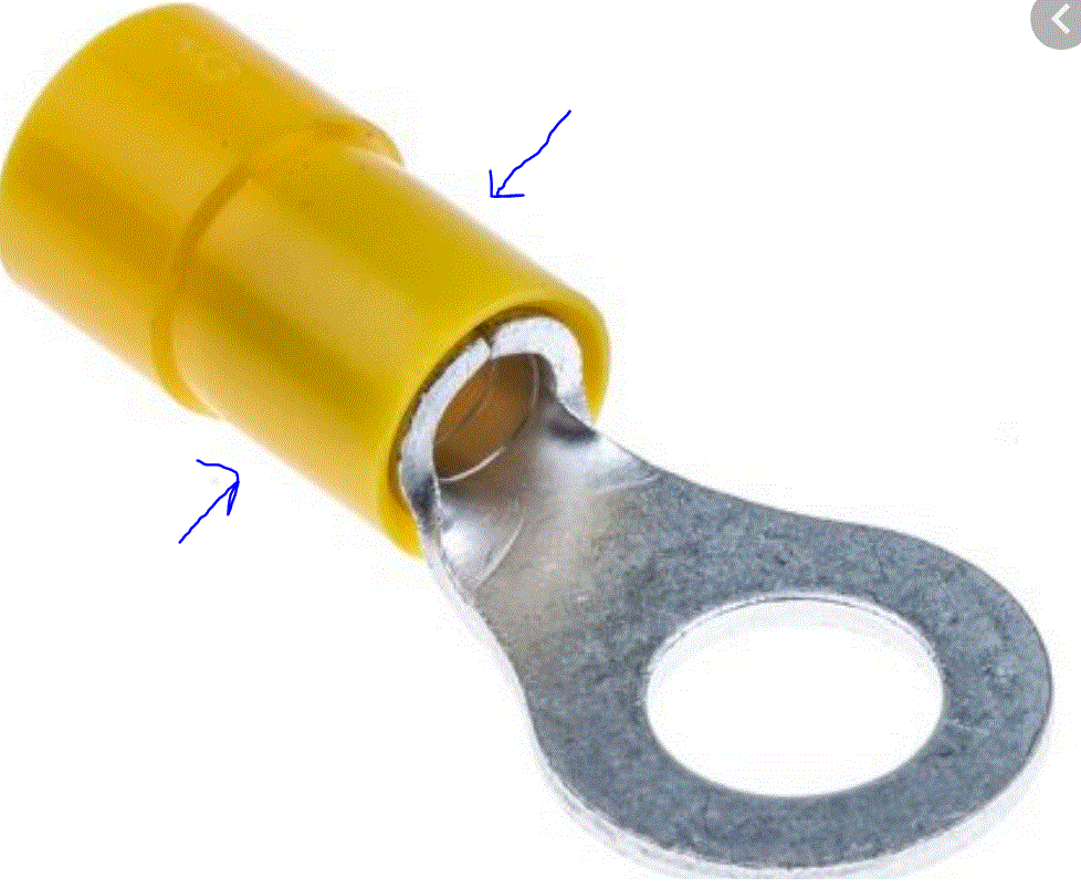

Is the ground (negative) connected? As far as a special tool, they make wire crimper. Just go to any parts store and tell them you need a crimp connector. I attached a pic of what you will be looking for. Tell them you need the tool to crimp the connector to the wire.
When doing it, strip approximately 3/4" of insulation from the end of the wire. Push it through the connector and then crimp where I have the arrows pointing in the pic.

They make crimp connectors which is what I suggest. Simply remove approximately 3/4" of insulation from the end of the wire, insert it into the connector, and crimp it where I have the arrows pointing in the pic. And yes, they do make a special tool for this. Any parts store should have one.

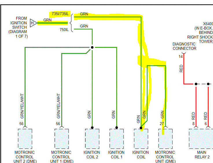

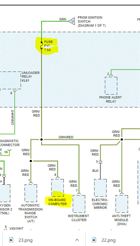

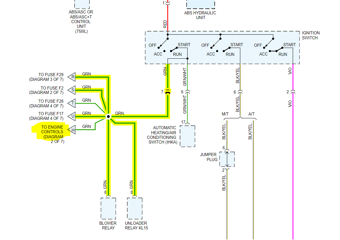

Okay, I need to start at the beginning. If you look at the attached pic, it shows wires out from the ignition switch. The green wire is what powers the coil. Is there power to that wire when the key is in the on position at the switch? If there is, you need to identify the green wire at the coil and see if it has power. You indicated they are both black. It is possible that they are mixed up, so check for power with a test light on both the + and the -- terminals and let me know if there is power on either.

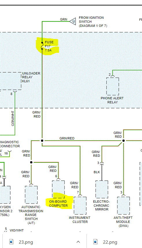

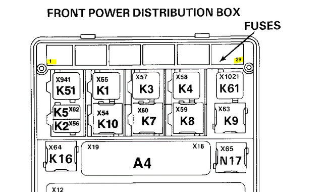

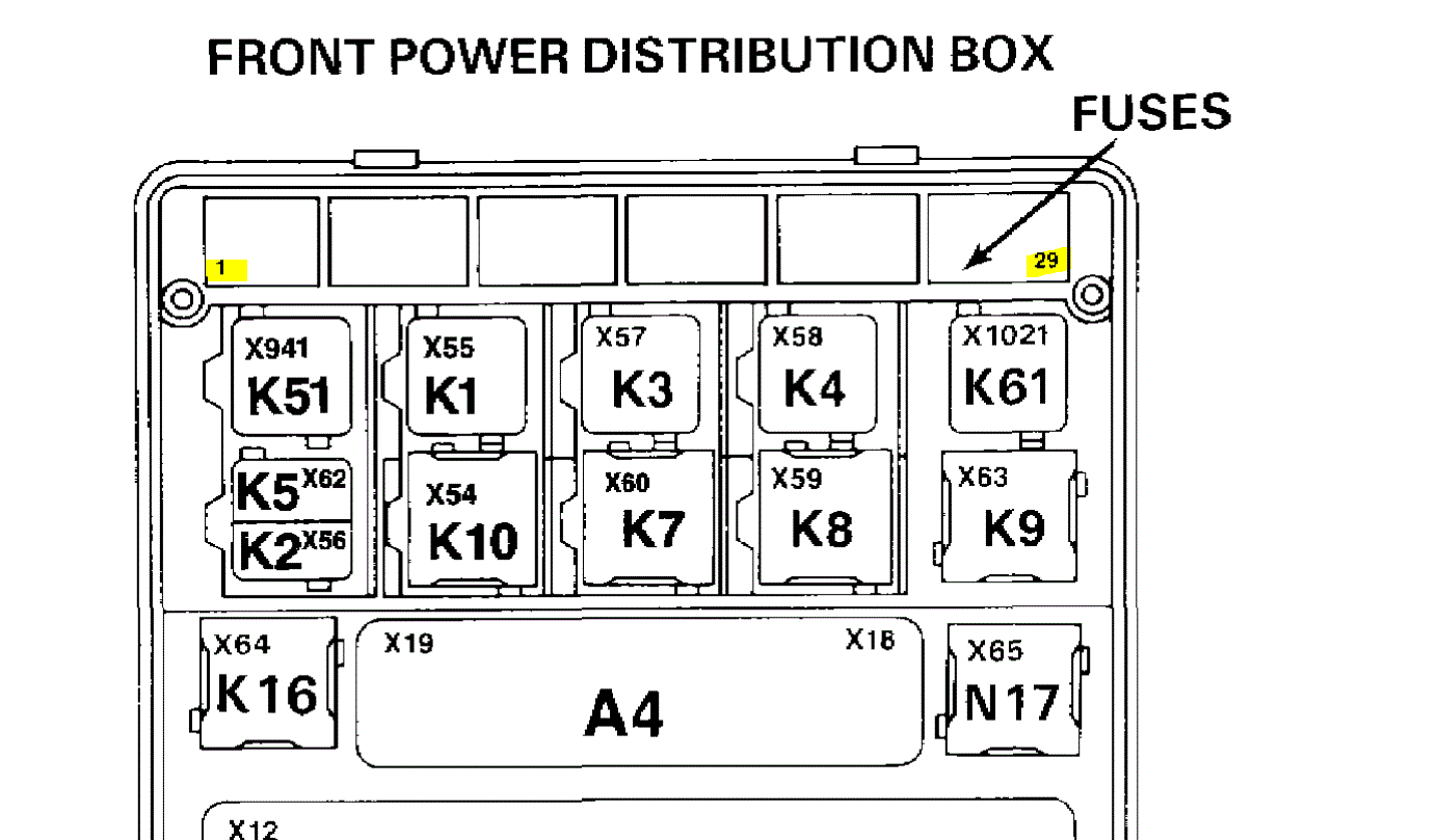

If there isn't, we have to find the break in that wire. The same green wires power the onboard computer. See pic 3. I want you to check fuse 17. Also, pic 4 shows the location of fuse 17. You need to count from left to right until you reach the 17th fuse. Check that and let me know if it is good. In addition to checking the fuse, make sure there is power to it.

HI, i did test the green wire on ignition switch with my multimeter and it was good and did check fuse 17 which was good and also checked the fuse box connection where fuse 17 goes into and it was good too. because when i removed the fuse the dash lights turned off and turning back on with i put it back. I did remove ignition coil to test coil wires and did find positive wire the rubber was wearing off and saw the green wire. Did use multimeter on dc mode and there was power on both positive and negative. Did notice the new ignition coil was cracked at the bottom and melted. How is this possible the car never started once since putting the new coil and is it possible that i caused that damage to the new coil? I'm getting a another ignition coil soon. Let me know what you think. Thanks.

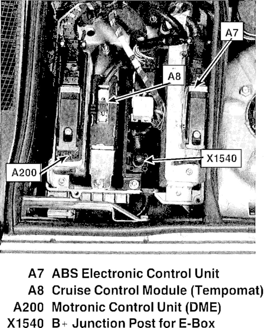

okay, i know where to box is located and is a8 the ignition control unit?
Oct 30, 2020 at 5:06 PM
No, the DEM is what you are looking for. It's the motronic module.
