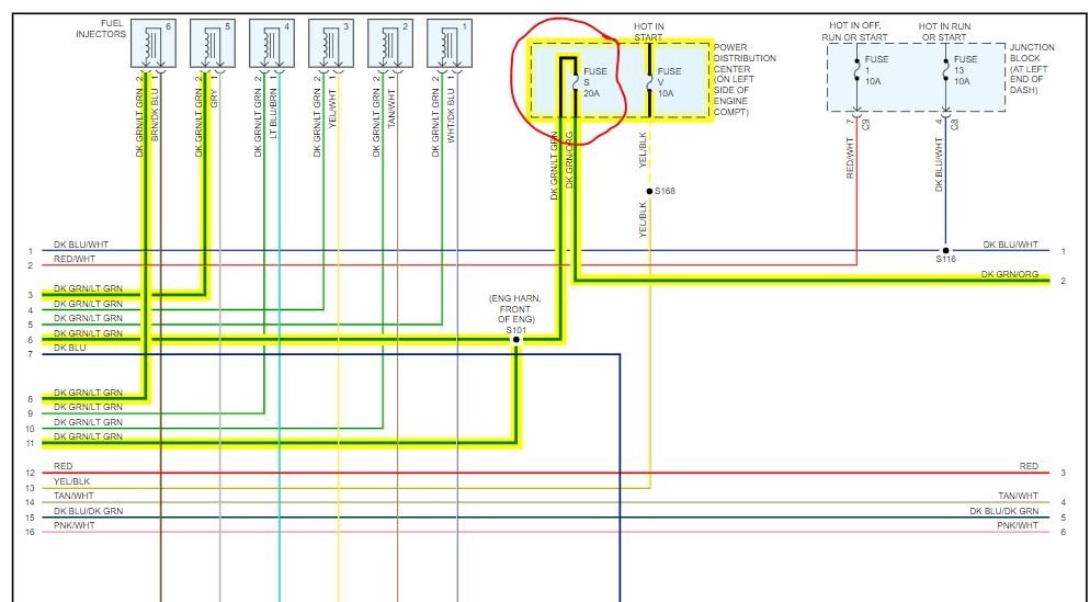

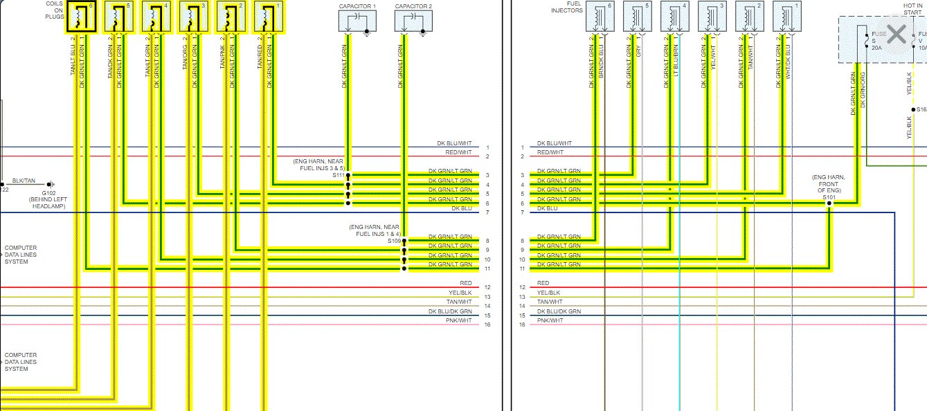

I have another question about that car. after I got it started 3 coils are not firing and we've tested the coils and they're good so how do I trace down a break or something in wires?
Aug 28, 2020 at 7:02 PM
Make sure there is battery voltage to one of the wires in the connector. The other wire goes to the ECM for grounding. When the ECM grounds that wire, the coil sends off spark.
Look for more damage to the ECM harness. It sounds like there is more damage somewhere.
Aug 28, 2020 at 7:18 PM

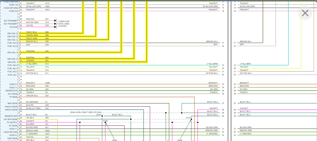

I attached the diagram of the coils to the ECM. You need to the wiring to the ECM to be sure there is voltage to the connector.
Aug 29, 2020 at 4:33 PM

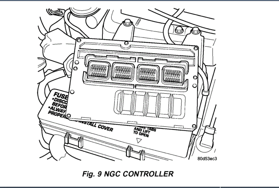

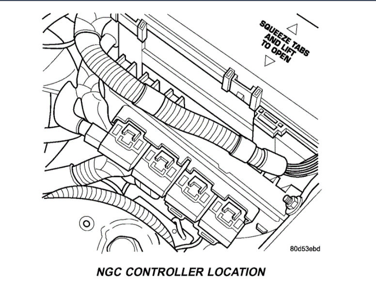

Correct. The ECM inside circuitry is what controls the grounds for those 3 coils.
Aug 30, 2020 at 10:59 AM
LOREN STOVER
  • 130 POSTS
Okay. one more thing; is there a diagram of the plug I need to look at? because all my wires are discolored from age.
Aug 30, 2020 at 11:02 AM

I attached the diagram back a few posts and I highlighted the wires and the connector numbers for you.
Aug 30, 2020 at 11:08 AM

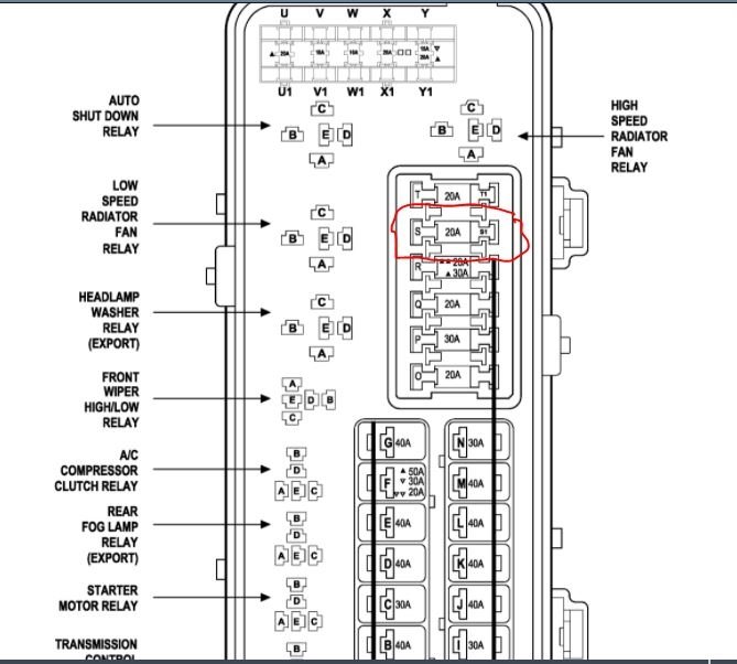

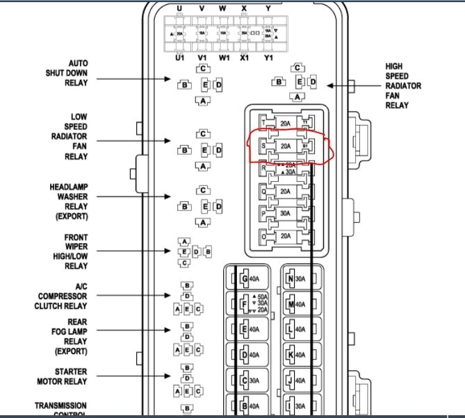

I checked all the power wires going to the coils and none of them have a 5 volt reference. what do I do next?
Sep 22, 2020 at 12:37 PM
You need battery voltage to the coils, not 5 volts.
The power comes from Fuse S in the under hood fuse block. Check for power on both sides of the fuse.
