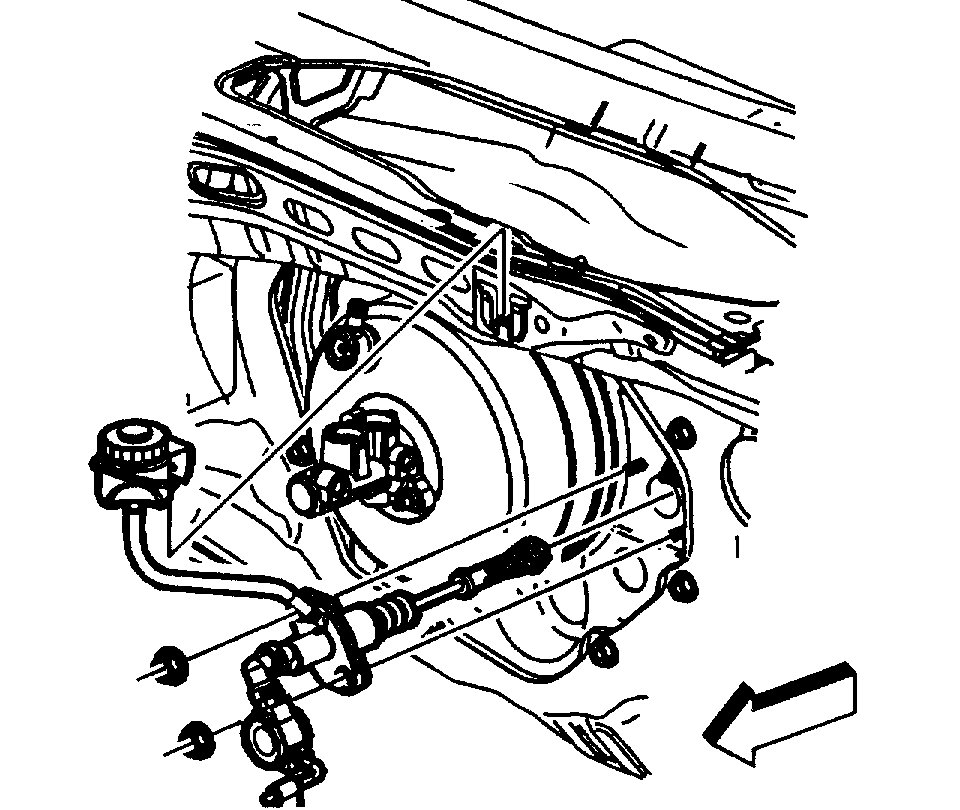

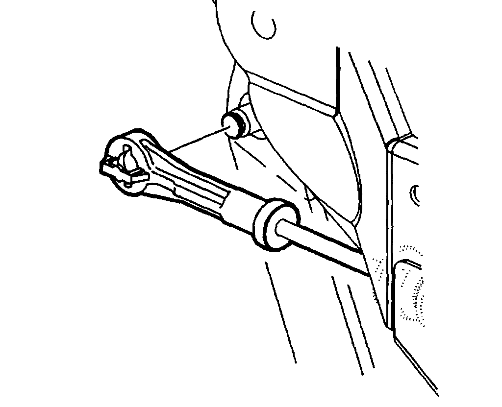

Clutch Actuator Cylinder Replacement
Removal Procedure

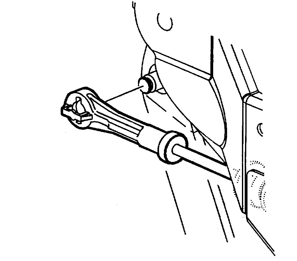

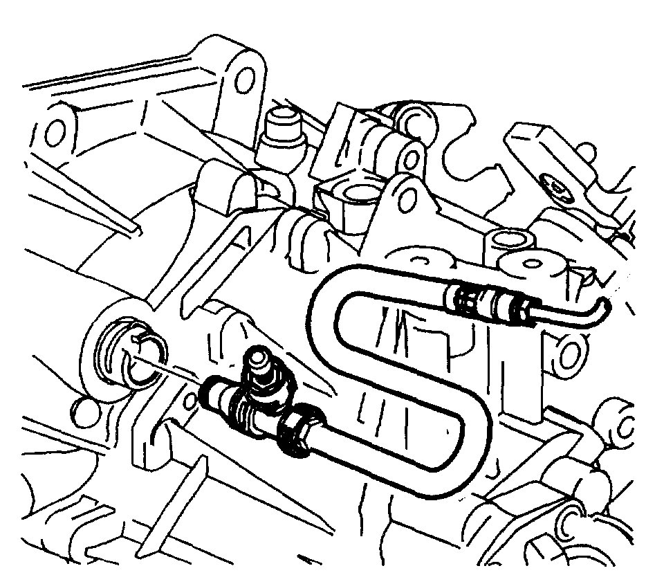

picture 1
1. Disconnect the clutch master cylinder line from the transaxle by removing the C-clip.
2. Remove the transaxle.
3. Remove the clutch actuator cylinder bolts from the transaxle.
4. Remove the clutch actuator cylinder.

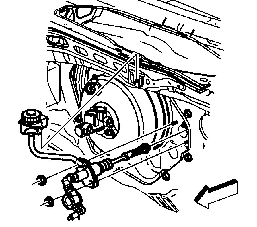

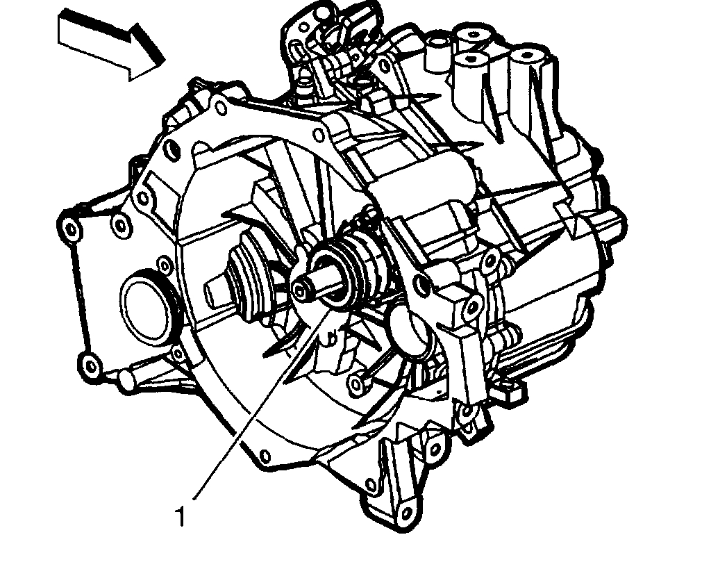

Installation Procedure

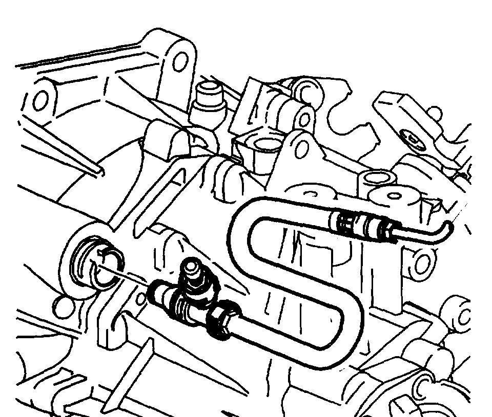

pic 2
Important: Excessive amounts of lubricant on the input shaft splines can contaminate the clutch disc and cause clutch shudder.
1. Lightly lubricate the inside diameter of the bearing with input shaft lubricant P/N 21005995 or equivalent.
2. Install the clutch actuator cylinder (1) to the transaxle.
Notice: Refer to Fastener Notice in Cautions and Notices.
3. Install the clutch actuator cylinder bolts.
- Tighten the bolts to 10 Nm (89 inch lbs.).
4. Install the transaxle.

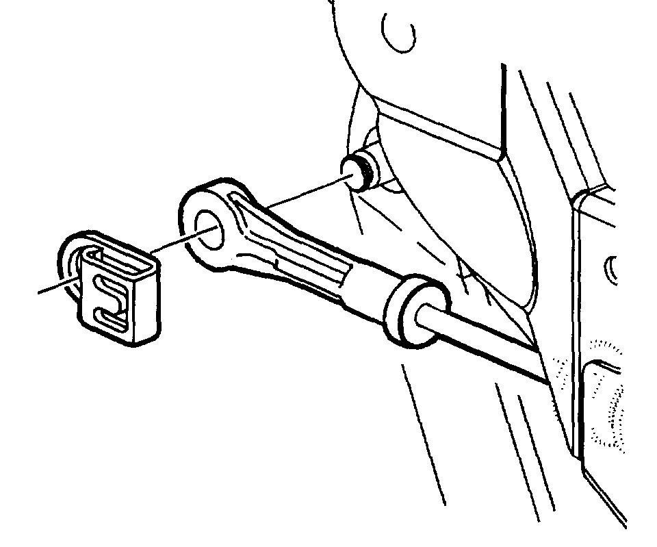

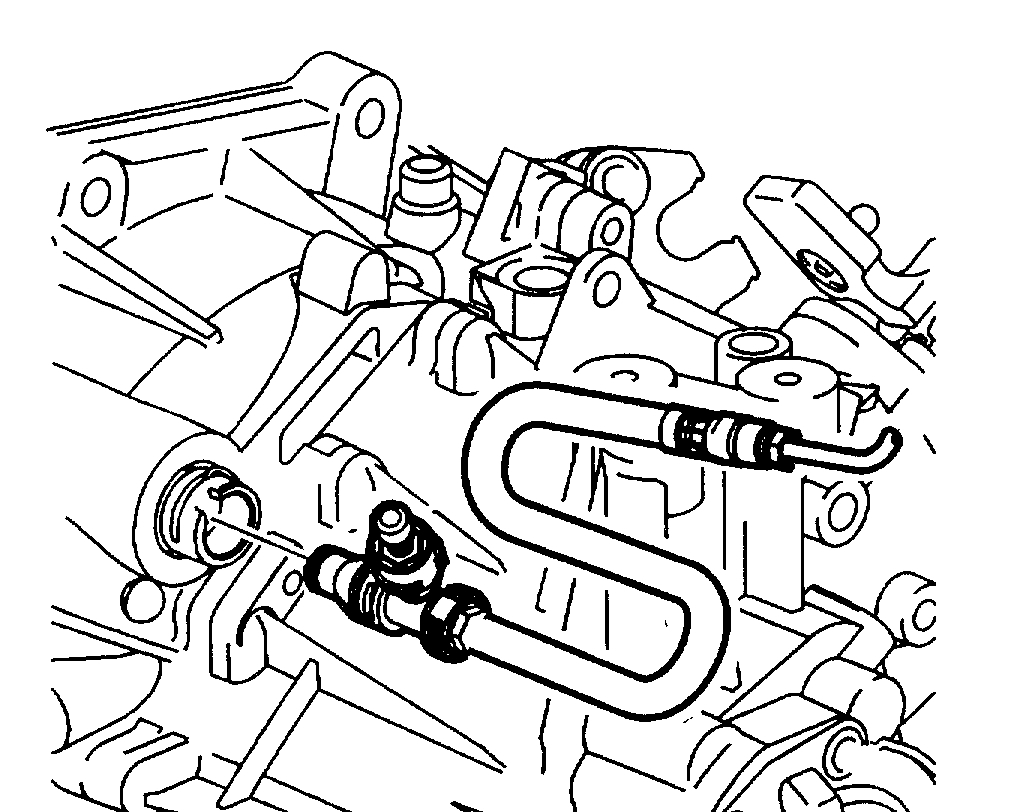

pic 3
5. Connect the clutch master cylinder line to the transaxle by pushing it in until it seats.
6. Bleed the clutch hydraulic system.

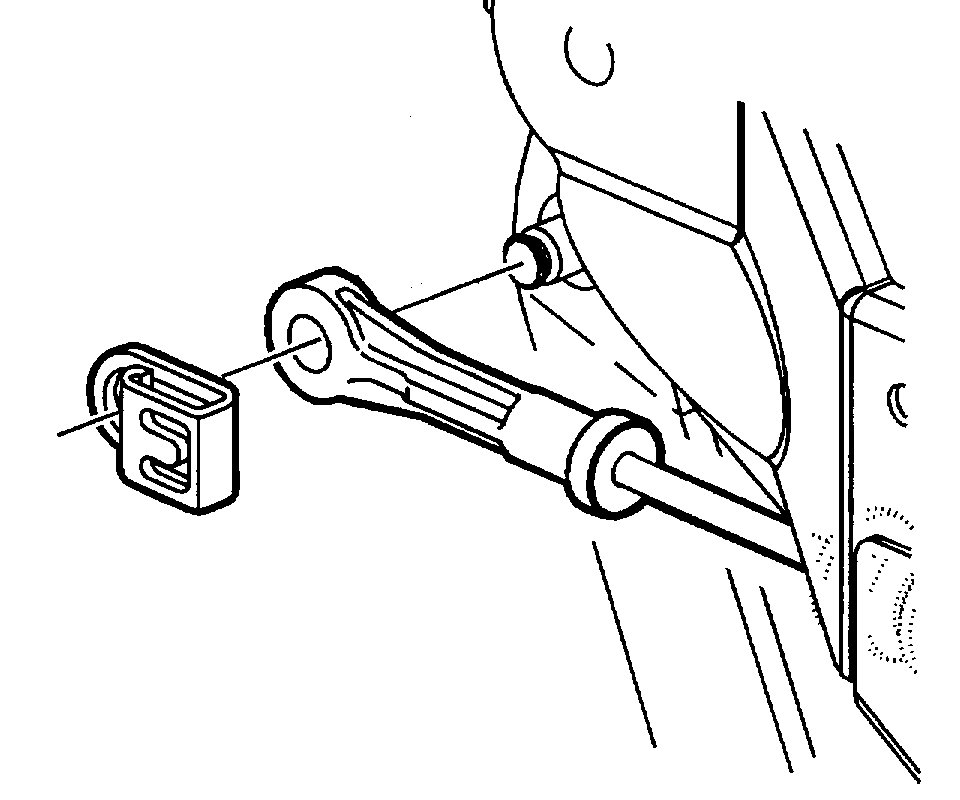

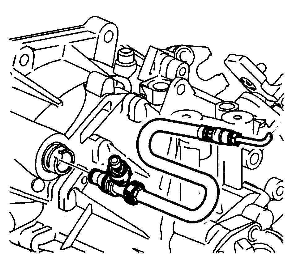

pic 4
1. Clean the clutch fluid reservoir cap and area around the cap.
2. Remove the clutch fluid reservoir cap and remove enough brake fluid to clear a passage to the clutch master cylinder.
3. Remove the clutch pedal retainer.
4. Remove the clutch master cylinder pushrod from the clutch pedal assembly, 1st design.
pic 5
5. Remove the clutch master cylinder pushrod from the clutch pedal assembly, 2nd design.

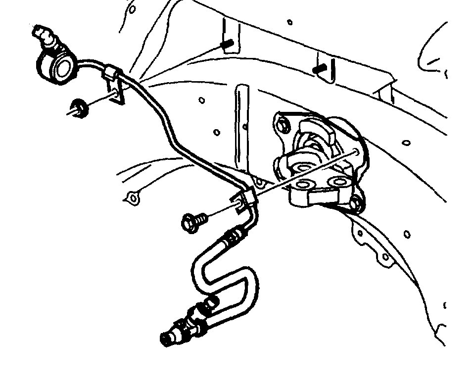

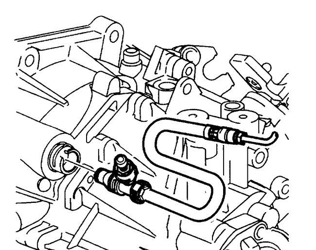

pic 6
Notice: Refer to Brake Fluid Effects on Paint and Electrical Components Notice in Cautions and Notices.
6. Place a shop towel under the clutch master cylinder in order to catch any fluid loss.
7. Using a pick tool on the strut tower side, disconnect the clutch line from clutch master cylinder.
8. Cap the reservoir and hydraulic lines in order to prevent fluid loss and contamination.

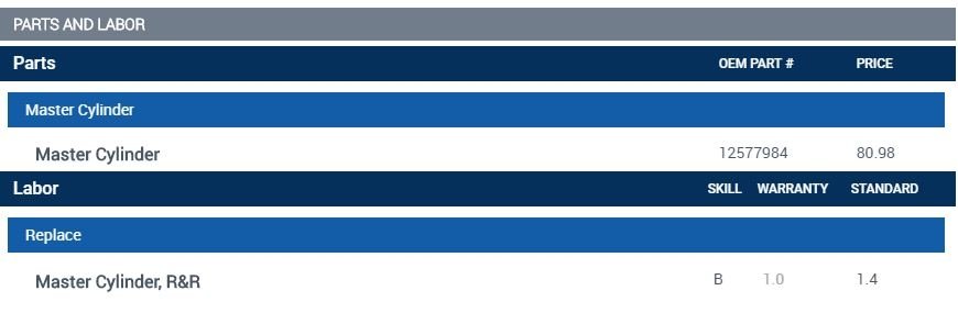

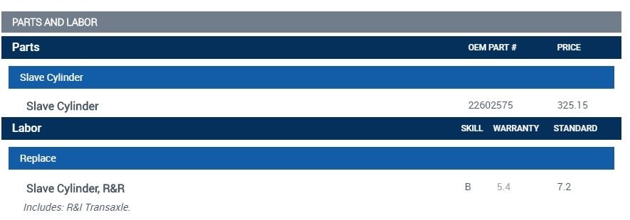

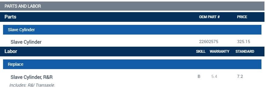

I'm sitting here thinking and it hit me, $1.800.00? Do they charge $200.00 an hour for labor? I have no idea what the labor rates are there, but wow!
Take a look at the picture. It shows the cost of an original equipment part and how many hours labor is given to install it. The part is over $300.00 and it calls for 7.2 hours labor. That means they are charging around $200.00 an hour. Is that correct? If it is, maybe I should move. LOL And yes, I am sure an aftermarket slave can be purchased for cheaper.
Don't allow yourself to get upset. There are always options, and at this point I think you should get a second opinion. I have no idea how they are testing the car, and now I have no idea if the master cylinder has or hasn't dropped. If it has, then I would suspect a leak at some point or a bad slave. If the master cylinder leaked, you would be able to see it.

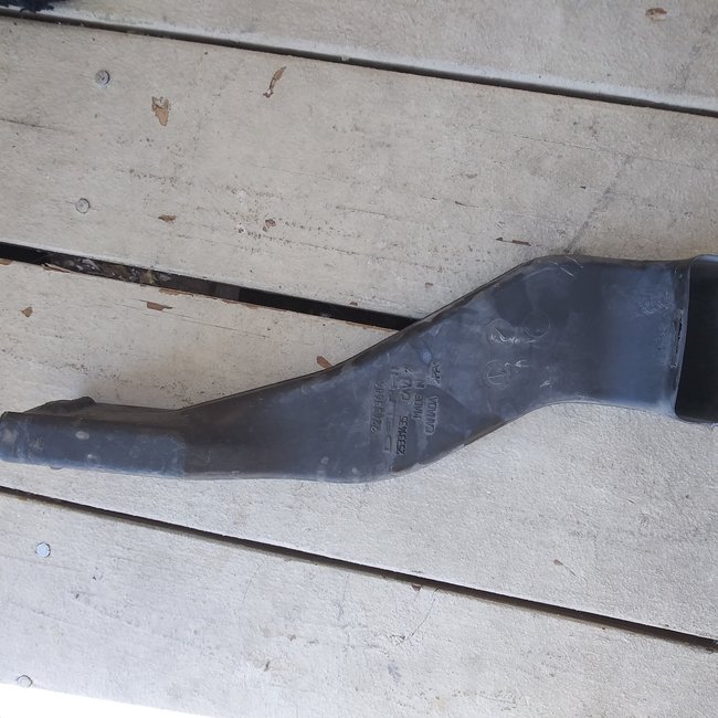

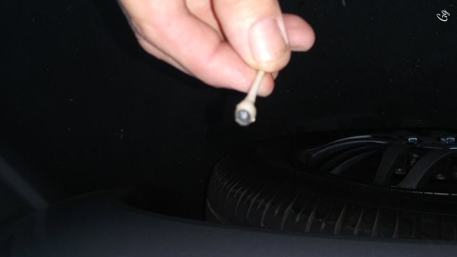

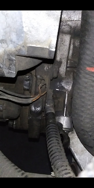

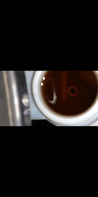

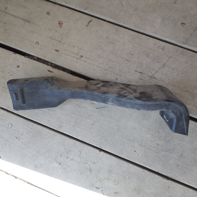

Ken, it is Gabrielle we are doing the oil change the guy found this part he said "floating" in the engine area, not attached. I took a picture of it. I have no idea what it belongs to, do you? Intake duct for?
Jun 3, 2019 at 4:39 PM
Welcome back,
There is absolutely no need to send anything. We are here to help you. (and I realize in this day and age, that seems odd) LOL. I actually spoke with Ken earlier regarding you and this issue. We both agree it sounds like the third gear synchronizer is going bad. It makes sense that the clutch is working fine, otherwise it would make noise when shifting into any gear.
Now, for the picture you attached. It was found in the engine compartment? Is it plastic and hollow? It's hard to tell for sure, but it appears to the the fresh air inlet tube that would attach to the air filter box under the hood.
Check the air filter box to see if something is missing where fresh air enters the box and let me know.

Hi there again. I took my car back to them this morning in the mechanic on duty there couldn't figure out how to attach that piece. l was asked to come back tomorrow so the mechanic that worked on my car can attach it.
The piece (air duct) attaches to the battery compartment and extends somewhere between the radiator and the headlight assembly. I do not know. Do you?

Jul 18, 2019 at 11:07 AM
GABBYGILBO
  • 55 POSTS
Joe in addition I attached pic of my clutch reservoir. The white line in dirt is where I took Q-tip across bottom.
Jul 18, 2019 at 6:10 PM
