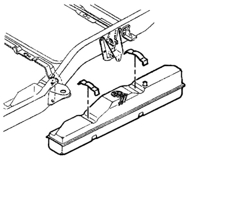

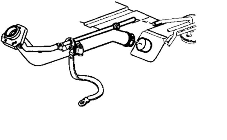

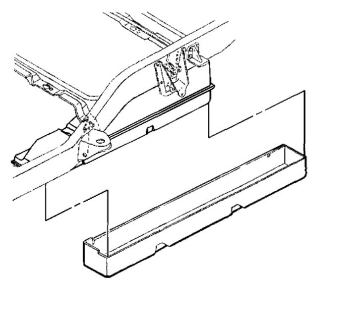

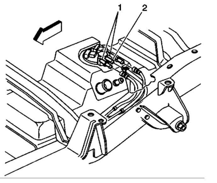

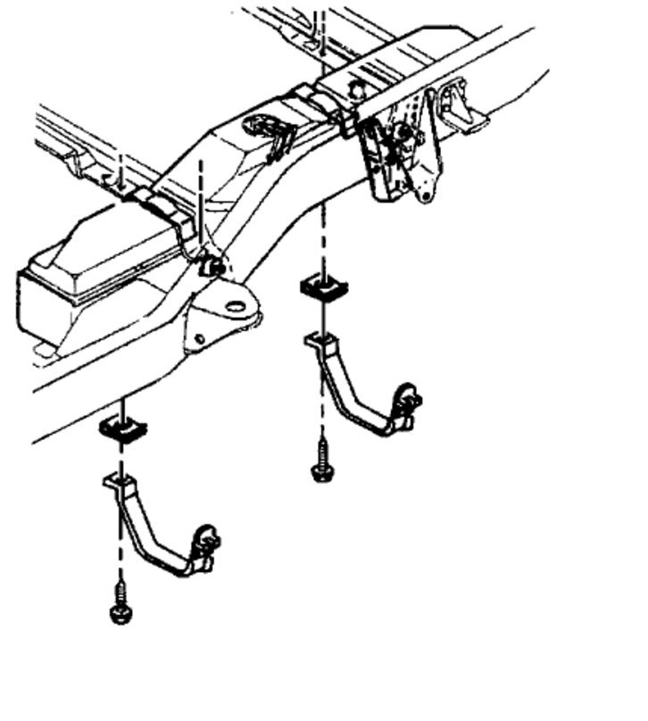

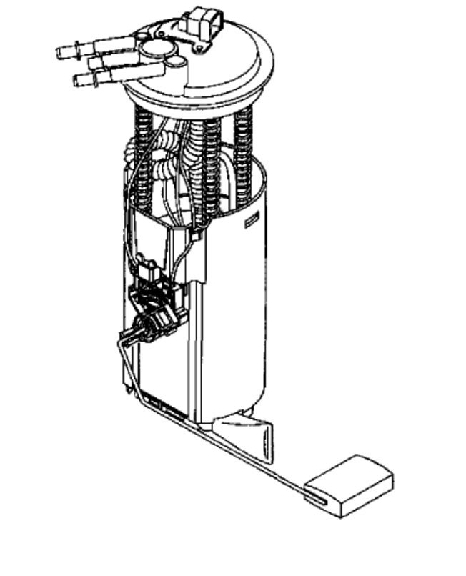

Yes, the pump is bad. You can get a new one from Amazon for about $120.00 Ac Delco. Here are guides to help you see what you are in for when changing the pump out with diagrams to show you how it will be on your car:
Apr 8, 2009 at 9:07 PM
JUATA
  • 6 POSTS
Well that was a job but I did it. The ruck has never run better. Thanks to all who helped. I love this site.
