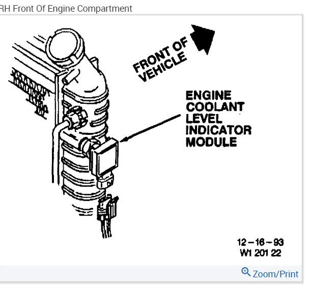

My low coolant light blinks from time to time. I am not low on coolant and the car does not overheat. Please advise of what the problem may be.
May 30, 2008 at 9:10 AM
DNAPRORACING
  • 120 POSTS
There is a sensor is about $38.00 on the side of the radiator that needs to be replaced. Here is a guide to show you how to drain the coolant before you begin:
https://www.2carpros.com/articles/coolant-flush-and-refill-all-cars
Check out the diagrams (below). Please let us know if you need anything else to get the problem fixed.
Cheers

There is a sensor on the side of the radiator that needs to be replaced. Here is a guide to show you how to drain the coolant before you begin:

The level sensor attached to the bottom of the coolant tank is probably faulty and sending false signal.

Have you checked the sensor and its wiring? Should be near the top of the radiator. If you have an ohmmeter, you might check the sensor and replace if resistance is infinite.

low coolant sensor has failed and needs replaced.
Jul 23, 2018 at 2:08 PM (Merged)
NICKHEADZ34
  • 62 POSTS
coolant sensor is bad. its on the side of the radiator. I just disconnected mine. It is like a $35.00 sensor at Napa for an over the counter price.

i work at napa. and the echlin part number is FLS 614. good luck.

Try checking the harness the plugs into the reservior for a poor connection of corrosion. Also try tapping and the sensor to see if the light reacts. You may have a defective sensor even though it is new.
