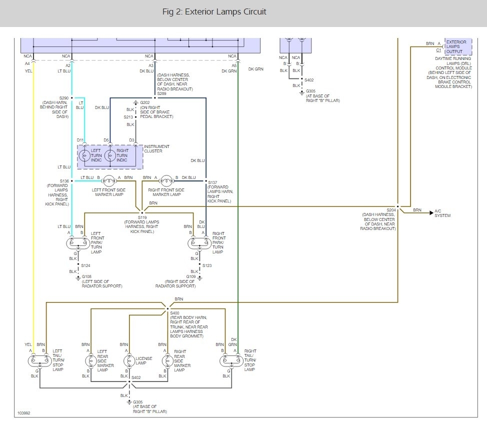

This sounds like you have a turn signal switch that has gone bad. Here is a wiring diagram of the brake lights and a guide so you can do some testing to confirm the failure.
Please run some tests and get back to us we are interested to see what it is.

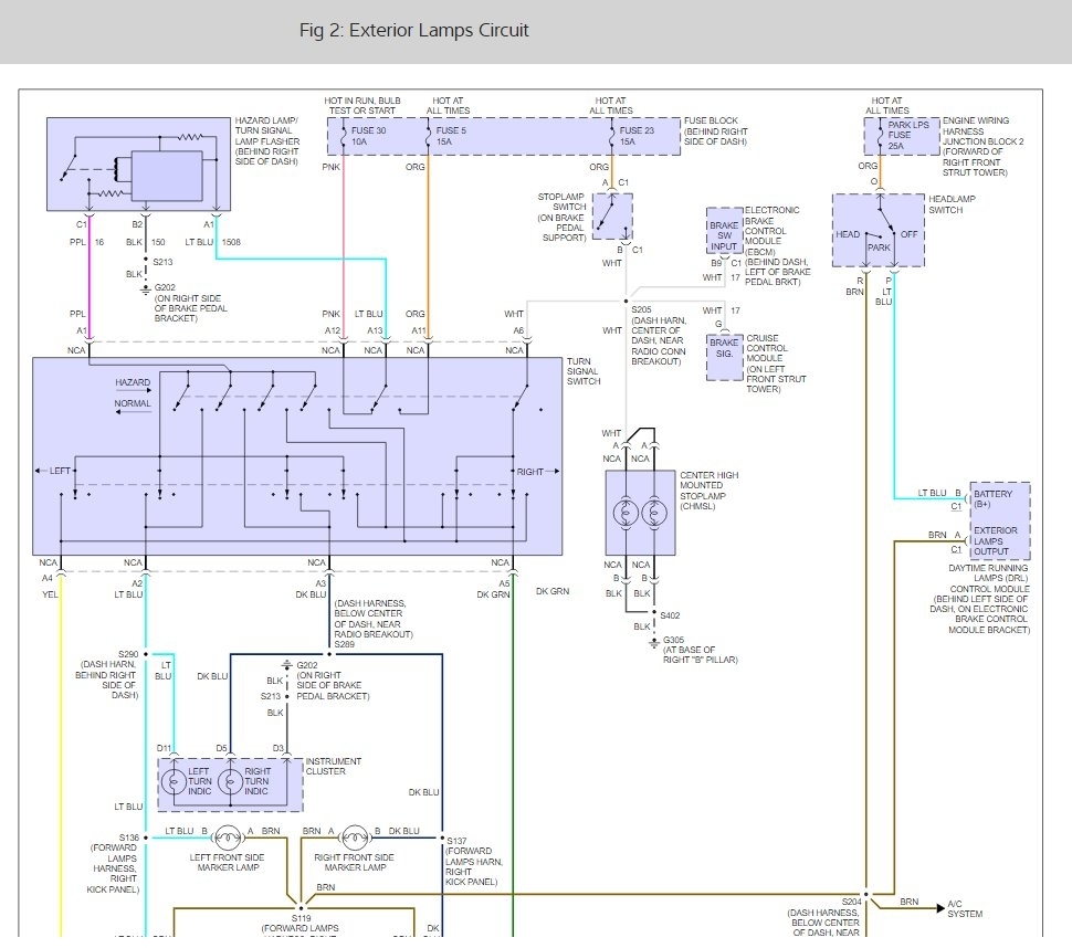

if brake switch, fuses and bulb are all good and high mount brake light works then suspect faulty turn signal (multi function) switch. main brake lights run through turn signal switch, high mount brake light runs through separate circuit on a relay switch.

The power to the turn signals and brake lights comes from the turn signal switch-if it malfunction you won't have the lights.
https://www.2carpros.com/forum/automotive_pictures/12900_brake_5.jpg

Check fuse no.23 15amp in the fuse block behind right side of dash if okay -find the brake switch and check for power on the white and orange wire with a test lite-while brake pedal is depress-both should have power if the white don't have it-replace the brake switch or check adjustment-if the okay test the turn and hazard switch the brake circuit goes thru this switch before it gets to the back-
