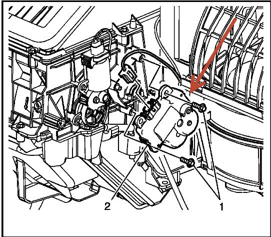

if working ok both hoses should be about the same hard to tell temp without a guage of some sort. pull your hvac fuse for 60 seconds it may reset your actuators . I fboth hoses are hot then your actuators aren't working correctly. It cold be a control head not sending power or the actuators themselves. pictured is rh one it can be replaced by dropping glove box door and letting box come all the way out.
