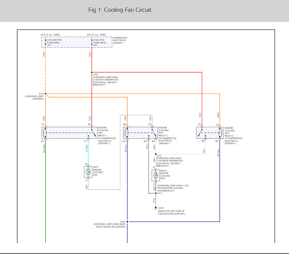

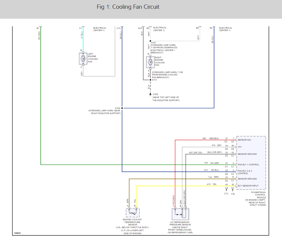

The coolant temp sensor mounted to the water pump, supplies a supposedly accurate temperature to the PCM. The signal from the coolant temperature sensor, aka: "thermistor", varies it's resistance with the change of temperature measured in the coolant stream and signals the PCM. The PCM supplies a signal of aprox. 5 volts to the coolant temp sensor and a feed back signal is returned through a resister in the PCM circuitry which in turn measures the voltage.....when correct, it is interpreted as high voltage when engine is cold and low voltage when engine is hot*.
