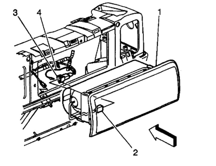

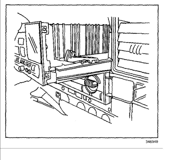

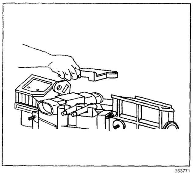

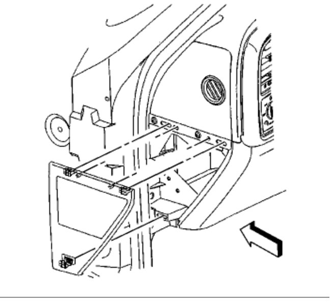

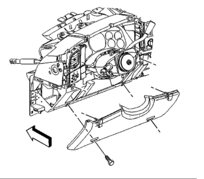

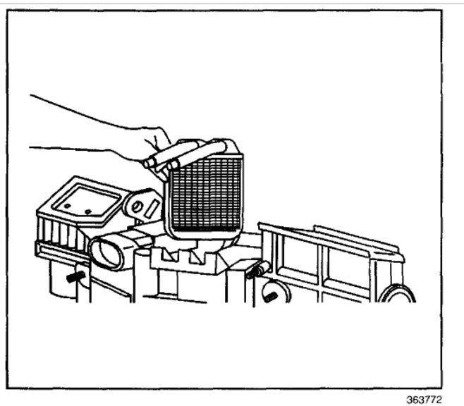

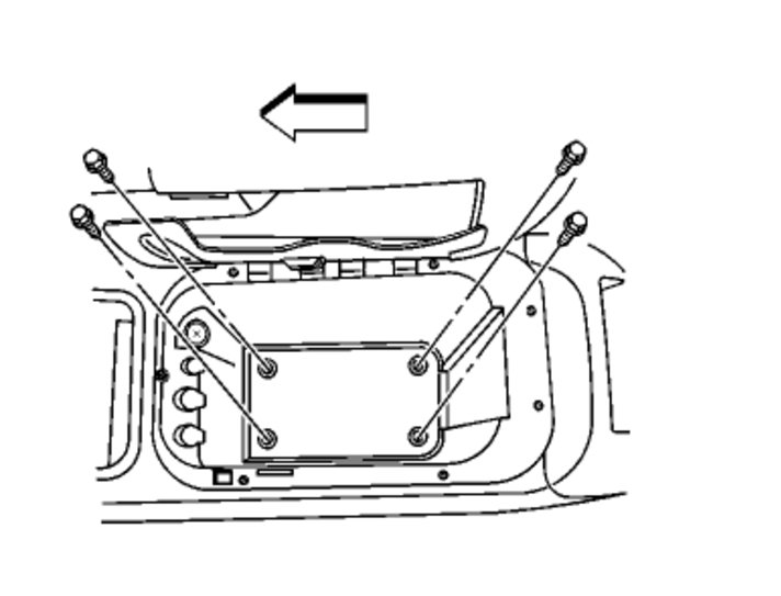

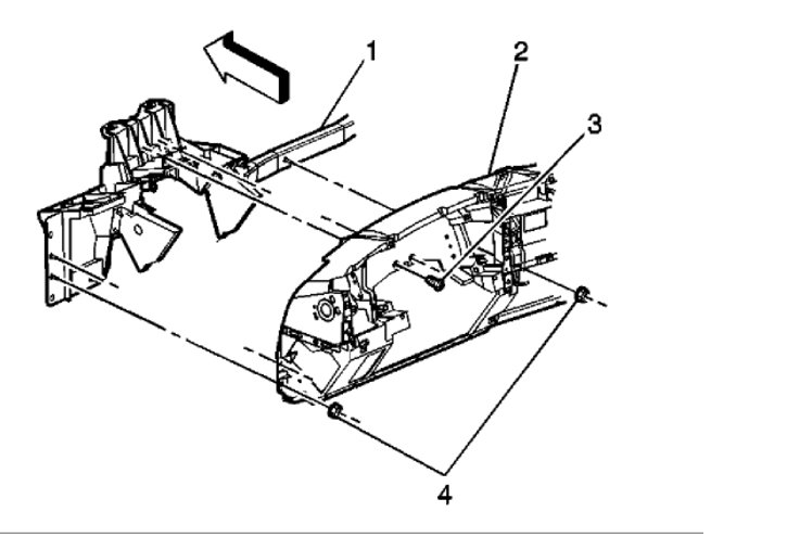

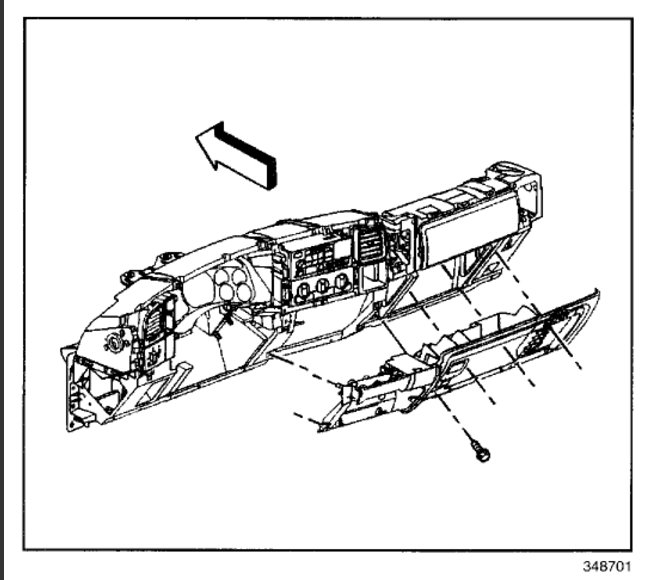

MICAMIL
Heater problem
2001 Chevy Blazer V8 Four Wheel Drive Automatic
have the dashboard out put there is a mounting unit around the heater core that I can not get off.
Aug 19, 2020 at 8:11 PM (Merged)

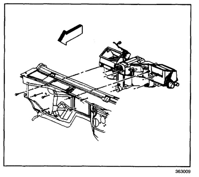

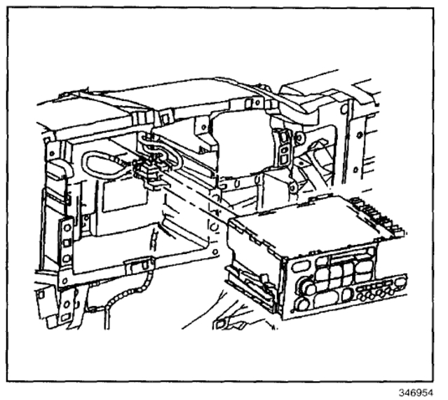

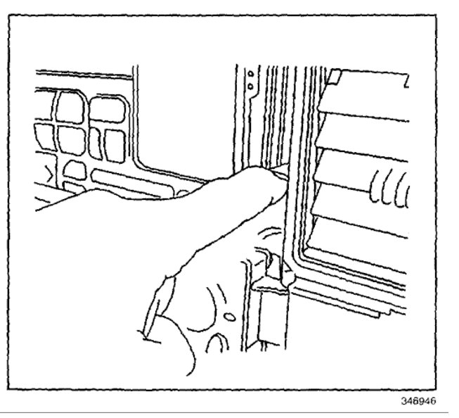

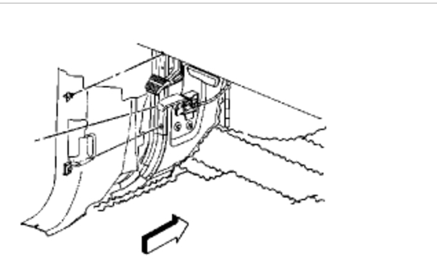

BLUELIGHTNIN6
  • 16,542 POSTS
https://www.2carpros.com/forum/automotive_pictures/261618_Noname_1582.jpg
https://www.2carpros.com/forum/automotive_pictures/261618_Noname2_483.jpg
https://www.2carpros.com/forum/automotive_pictures/261618_Noname3_181.jpg
https://www.2carpros.com/forum/automotive_pictures/261618_Noname4_90.jpg
