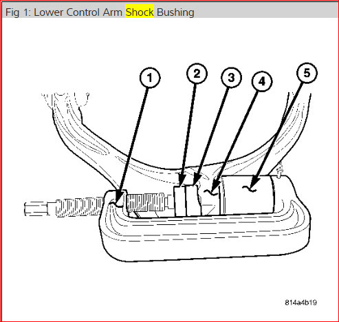

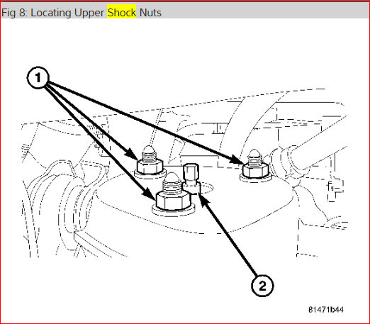

How do I go about changing struts and strut bushing out on lower control arm?
Jul 28, 2018 at 3:39 PM
DANNY L
  • 5,648 POSTS
Hello again.
I have attached a few pictures for you. If you do not have a ball joint/press removal/installation tool you will have to rent one for the lower control arm strut bushing replacement. If you are going to replace the strut cartridges and not the whole complete unit you will have to rent a strut spring compressor tool as well. Hope all this helps and let me know any more questions you have.

What do you have to take apart to be able to get strut assembly out? And would the strut not still have pressure behind it? What do I need to torque bolts to on it?
Jul 29, 2018 at 3:25 PM
DANNY L
  • 5,648 POSTS
Hello again.
If you jack up the truck and put jack stands under the frame let the upper and lower control arms be free (unloaded) the struts will come out after being unbolted with nothing else having to be taken apart. The torque is 50 ft lbs for the upper strut nuts and 150 ft lbs for the lower. Hope this helps. Let me know if you have any other questions and thanks again for using 2CarPros.

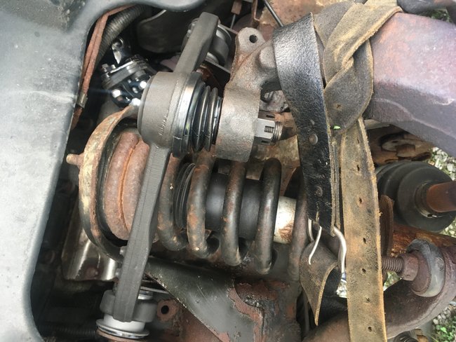

So I do not have to remove any sway bar links or take tie rod out or lower control arms out? Here is a picture:

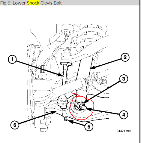

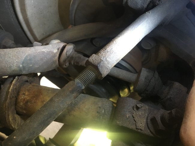

Here is bottom picture of strut bolt.

No, nothing else has to come apart. You do not need an alignment after strut replacement. After unbolting you will be able to remove by just tilting sideways and bringing out towards you. Hope this helps.
