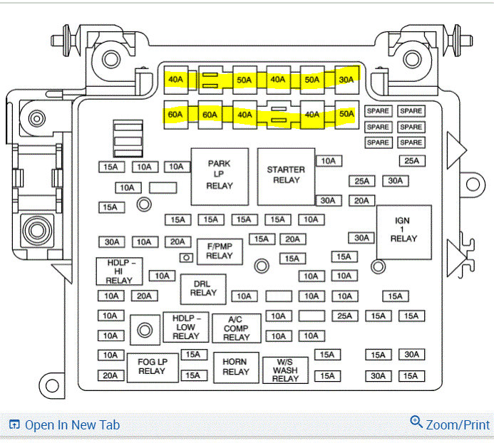

If I understand, nothing is working now. Do things like the headlamps, horn, radio, or anything at all work? Although the battery is fully charged, are the terminals clean and tight? Take a look through this link:
Next, I attached a picture of the under hood fuse box. I want you to check what are called the mega fuses. These are heavy duty fuses the power many of the smaller fuses and accessories.
Here are a few links to help when checking the fuses. Do me a favor. In addition to just checking the condition of the fuse, confirm there is power to it.

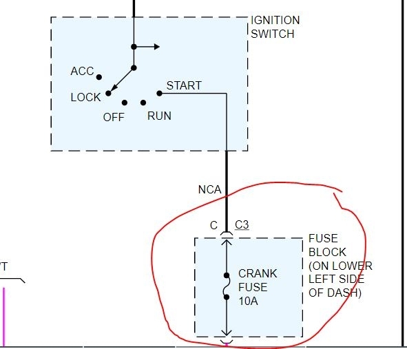

Check IGN C fuse 20amp and crank fuse 10amp and Ign fuse A 40amp if okay Probable causes here could be the park and neutral position switch/ starter relay and ignition switch.

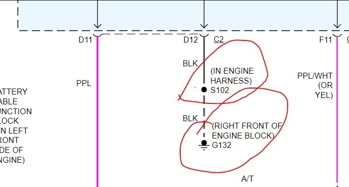

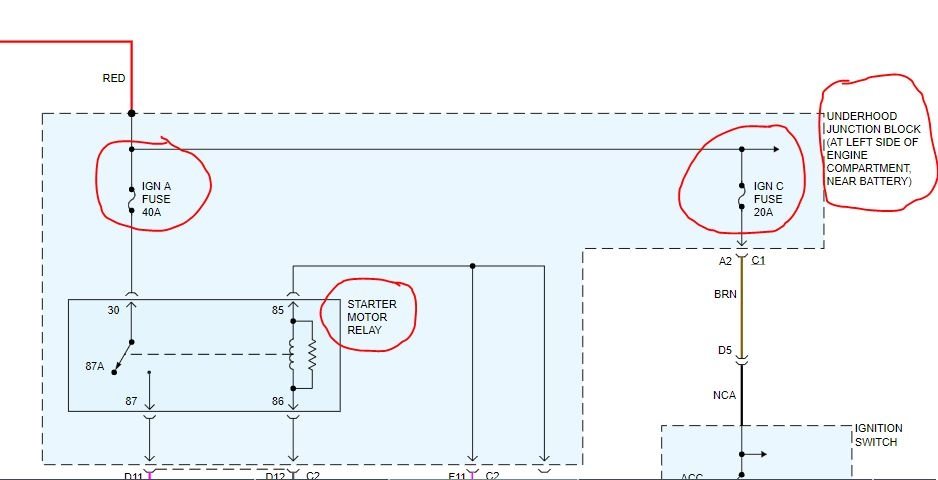

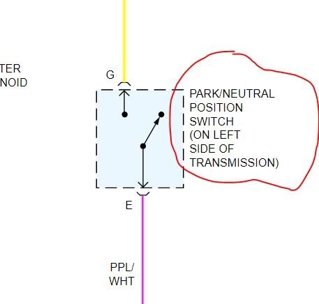

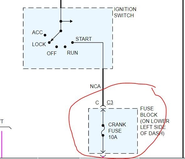

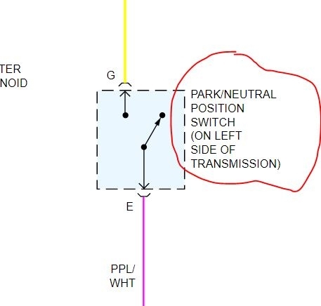

Welcome back:
Okay if it happened before switch replacement and before the starter replacement, the old starter may have blown a fuse, you may have lost ground, or the neutral/park switch may have failed.
First, the first two pics below show fuses that need checked as well as the starter relay. Check those first.
Second, pic 3 shows the neutral/park switch. See if the engine starts in neutral or any other gear.
Third, pic 4 shows the ground for the starter relay. You need to confirm both the ground and the splice (both circled) are good and there is a ground path for the starter relay.

May 19, 2021 at 3:08 PM (Merged)
TIFFANY LEE
  • 4 POSTS
It started doing it after I change the starter but before I did the ignition. so I changed the ignition thinking that was what it was. but I'm going to go ahead and check out and do whatever you said to do and I will get back to you.
Welcome back:
Did the old starter do the same thing? Let me know. Also, let me know the results of the tests I attached in the prior post.
