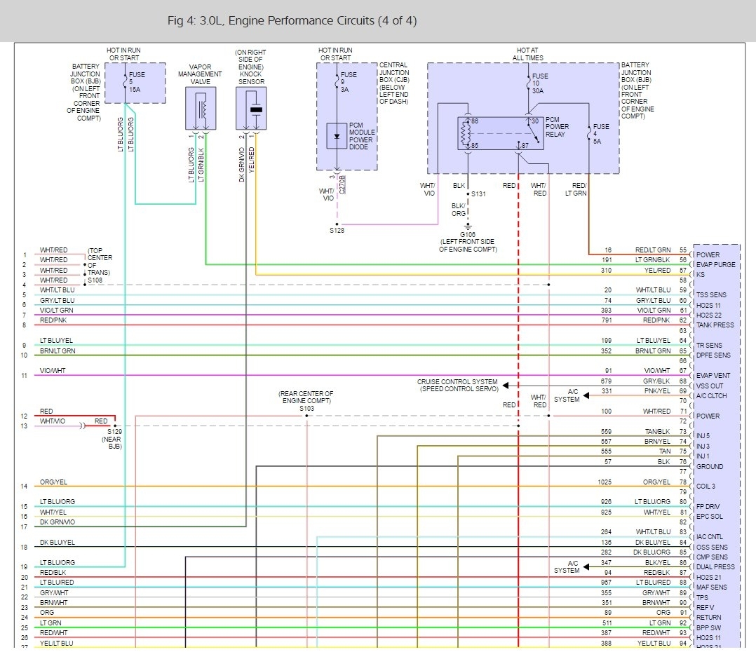

Started having to get car jumped off if it was off overnight, then kept getting worse. Shut off while I was driving down the road, steering column locked up, lights fading in and out. Would not jump off at all. Tried to replace battery, hooked up backwards, did not try to crank like this but went to turn power on and nothing happened so I turned off and realized this, hooked battery up correctly. Replaced main fuse, cause it got blown, then was getting power flow again. Got brand new battery. Turns over but will not crank. I can hear the fuel pump coming on when turned key for power. Replaced crankshaft sensor but still same results. I think it might be PCM?
Aug 19, 2020 at 7:51 PM (Merged)
This sounds like a fuse or a PCM power relay that has shorted out, here is a guide o help you get the fuses checked and a wiring diagram to show you the wires going to the relay which is in the PDC (fuse box) under the hood.
Please run some tests and get back to us so we can continue helping you.
Best, Ken
