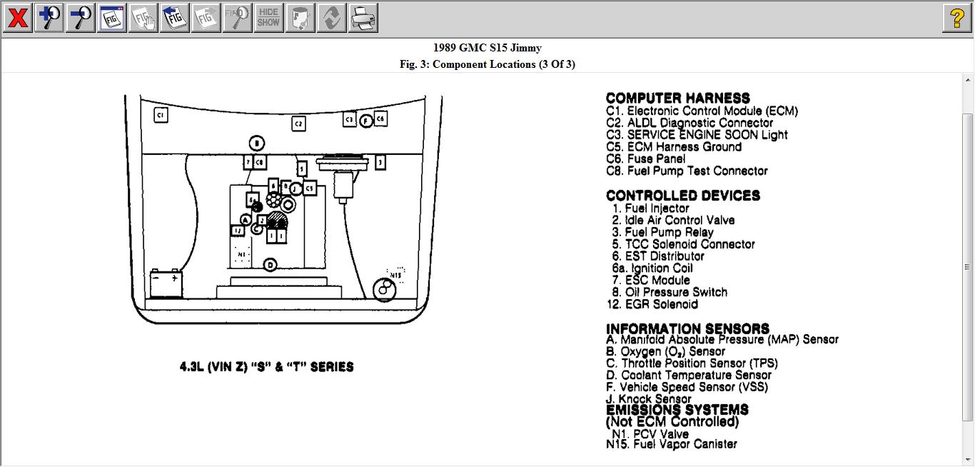

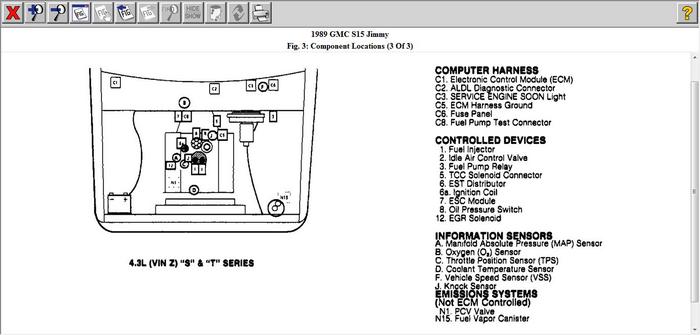

Coolant Temp Sensor?? Are you refering to the one in the intake manifold or the on in the block??
Aug 16, 2019 at 12:37 PM (Merged)
RASMATAZ
  • 75,992 POSTS
Its on top front of engine -see below
