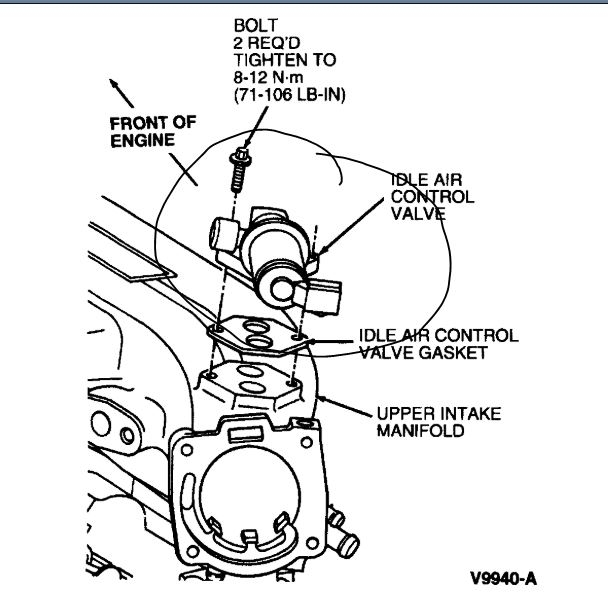

There is an idle ir control on top of the motor that was a very common failure for this exact issue. I attached pictures and procedure for you to view. It is a very easy repair.
Procedure.
REMOVAL
1. Disconnect battery ground cable.
NOTE: When the battery has been disconnected or reconnected, some abnormal drive symptoms may occur while the Powertrain Control Module (PCM) relearns its adaptive strategy. The vehicle may need to be driven 16 km (10 miles) or more to relearn the strategy.
2. Disconnect the engine control sensor wiring from the Idle Air Control (IAC) valve at the IAC valve electrical connector.
3. Remove the two IAC valve retaining bolts.
4. Remove the IAC valve and gasket.
INSTALLATION
1. Clean IAC valve gasket mating surfaces.
NOTE: If scraping is necessary, be careful not to damage IAC valve gasket surface or drop material into intake manifold or throttle body (depending upon application).
2. Follow removal procedure in reverse order.
3. Tighten the IAC valve retaining bolts to 8-12 Nm (71-106 lb-in).

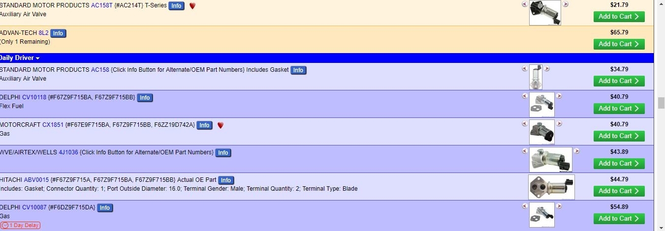

Yes, you need to replace the idle air control valve. You can get it at any parts store or go to rockauto.com and they have it as well.
Jul 25, 2019 at 9:22 AM
HAP
  • 37 POSTS
Where are you? I'm in Alberta, Canada here so AutoValue should have it.
Jul 25, 2019 at 9:24 AM
I am in Pa. on the east coast.
Rock auto attached.
Jul 25, 2019 at 9:30 AM

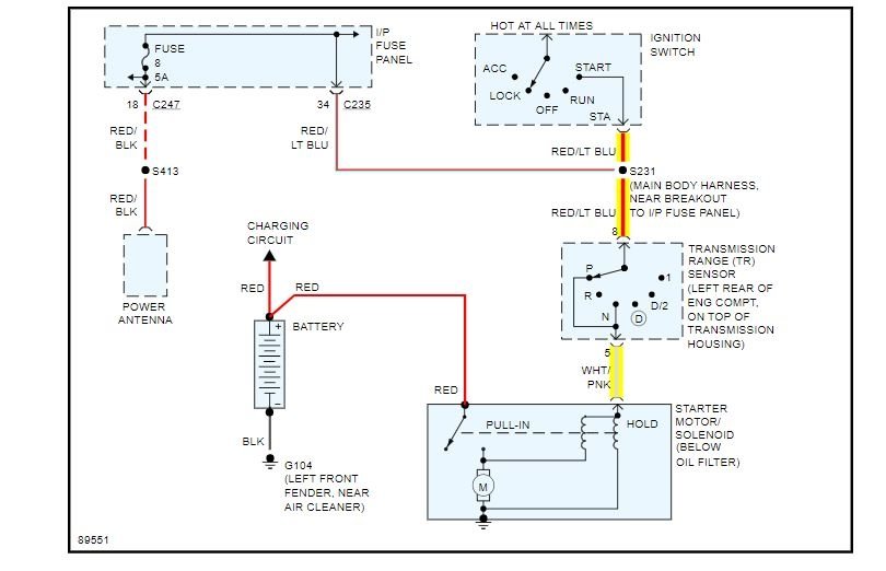

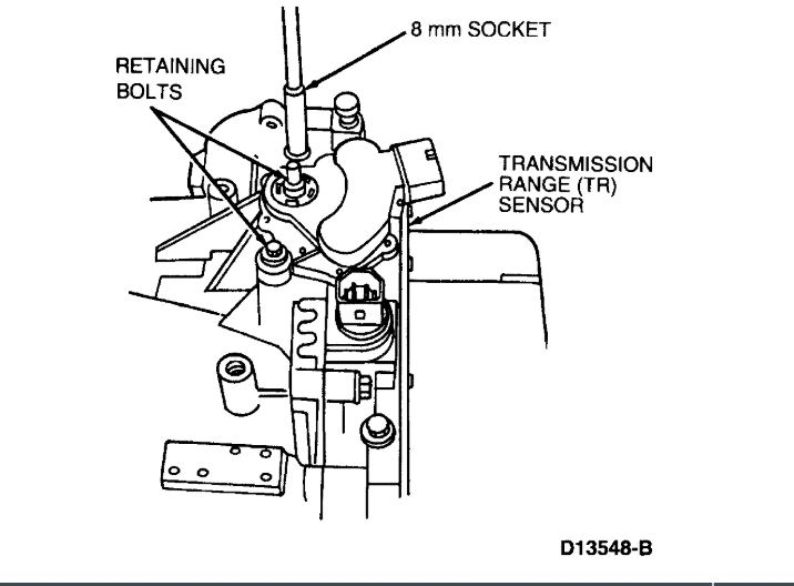

It could be the neutral safety switch. That is what you are moving by changing the shifter location. The PCM needs to see park or neutral before allowing the relay to pass current to the starter.

It is on top of the transmission.
It may be better if you had someone check it for you.

If started in neutral so I put it in park and then I went to roll up the windows, Then I realized I had no power at all. I even had locked the doors manually. What do you think that is ?
Aug 12, 2019 at 6:11 PM
HAP
  • 37 POSTS
I opened the hood, tried to move both battery cables even just a little bit. I couldn’t feel any movement from either of them, but all of a sudden I heard a beep beep beep to indicate that the key was in the ignition. So I quickly rolled up the windows, And there it sits
Aug 12, 2019 at 7:37 PM
You need to clean the battery cables. Follow the guide I posted below.
