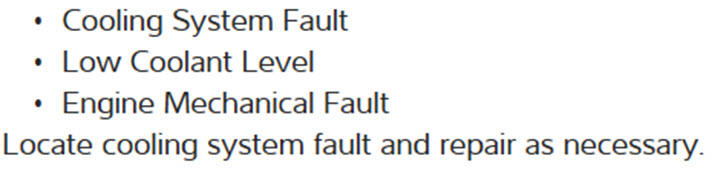

This code indicates that the engine cylinder head temperature sensor indicates the truck is overheating and going into a fail safe strategy. IBelow is a list and description of the trouble code. You need to first check the coolant level, if it is low then look for a external leak somewhere.you said that is seemed to leak where the thermostat is. In the center behind the alternator. Follow the upper radiator hose. I would pressure test the coolant system to find if you have more leaks than that one location.
Detailed Description
Indicates an engine overheat condition was detected by the cylinder head temperature (CHT) sensor. An FMEM Strategy called Fail-safe Cooling was activated to cool the engine.
Possible causes :-
Engine cooling system concerns.
Low engine coolant level.
Base engine concerns.

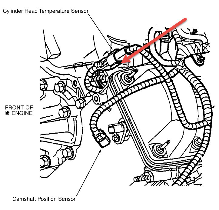

HMAC300
  • 48,601 POSTS
this can be a couple of things, see pics, one can be the cht sensor and or ect sensor or a short plus what is shown in 1 pic.
