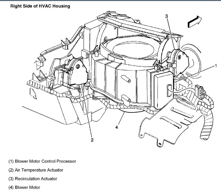

It sounds like you are having a problem with the blend door/re-circulation actuator.It is mounted to the HVAC unit under the dashboard.It's an electrical motor that opens/closes doors to move air throughout the ducts. Here is a tutorial showing what is involved in it's replacement:
I've attached a picture below of its description.Hope this helps and thanks for using 2CarPros.
Danny-
Danny-
