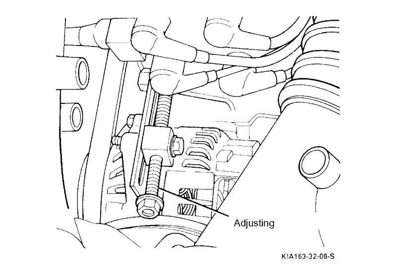

Can you please send me a diagram of how to tighten power steering belt on the Kia ? No place for adjusting. thanks
Jul 1, 2019 at 10:22 AM
ADJUSTMENT
1. Loosen lock nut.
2. Rotate power steering pump as required to obtain proper tension of drive belt.
3. Tighten lock bolt.
Tighten lock bolt to 30 ft. lbs. (40 Nm).
