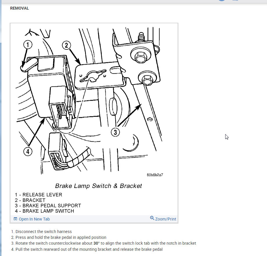

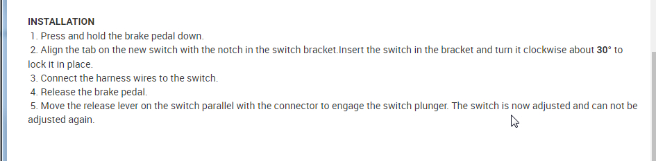

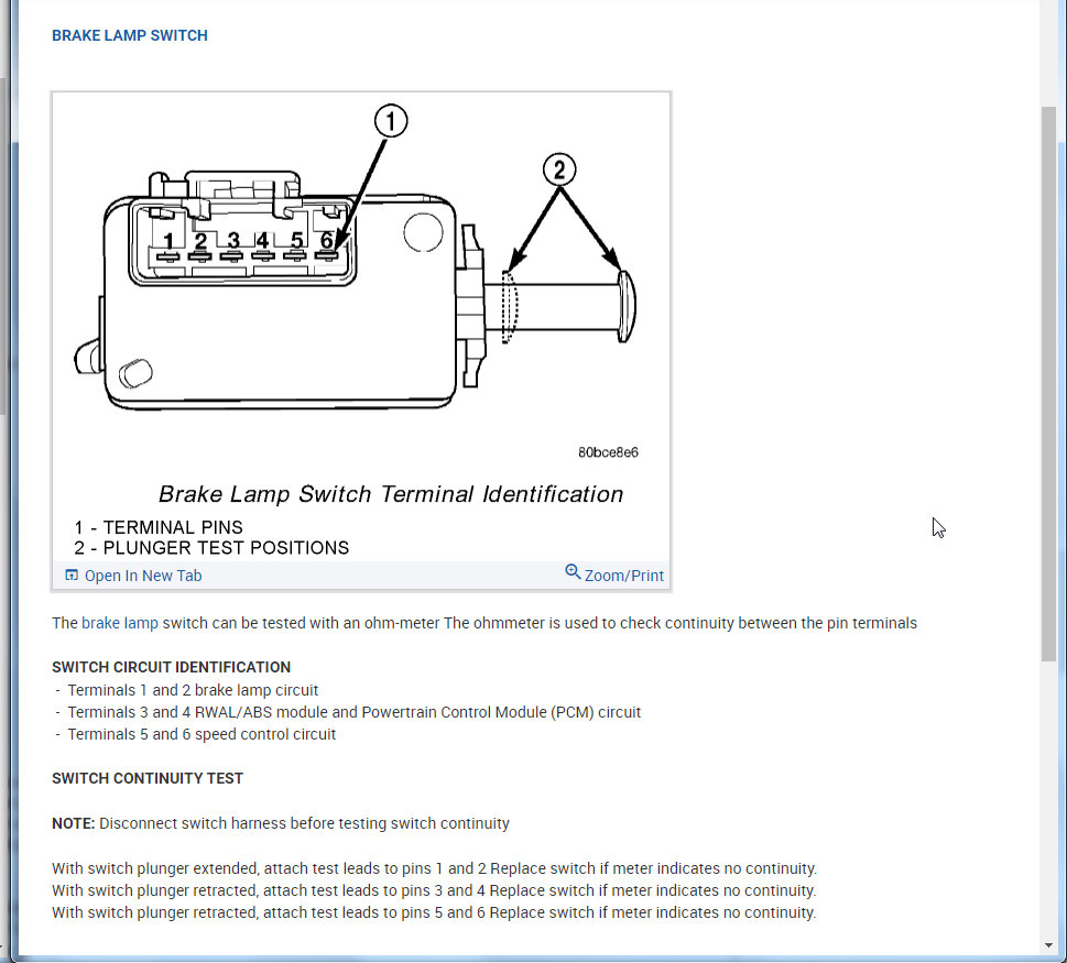

If all the brake lights are out then yes, the switch is most likely the issue.
I attached below the process on how to test the switch and how to replace it as I am sure this is going to be your issue.
Here is a video on a different vehicle but they are all pretty similar so it should give a good idea on how to get it replaced:
https://www.youtube.com/watch?v=RBCDVfzNQGk
Please let us know what you find with this. Thanks

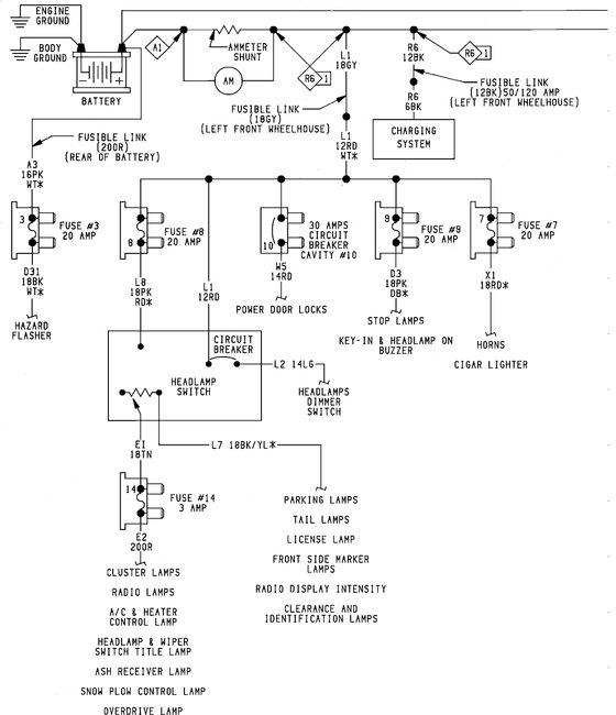

When i turn my head lights on my brake lights will not work. When i turn the head lights off they work. Now all of a sudden the drivers side tail light wont even come on. I have replaced the bulbs, both circuit boards on the tail lights also checked all the fuses. I cannot seem to find the problem.

Your first two sentences are the classic symptom of a broken ground wire. Start with a visual inspection of those wires. If we need to go further, do you know how to use a digital voltmeter?
Mar 17, 2021 at 6:22 PM (Merged)
STEVE W.
  • 15,113 POSTS

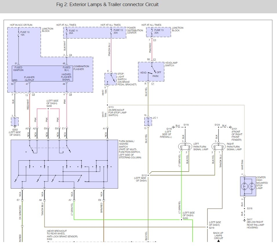

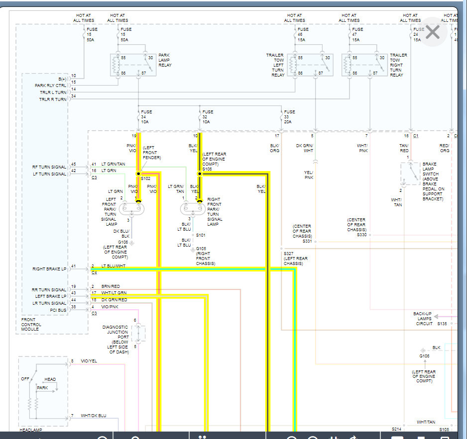

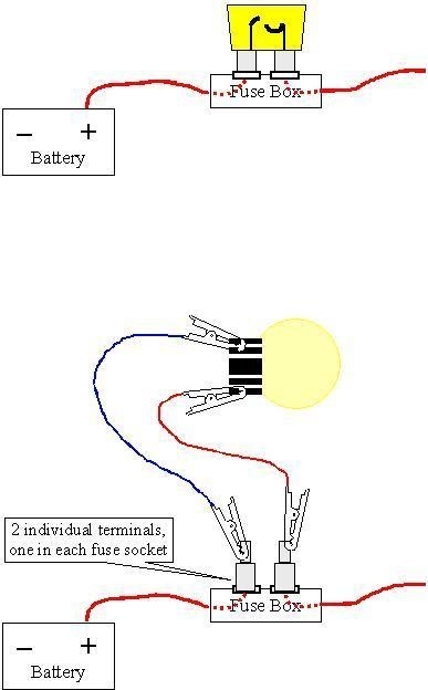

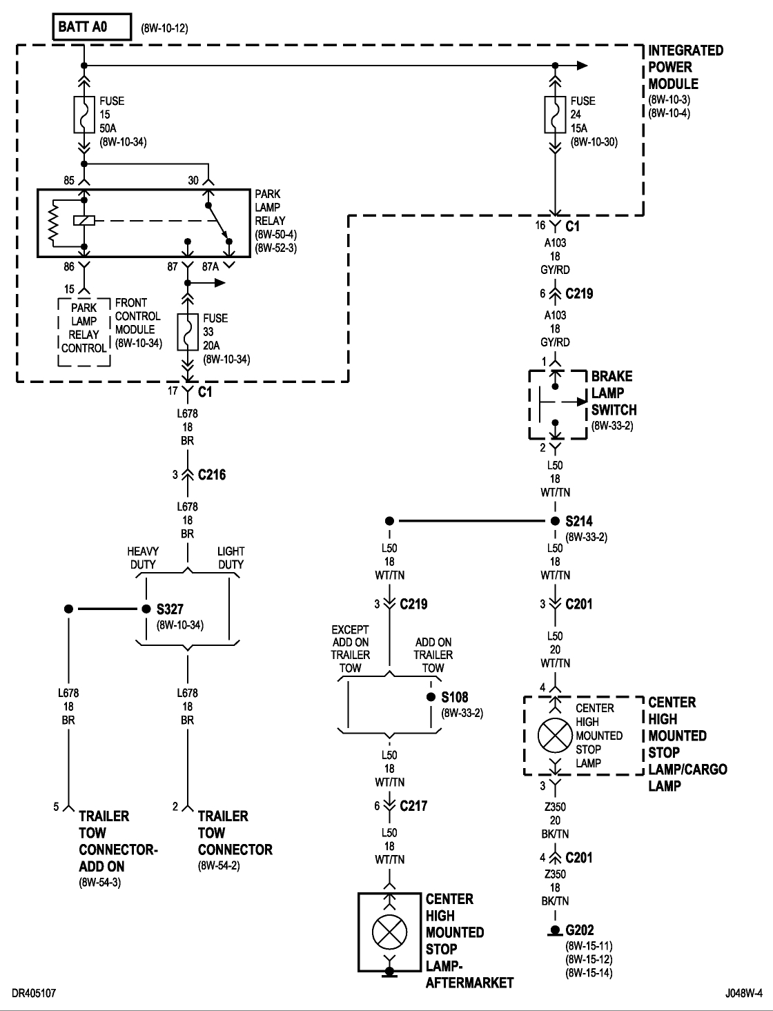

First thing to check is if you are getting power to the rear tail light. Pull it open and with the lights on check for power at pin one (white/yellow stripe wire) in the connector. If you have power check the connector inside to see if the actual connector is loose on the pin on the circuit board.
Since all of those lights share a ground it is likely to be a power feed issue. from the park lamp relay. If it is turning on (should be if all the other park/tail lights work) then it is in the wiring to the left tail light, either the pin is loose or the wire is bad.
Now for the brake lights, the only common items between the headlights and the brake lights (if nobody has played with the wiring) are the forward control module and the IPM.
To see if it may be the problem, check at the brake light switch for power on one terminal and not the other. Then turn on the lights. if the power goes away now it is the IPM or forward control module,
Below are the wiring schematics to give you the wire colors to test.

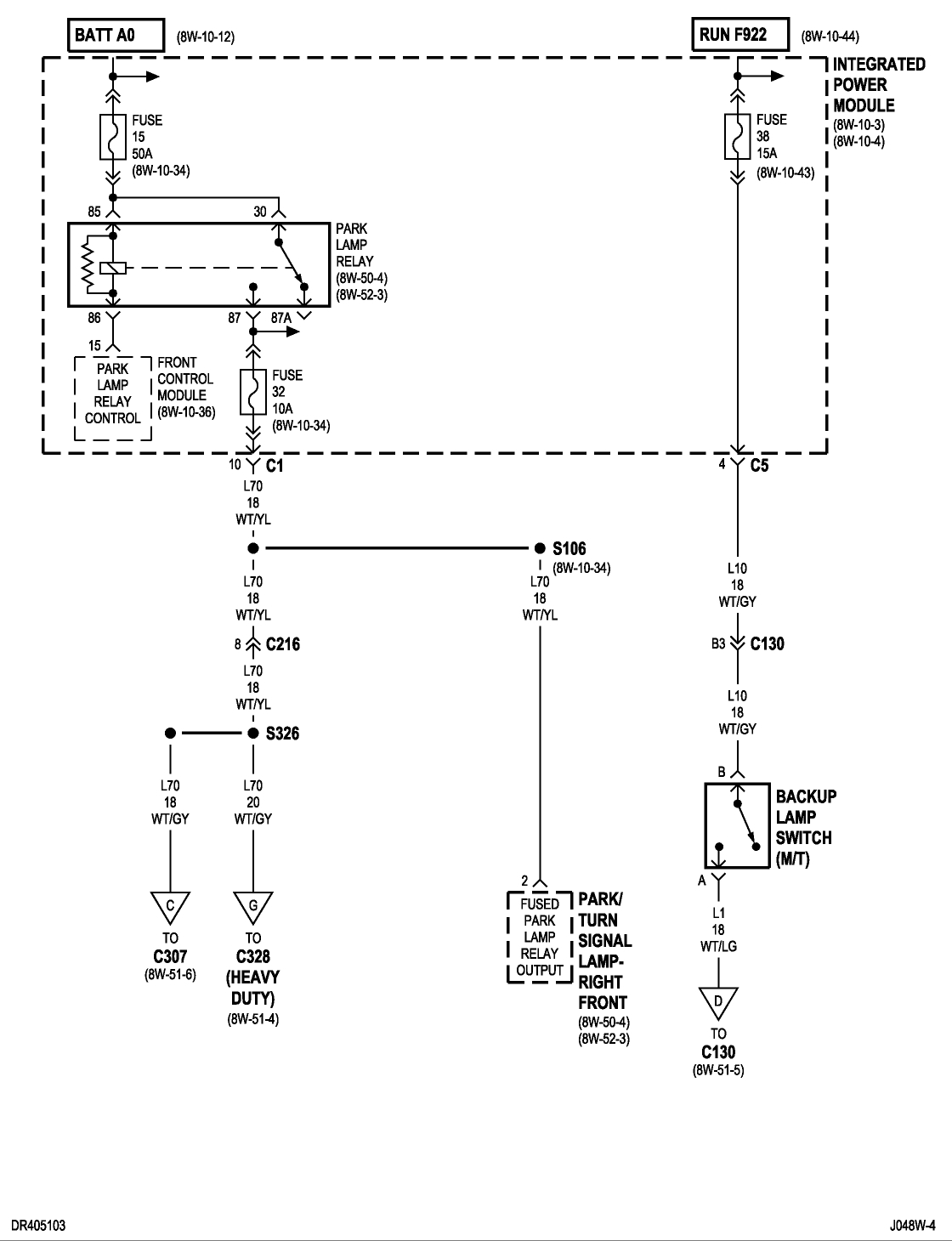

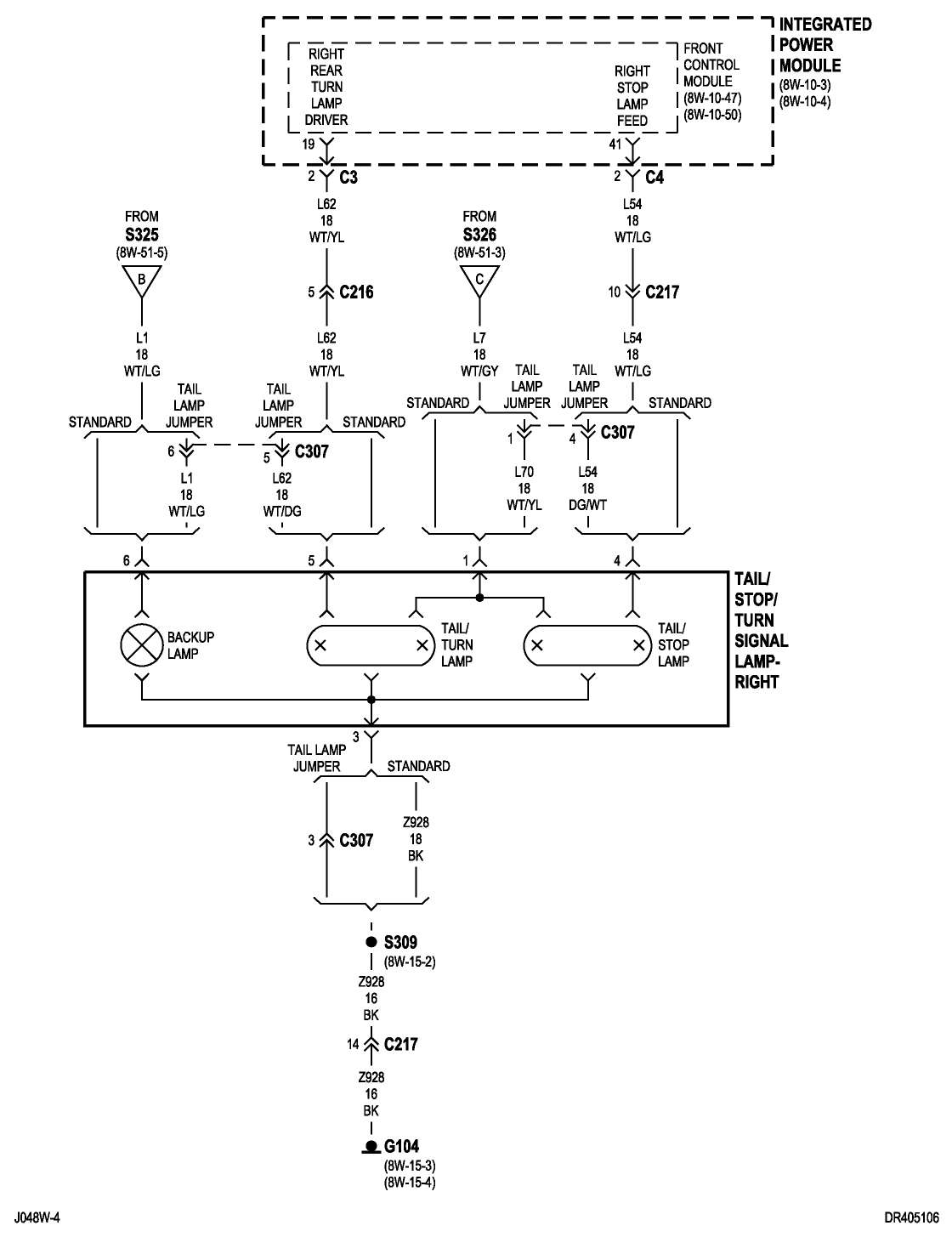

I am not sure which fuses you are checking because the brake lights are controlled through the front control module. However, they are powered through a lighting fuse but so are the parking lights so if the brake lights/tail lights are the only thing not working then the fuse is okay. So let's check the front parking lights as well. If they are not working then you have an issue with the relay.
So, if you are not getting power to the fuse then the relay that is feeding these fuses is not okay.
Here is a guide that will help with testing the park lamp relay:
Below is the wiring diagrams that you will need to do this. Please run through this material and let me know what you find. Thanks

Does the high-mount brake lite work? If not check voltage to and from the brake switch. Brake switch should be activated by brake pedal arm. Pink wire is hot all the time. White wire goes hot when brake switch is activated.

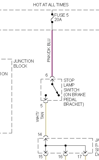

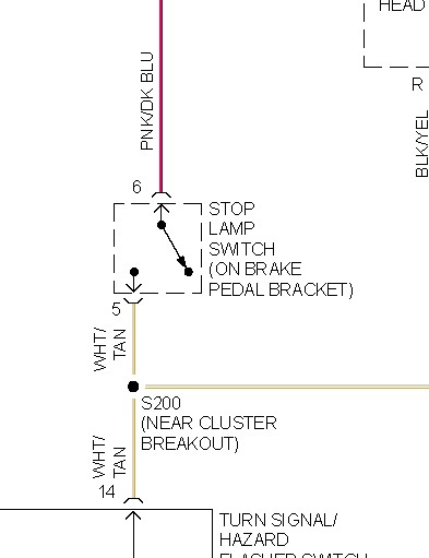

That is ignition feed, pink wire/dark blue tracer, to the brake switch, goes hot when you turn on the key, there is also a fuse, this info says fuse c 20 amp. If there is a junction where that feed comes from, other than the ignition switch.
Here are a couple of guides and diagrams (below) that will help you get the problem fixed.
and
Please run some tests and get back to us we are interested to see what it is.

Thanks but I need the internals of the switch and before the switch so I can check the power in and jump the switch as a test. Also, am I viewing the pictures the wrong way?
This is exactly what I'm looking for.

Hello again, after my morning coffee, I think the brake lights should work, even with the key off. I looked at a couple of databases on the diesel. I think that circuit should be hot all the time. The ignition switch shouldn't have anything to do with it.
The wiring diagram me and you both looked at, does show that fuse circuit goes hot, with the key on.

https://www.2carpros.com/forum/automotive_pictures/170934_better_diagram_1.jpg
Is that any better? The diagram I was looking at, I increased the magnification, before I copied, then posted. That fuse is located in the power distribution center.

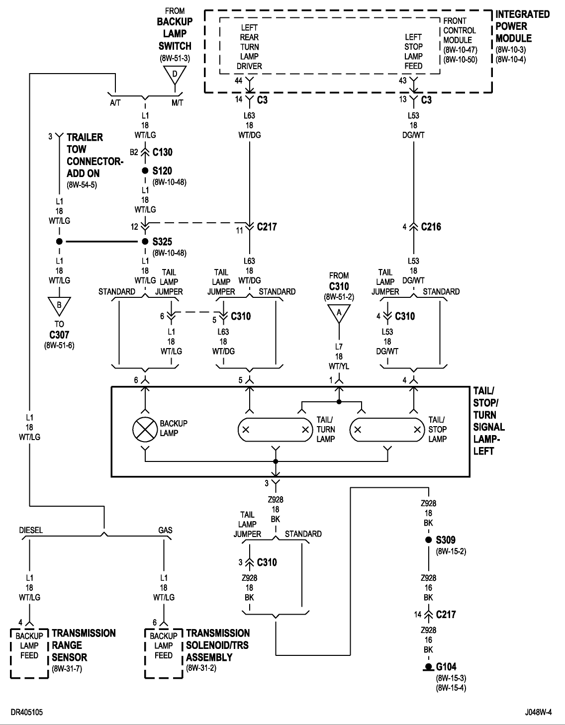

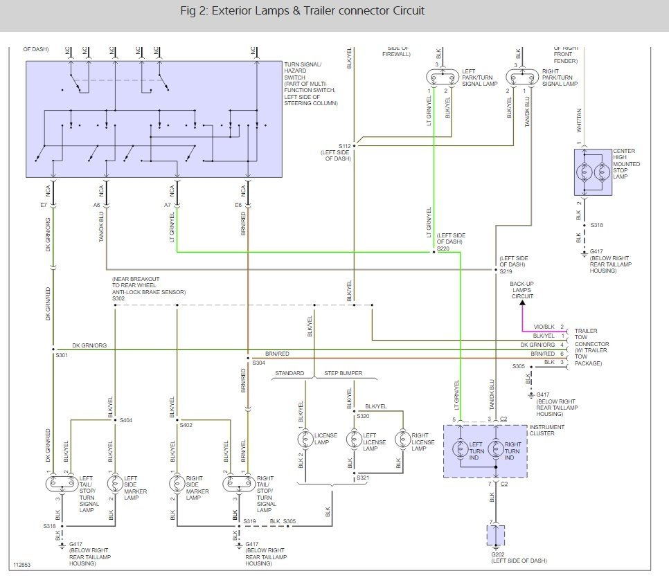

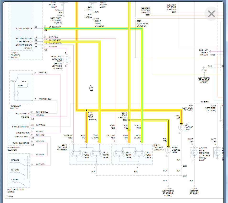

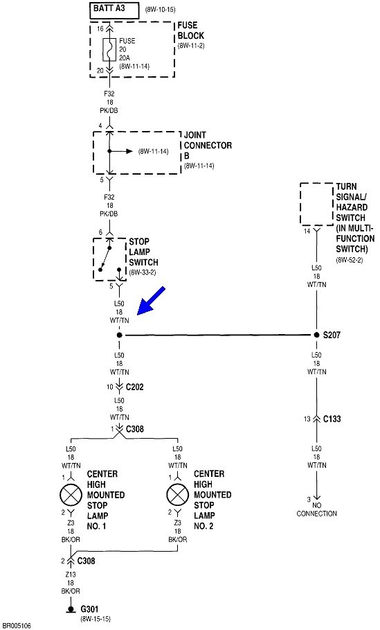

If the fuse doesn't blow until you press the brake pedal, that proves the brake light switch is okay. Even if the switch was shorted, the symptom would be the brake lights stay on all the time. You have something shorted after the brake light switch. That is what we have to find.
Before you do anything else, check if there is a trailer wiring harness added on and if those wires are chewed up.

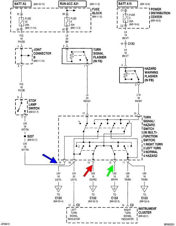

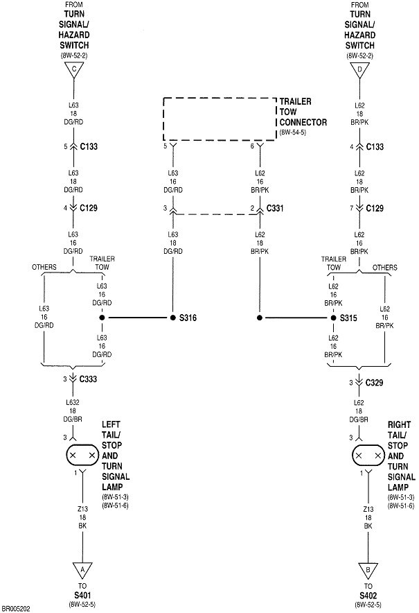

The first thing to do to narrow down which circuit needs to be diagnosed is to observe there are three separate circuits. There's the left rear brake light, the right rear brake light, and the center high-mount brake light. As luck would have it, the two rear brake lights are the same ones used for the turn signals. If either of those circuits are shorted, the turn signal fuse will blow when that side is activated. See if the signals work on both sides or if one side is dead.
Once the shorted circuit is identified, it is too costly an ineffective to keep throwing new fuses at it. Instead, plug in a pair of universal crimp-type spade terminals in place of the blown fuse, then use a pair of small clip leads to connect them to a small 12-volt bulb. A 3057 brake light bulb works well for this type of circuit. The bulb will limit current to a safe one amp. When the circuit is turned on and the short is present, the bulb will be full brightness and hot, so be careful what it is laying against. Now you can move things around and unplug connectors to see what makes the short go away. When the short is out of the circuit, the bulb will go dim, and you may see the other brake lights turn on very dimly. The first drawing shows using the bulb in place of the fuse.
The second diagram shows the brake light switch. The short has to be someplace after the blue arrow. That circuit goes directly to the center high-mount brake light, but it has to go through the turn signal switch to get to the two rear brake lights. If you follow the white / tan wire to the right and up, it goes to terminal 14 of the turn signal switch. In the third diagram, the blue arrow shows terminal 14 again, and if you follow it around through the switch assembly, it comes out on terminals 15 and 12 when the switch is at rest. Those are the two individual rear brake light circuits. The triangles with "C" and "D" inside indicate the circuits are continued on the next diagram.
Diagram four continues those circuits to the rear brake light bulbs. These are the two circuits where the short has to be, or it is on the circuit going to the center high-mount light shown in the second diagram.
If you haven't identified which of the three circuits has the short, consider unplugging the connector from the back of the turn signal switch. There is usually a bolt to remove, then the plug can be pulled out. That will isolate the two rear brake / turn signal circuits from the fuse or test bulb. If the test bulb is only dim now when you press the brake pedal, the short is not in the circuit. You can put a new fuse in and observe the center brake light works properly.

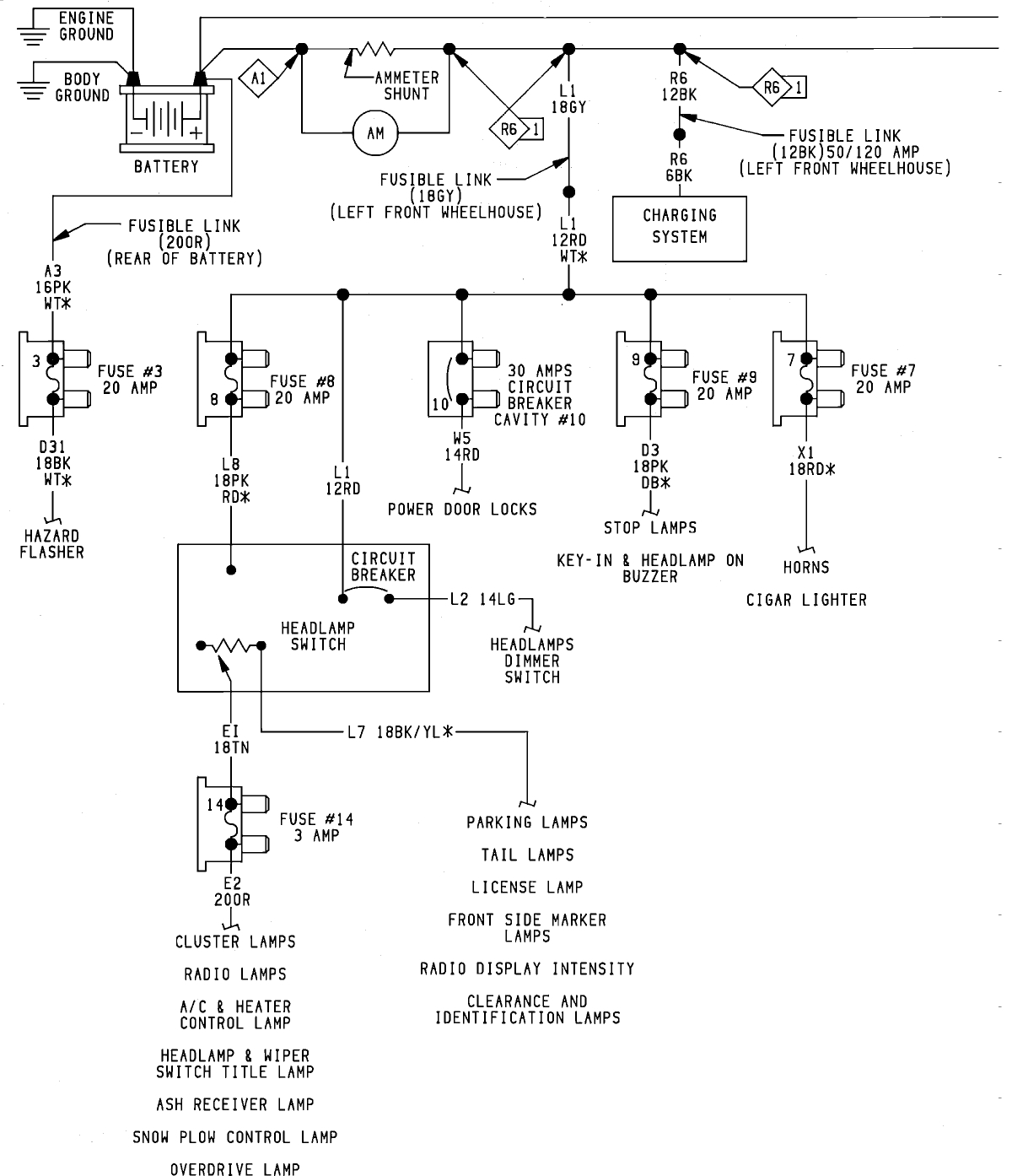

Take a look at the fusible link L1 If it is burnt/corroded you lose all of those or if the circuit has failed to it. Easy way to test if it is related to that is to check for power at fuses 7,8 and 9 as they are the system feeds for those items.
