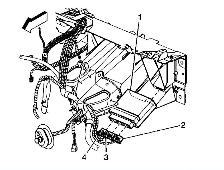

Changed alternator and battery but still not charging.Tested all fuses and when i removed the cluster/BCM fuse the tester dropped. where is this module located?
Jan 20, 2021 at 7:37 PM (Merged)
Good evening,
Are you measuring amp draw? voltage draw is not the way to check for a drain. current flow drains a battery, not voltage. the voltage will always be present but you need to measure current flow. it should be 50 to 75 milli amps as a spec.
https://www.2carpros.com/articles/car-battery-dead-overnight
REMOVAL PROCEDURE
IMPORTANT: You must perform the new body control module (BCM) setup when replacing the BCM. Refer to BCM Programming/RPO Configuration.
1. Disconnect the battery ground (negative) cable.
2. Remove the left instrument panel insulator.
3. Disconnect the BCM electrical connectors (2, 3, 4).
4. Remove the BCM (1).
INSTALLATION PROCEDURE
1. Install the body control module (BCM) (1).
2. Connect the BCM electrical connectors (2, 3, 4).
3. Install the left instrument panel insulator
4. Connect the battery ground (negative) cable.
5. Perform the new BCM setup. Refer to BCM Programming/RPO Configuration. See: Vehicle > Programming and Relearning
