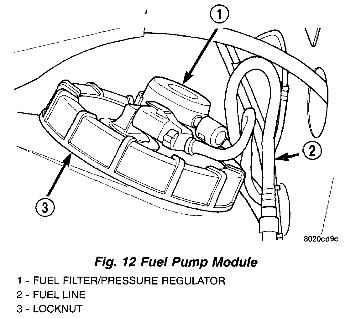

Warning: the fuel reservoir of the fuel pump module does not empty out when the tank is drained. The fuel in the reservoir will spill out when the module is removed.
Fig. 12 Fuel Pump Module
2. Remove fuel tank.
3. Lower tank (Fig. 12).
Fig. 13 Fuel Tank

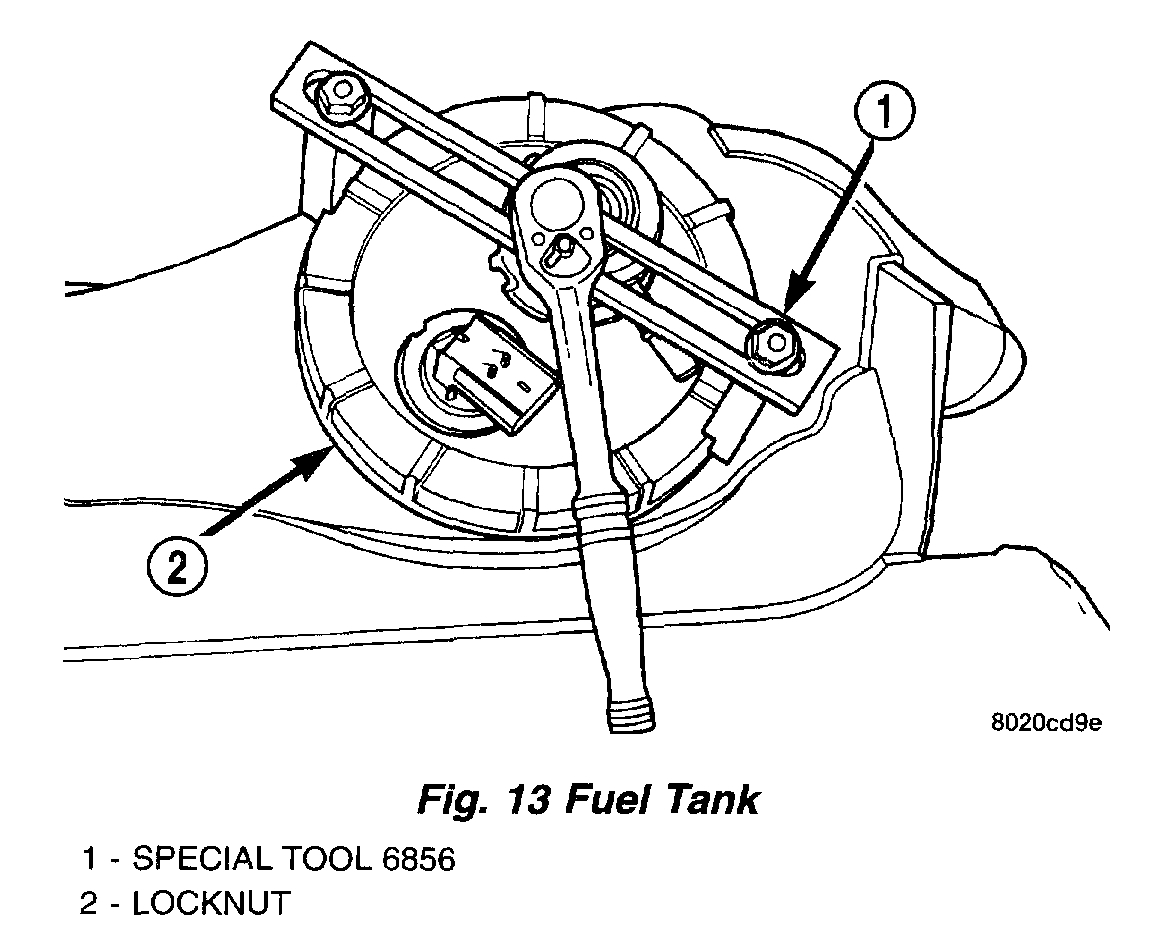

4. Use Special Tool 6856 to remove fuel pump module locknut (Fig. 13).
5. Remove fuel pump and O-ring seal from tank. Discard old seal.
INSTALLATION
1. Wipe seal area of tank clean and place a new seal in position in the tank opening.

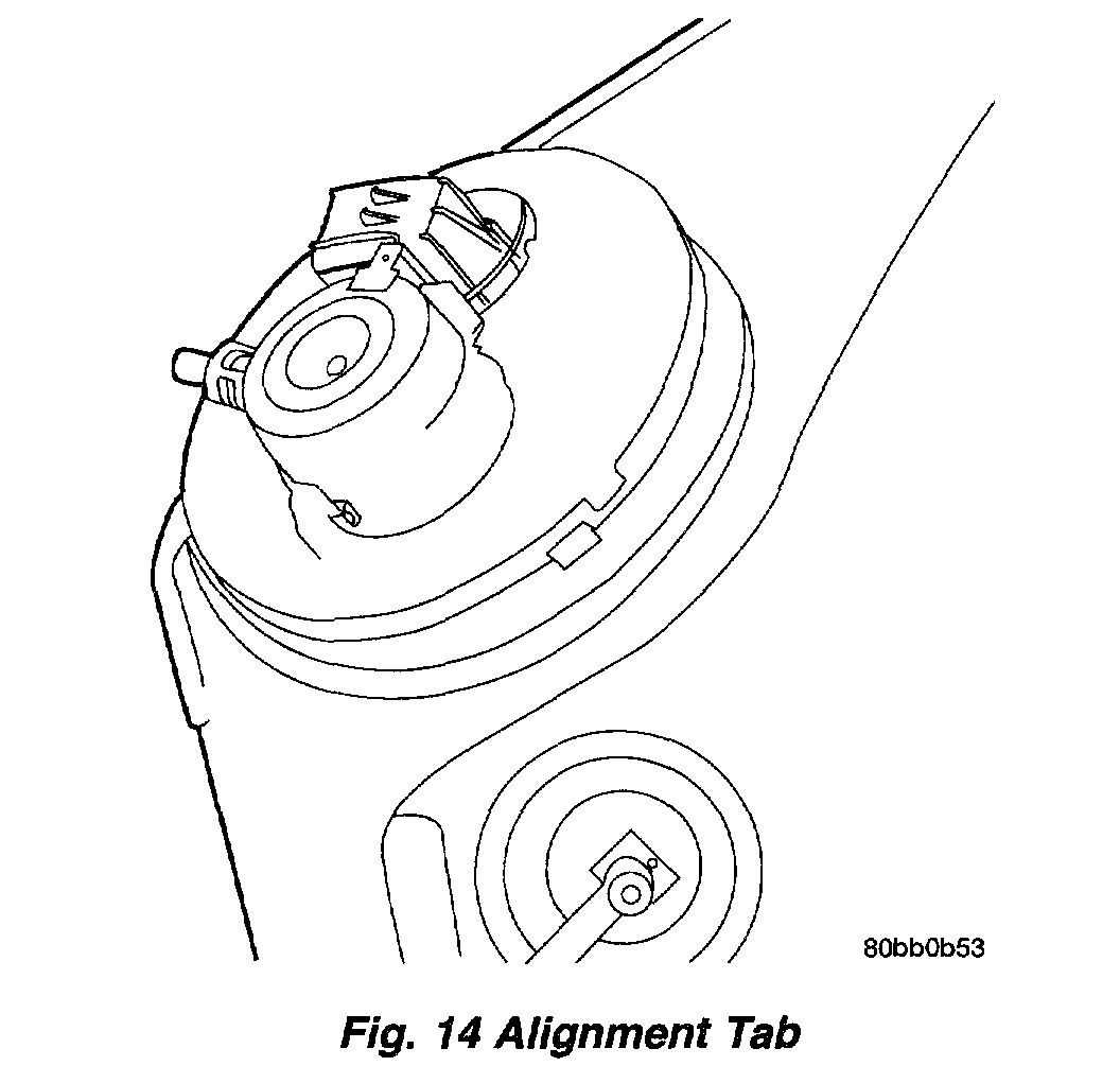

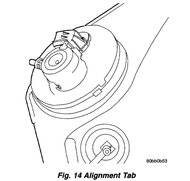

Fig. 14 Alignment Tab
2. Position fuel pump in the tank. Make sure the alignment tab on the underside of the fuel pump module flange sits in the notch on the fuel tank (Fig. 14).
3. Position the locknut over the fuel pump module.
4. Tighten the locknut using Special Tool 6856 to 55 Nm (40.5 ft. lbs.) (Fig. 13).

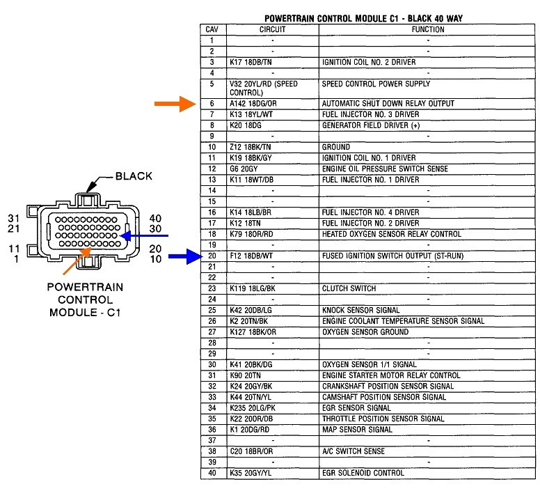

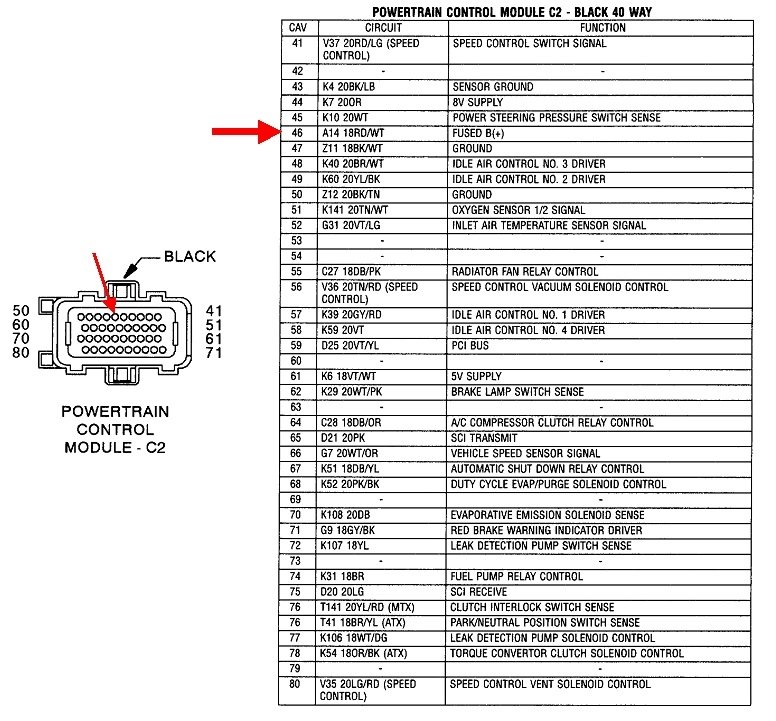

There's two version of the 2.0L engine. There is a very elusive problem with the single-camshaft engine that causes intermittent stalling, but it doesn't apply to the dual camshaft engine. Regardless, it sounds like you have something else going on. Looking at the combination of no diagnostic fault codes and wiggling a wire allows the engine to run intermittently, a good suspect is a bad connection in the wire that supplies the constant 12 volts to the Engine Computer to keep its memory alive. That's the red / white wire in the second connector drawing. If that is the case, losing that connection will erase the fault codes, and it will erase everything the computer has in memory. That doesn't cause a problem as far as learned sensor "personalities" or fuel trim data is concerned. That will all be relearned as soon as you start driving, without you even noticing, but there is one thing that won't be relearned until you're out on the highway. That is "minimum throttle". Until that is relearned, idle speed will be too low, often to the point the engine will not start or it will not stay running unless you hold the accelerator pedal down 1/4".
You really need a scanner to be able to see what the Engine Computer is seeing and reacting to. Without that, there's no way to verify one of the 12-volt supply circuits is missing to the computer, or what else is affecting it, but we can do some of the tests manually. You can look at this article:
but for this type of problem it is better to leave the electrical connector plugged in at the computer, and to back-probe through the back of the connector where the wires go in. There may be a cover to remove from each connector to gain access to the wires. A voltmeter's probe can be too fat to squeeze in alongside the wire. Use a sewing needle or a stretched-out paper clip instead. Slide that in next to the wire, then touch the meter's probe to it. You might have to wiggle the needle a little to insure it is touching the terminal.
You should see 12 volts on the red / white wire all the time. It will only be on the dark blue / white wire when the ignition switch is in the "run" position. The third one, the dark green / orange wire is a little tricky. That one is only going to have 12 volts on it for one second when you turn on the ignition switch. Most digital voltmeters don't respond fast enough to catch that. A test light will work much better. In fact, for this type of problem, a test light can be more accurate than the digital meter for all of the tests.
You might be able to hear the hum of the fuel pump for that one second when you turn on the ignition switch. If you can, that proves the automatic shutdown, (ASD) relay is working, but we still need to verify the 12 volts it switches on is making it to the Engine Computer. That's the dark green / orange wire. Besides it getting 12 volts for one second, what is important is if that voltage comes back when you crank the engine. If it does not come back, but it was there for one second, we have to go in a different direction.
Normally there's four 12-volt feed circuits, but I only see these three that I pointed out. The connector views are of the terminals, not the back side where the wires go in, so be sure to get the right wire colors. A break in the ground circuit can cause the engine to not run too, just like a break in a 12-volt feed wire can, but Chrysler has always used pairs of ground wires to insure that doesn't happen. For that reason failure is not likely and we won't worry about checking those at this time.

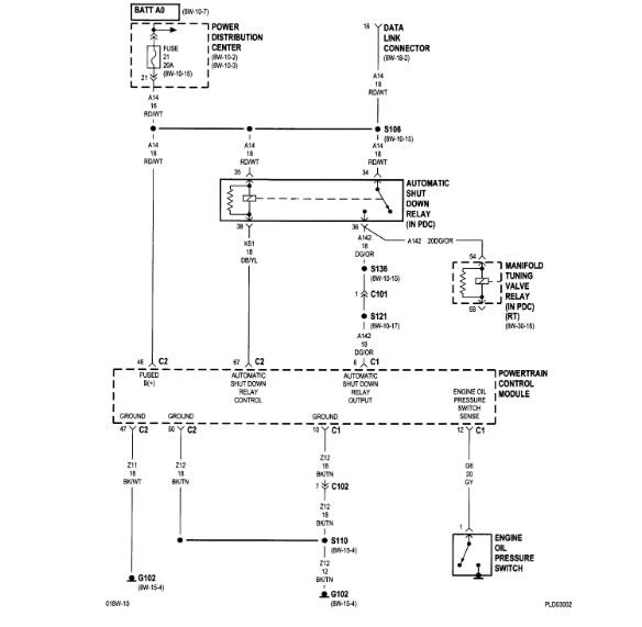

The first step is to determine if the automatic shutdown, (ASD) relay is turning on. This is checked best with a test light because most digital voltmeters don't respond fast enough. Look for the dark green / orange wire at the ignition coil pack or at any injector. Back-probe that wire at any of those places. If you need it, here's articles that show how to use a test light and voltmeter:
You should see the test light turn on full brightness for just one second when you turn on the ignition switch, then it will go off. What is important is it must turn on again when you're cranking the engine. If it turns on nice and steady during cranking, we have either a fuel supply problem or an ignition system problem, but not both. Those are relatively uncommon. Most commonly the light will not turn back on during cranking. That results in no spark, no injector pulses, and no fuel pump, all at the same time. That is almost always caused by a problem with the crankshaft position sensor or the camshaft position sensor. The Engine Computer needs to see those two signals to know when to turn the ASD relay on.

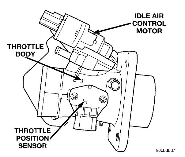

Okay finally got the car to start but wont stay running. Got 2 codes p0123 and p0118.
Apr 1, 2021 at 1:51 PM (Merged)
CARADIODOC
  • 34,306 POSTS
P0118 - Engine Coolant Temperature Circuit High Input
P0123 - Throttle/Pedal Position Sensor/Switch A Circuit High Input
The first fault code will set if the coolant temperature sensor is unplugged while the ignition switch is on. Same with the second code for the throttle position sensor. Now that we have those codes recorded, disconnect the battery's negative cable for about a minute, then reconnect it. If those codes don't set again, they were in memory from before. If they do set again, we'll need to take some voltage readings in those circuits. If you don't have a digital voltmeter, Harbor Freight Tools has a perfectly fine one for less than $7.00. You can also find them at Walmart or any hardware store. Here's a link to an article that shows how to use one, if you need it:

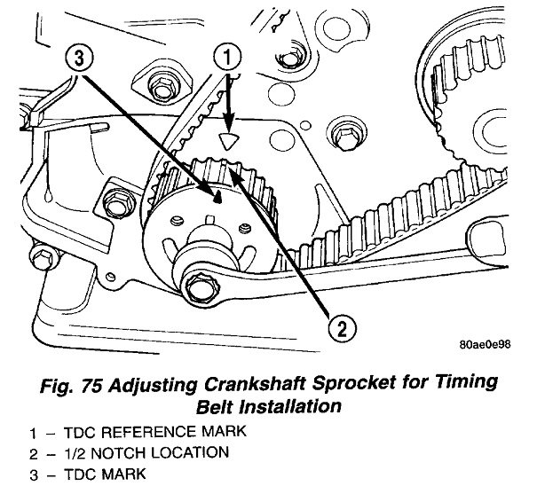

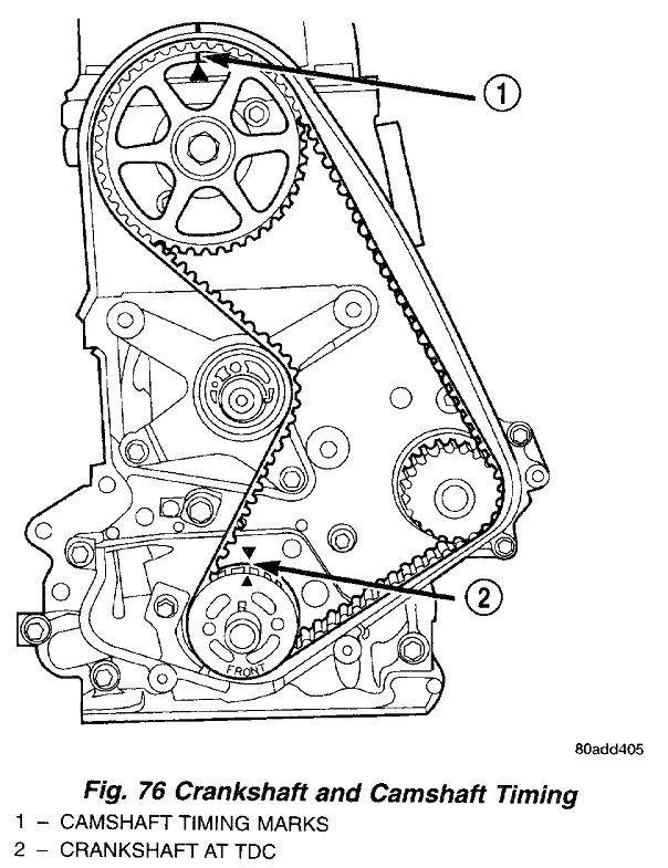

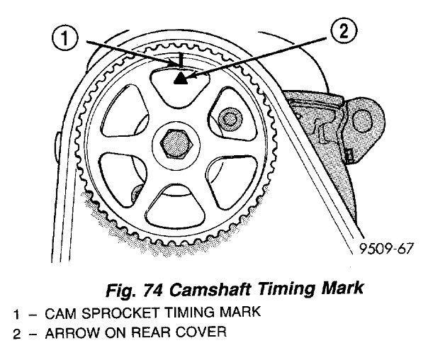

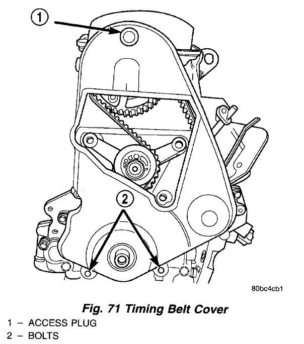

This is an interference engine. When the timing belt jumps one tooth, the "Check Engine" light turns on, and the diagnostic fault code will be "Cam and Crank Sync". When the belt jumps two teeth, the engine computer shuts the engine down. Three teeth and the pistons will hit any open valves.
The first thing to do is to check the timing marks to see if the belt has jumped. You should have a Check Engine light on though. A comon cause for the Cam and Crank Sync code when the timing belt has not jumped is a sheared off dowel pin between the camshaft and sprocket. The sprocket spins a little on the camshaft mimicking a jumped timing belt.
