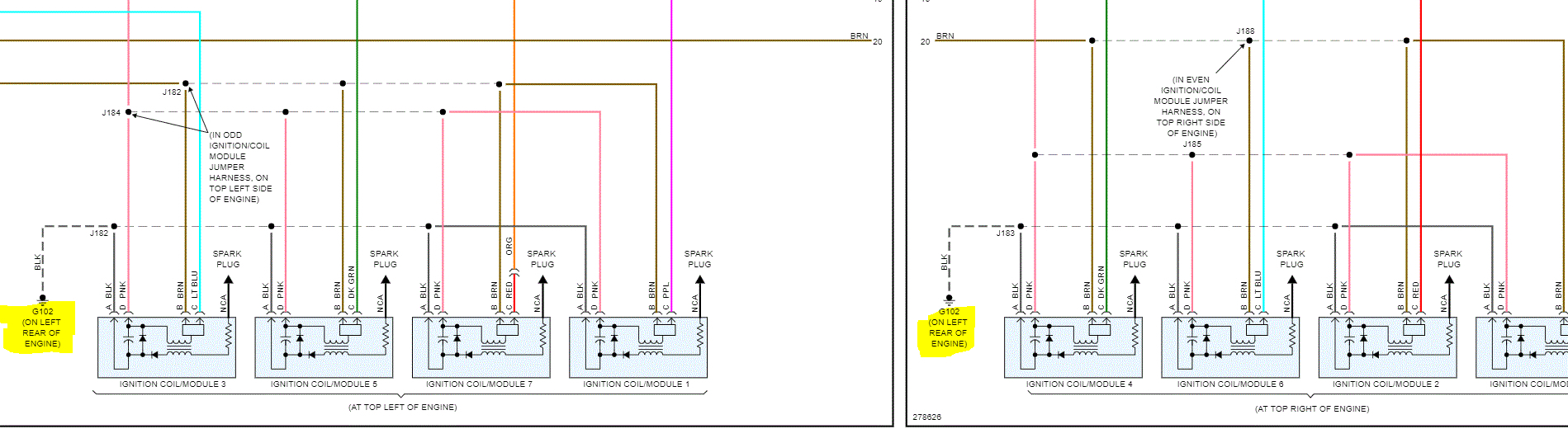

I hope you guys don't mind me jumping in. I read through all the posts you had and wanted to suggest something. These vans with the 6.0 are known to have grounding issues for the coils. All 8 coils are grounded at the same point. The grounds corrode, get loose, and I've seen them actually break and the vehicle not run at all. If you have a weak ground, you may have a weak ignition spark at each plug. It's worth checking.
I attached a portion of the wiring schematic below that shows the ground location. When you check it, make sure to grab onto it and make sure it is in good condition and not corroded or loose.
It's just a theory, but thought it would be good to check.

Thanks for jumping in on this. It is a very good point but it goes back to one of my original points that I'm not getting any codes and it seems to run very good in all other conditions other than full acceleration under load. It seems that grounding issue would definitely set misfire codes and MIL. As Tom said earlier, it really does feel like a timing issue and it makes me feel like it's related to the VVT system, But I don't know how to check it.

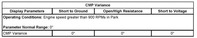

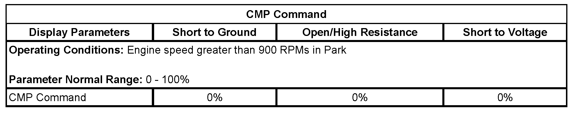

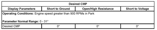

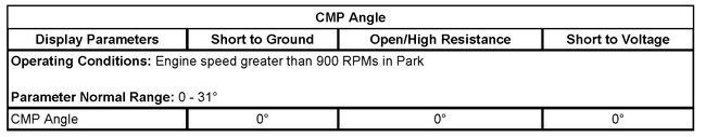

pic 1

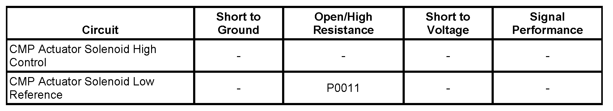

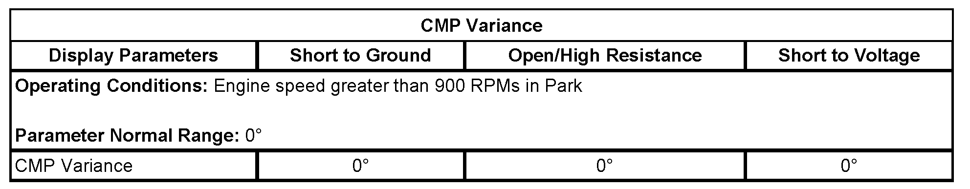

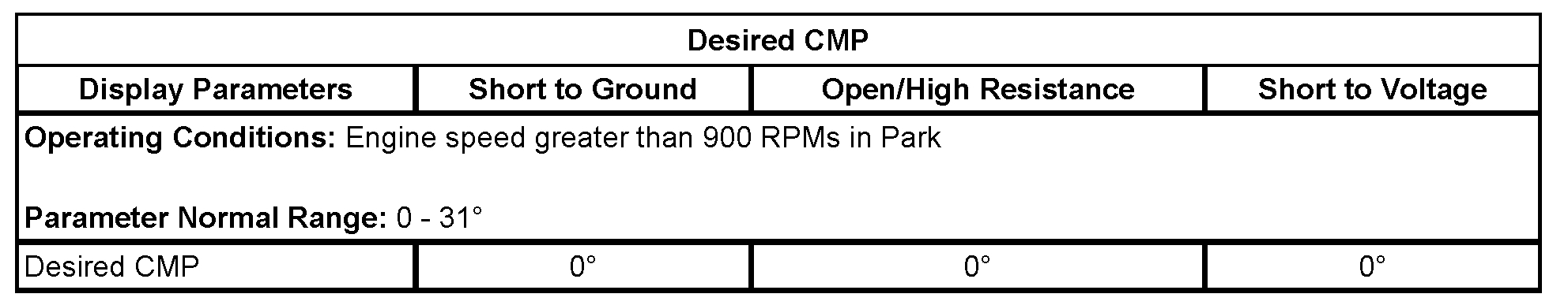

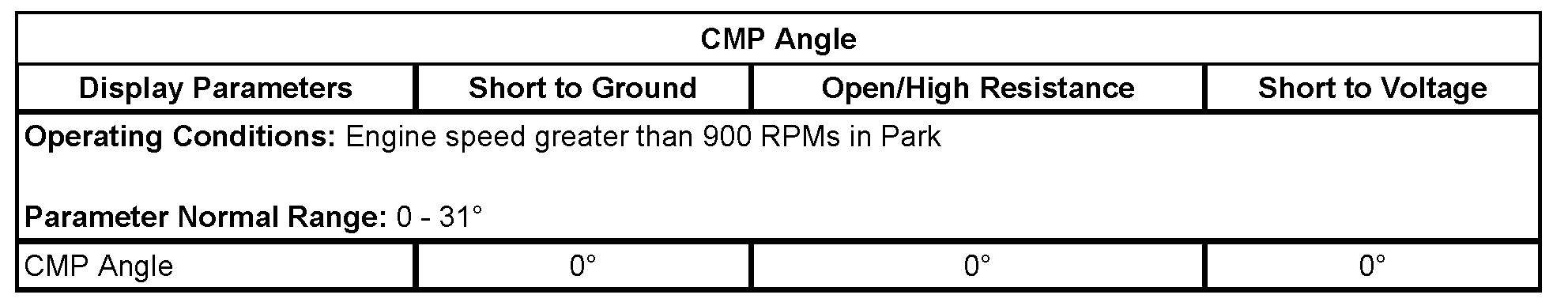

Typical Scan Tool Data Table
pic 2
pic 3
pic 4
pic 5

* The ECM detects resistance greater than 2 ohms on the low reference circuit.
* The ECM detects that the CMP Angle position is more than 8 degrees difference than the Desired CMP position.

4. Using the output control function of the scan tool, command the CMP actuator solenoid to 25 degrees. The CMP Desired parameter value should match the CMP Angle parameter value.
5. Observe the CMP Variance value, on the scan tool. The CMP Variance value will increment for several seconds, until the CMP Angle value matches the Desired CMP value. The CMP Variance value should then return to zero degrees.
