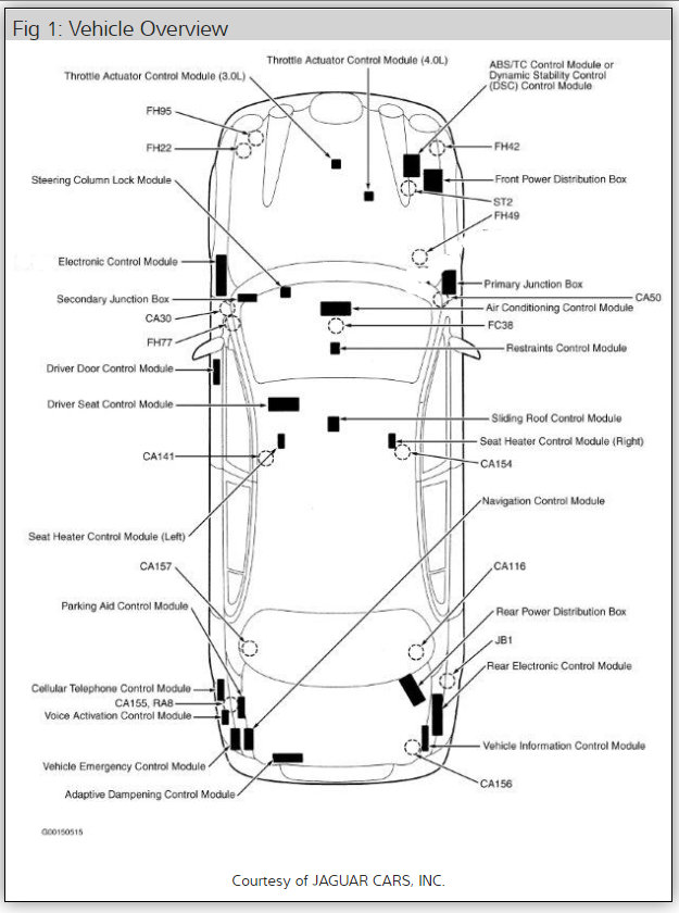

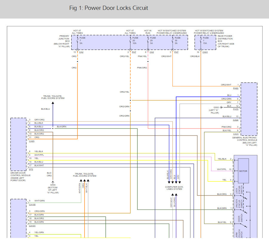

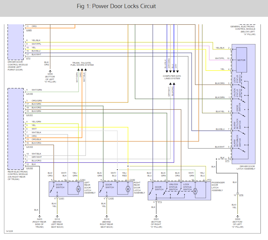

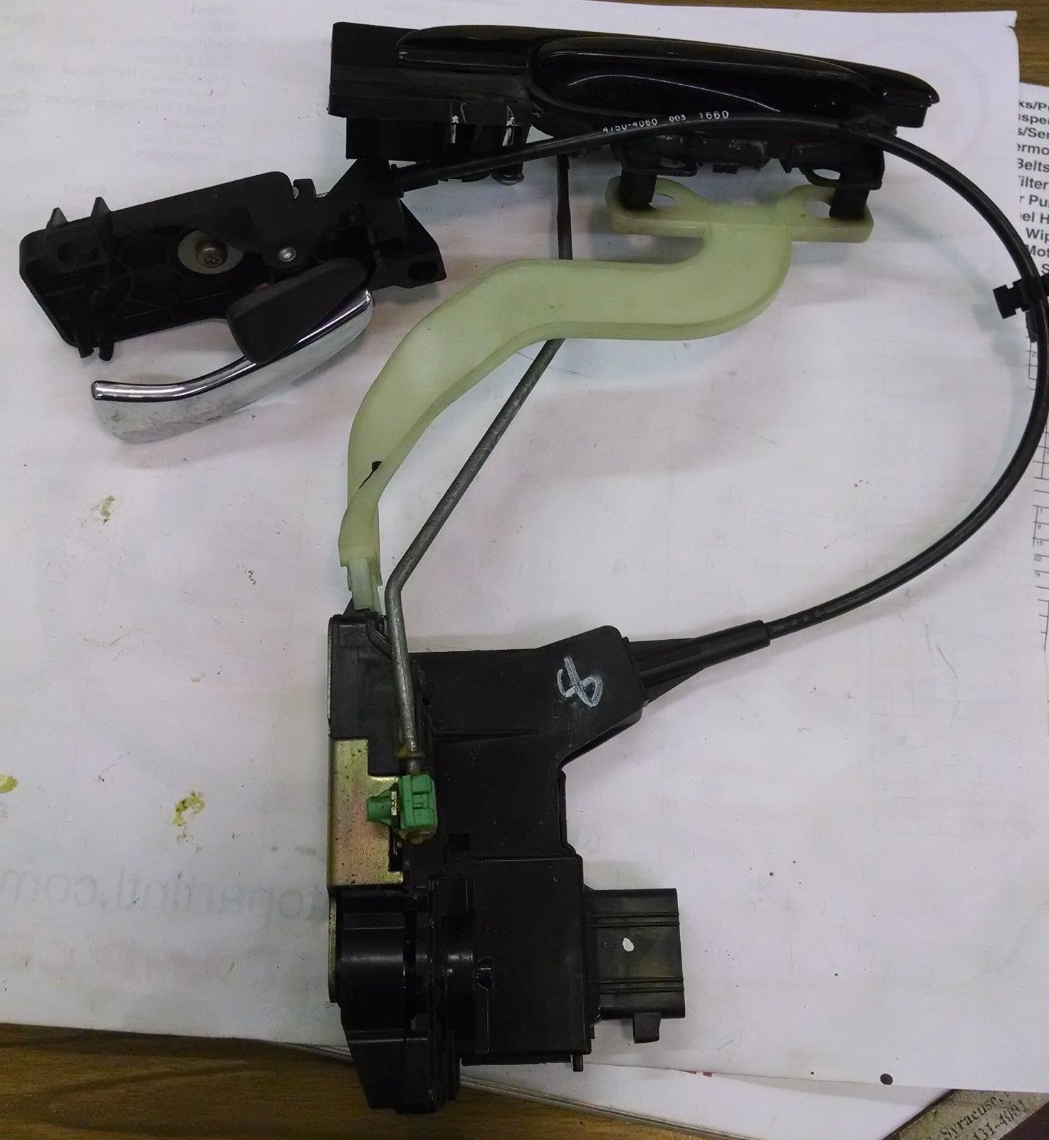

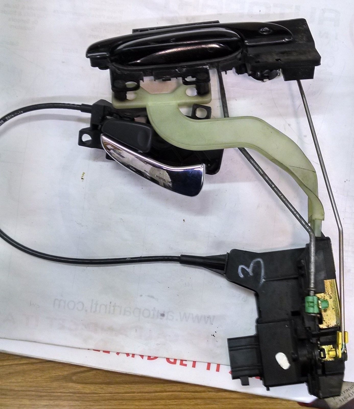

I disconnect the battery and changed the two front locks and latches, it took almost one hour
changing it, again reconnect the battery and the complete locks on four doors are working perfect but the security light still blinking. Again I disconnect the battery and wait for twenty minutes and reconnect it, the security light went off and the car started normally.
I tried several times switching off the car and lock it, open it with the remote it is working perfect, running the engine, it runs normal, the security light on once and when engine starts the security light went off as it should be.
