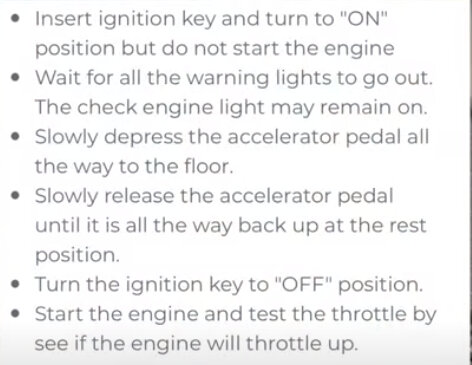

This a manual Throttle Relearn procedure for a Chrysler, I don't know if this will work in your situation, but anything is worth a try right now.
This is the video from that, he waits until the check engine light starts to blink, and then tries the relearn with the gas pedal, so watch the video first, I will post any further info I come across.

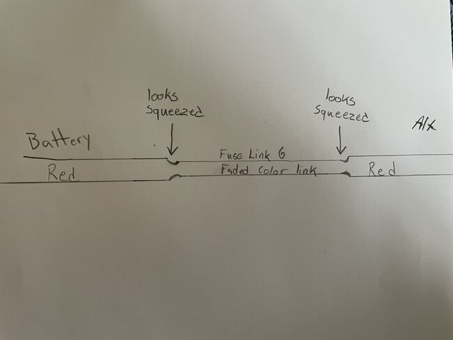

I did the voltage test with the car off and put the black/ground to ground and positive/red probe into the wire just before the link, it showed battery voltage of 11.5 or so, then probed again just after the link and it showed the same voltage.
I didn’t put the ground to the positive for the test, I’m using a loaner multimeter and didn’t want to end up frying it.
I meant to get a picture of the link but forgot. But this image is basically what it looked like.
Jun 29, 2023 at 6:55 AM
MATHGEN
  • 128 POSTS
Okay, thanks for the clarification. In this case the fuse link tests okay. What is the battery voltage with the engine running now?

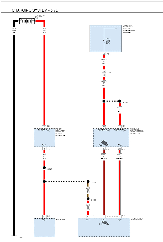

Alright, the alternator is not charging. I found this excerpt in a service manual: Voltage is monitored at the B+ terminal stud to insure it is connected. If the B+ cable is loose, the PCM will shut down the generator field. Because of this new feature, pin-2 of the field connector is internally connected to the B+ terminal.
So, I would double check that all of the connections from the battery post to the alternator are clean and tight. Then I would carefully back probe the GY/RD wire at the alternator for voltage with the key on engine off and with engine running as long as it is safe to do. Red lead to connector, black lead to ground. You should have battery voltage.
If that is ok, I would check for a signal on the BR/PK wire at the alternator. A test light connected to battery positive and back probed to the alternator connector should flicker with the engine running. This shows that the PCM is trying to command the alternator.
