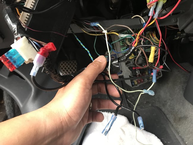

Did try it, but no luck. i bought the car with an after market alarm on it, and some of its wires are not connected anymore. if i disable the alarm by removing all its connections do you think it will work or do i need to put back all the wires that are disconnected?

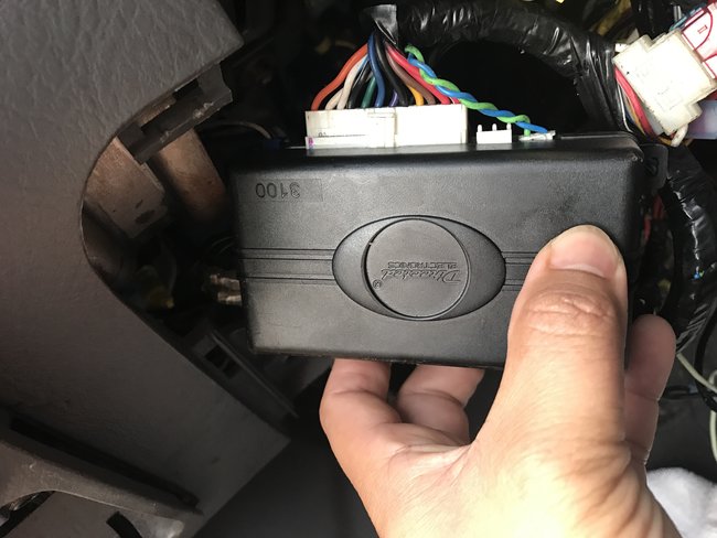

Is that alarm after market? it looks like it is.
Jan 4, 2021 at 12:24 PM (Merged)
BRYAN08
  • 12 POSTS
Yes it is...do you know where can i put a fuel port so that i can check the fuel pressure..coz the mechanic just used his thum to check the pressur..im just wondering coz it start with a starting fluid...thanks a lot for you guys time

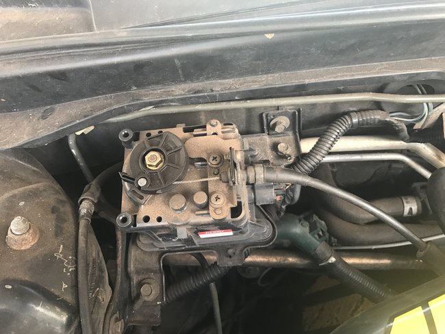

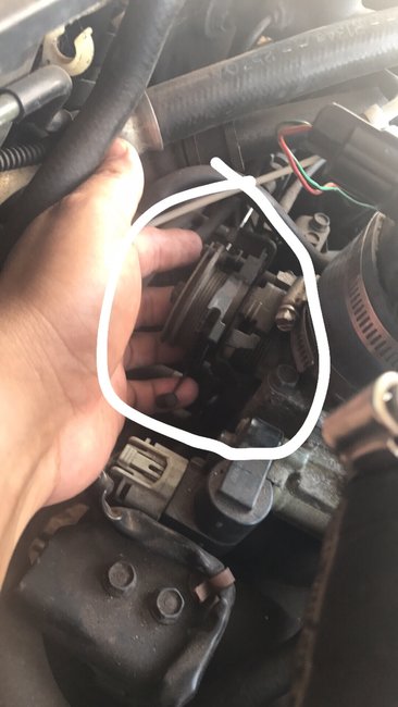

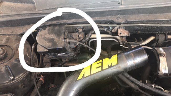

Ei ken...i found a disconnected cable...attached photo...i dont know if its connected for the car not to run
BRYAN08
  • 12 POSTS
I removed the cover to expose the inside...th
This is the cruise control, does nothing to keep the car from running.
