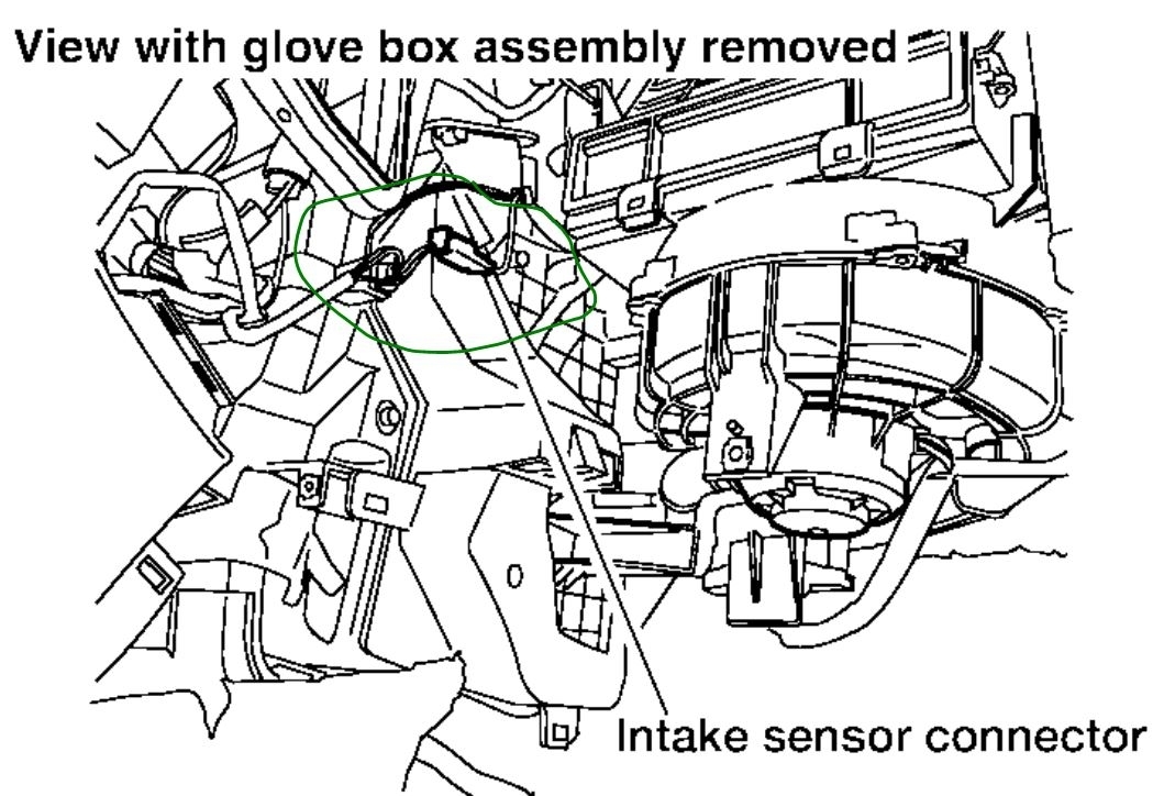

The connector for the sensor is outside the case above the blower motor. With it unplugged you can test for the resistance using the table. If it isn't correct then it gets replaced. That could be tricky as the sensor is actually set on the evaporator core. The book tells you to remove the core to replace it but if you could reach in there through any opening and get to the core you might be able to just stick the new one in there and connect it up. I know of one person who reached in through the cabin filter opening.

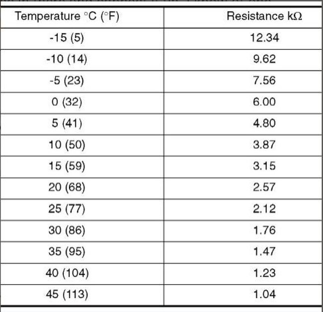

Steve, I gained access to the car again... couldn't read the resistance charts when I magnified them, so I bypassed the thermistor.
A/C seems to work fine with thermistor bypass. so I guess I will just replace that. Do you have a good source and if we run the A/C without the thermistor to control, is intermittent use okay?
Thanks again.
Mar 22, 2021 at 11:20 AM
STEVE W.
  • 15,113 POSTS

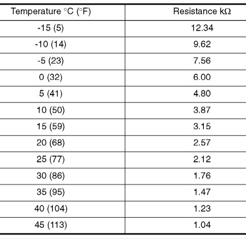

Try this chart. Should show up very large if you just click on it. The thermistor controls a couple items to keep the core from icing up, You might be able to run without it but that isn't something I've ever tried as having the core freeze up isn't a good thing.
Mar 22, 2021 at 3:24 PM
A1953
  • 40 POSTS
That worked to read the table. Thank you. I will check the resistance out and let you know what I find. If the resistance is correct, and the evaporator is icing up that often, what might be the cause of that?

Finally got to try for resistance....273 @ 80 degrees so I guess I will replace the thermistor. Still using A/C intermittently and still working well. Thank you again for sticking with it to the end. That was quite a puzzle!.
Mar 31, 2021 at 11:31 PM
STEVE W.
  • 15,113 POSTS
That would do it. The system thinks it's freezing up and shuts down then warms up just enough to work. Thank you for being diligent in tracking the problems. That is the bigger item. Thank you for using 2CarPros.
