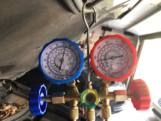

I can turn it with my hand. I checked the 7.5 amp fuse and it has power. Switched around relays still nothing. Both fans come on when turning A/C on. Gauge readings are in the picture. The inside panel shows outside ambient temperature as -40 not sure if this has anything to do with it. Freon level was a bit lower but I tried to add some to see if it was low, but I doubt it is.

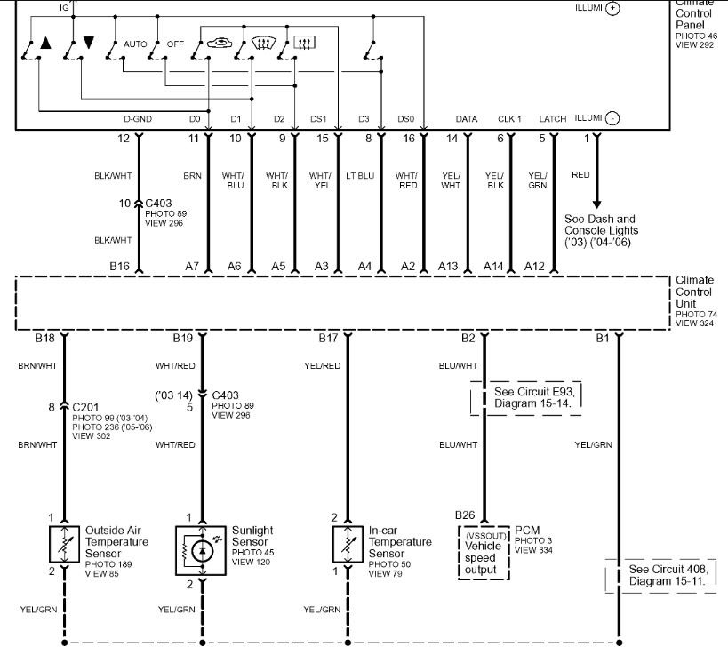

Hello, when a temperature sensor reads -40 degrees it means that the sensor has an open wire inside of it or a wire going to the sensor is open (broken). The -40 degrees is a default strategy the cars computer reverts to. Here is 2 wiring diagrams of the A/C wiring, there isn't much involved. Just the relay you already checked and the wiring the computer. There should be a code stored in the computer for the ambient temperature sensor. So you need to have the computer scanned for codes to start with, your local parts store will scan it for free. You should check Fuse #59 it feeds the A/C compressor relay. You can also check at the compressor for power on the light blue wire with the system on. The relay is directly controlled by the cars computer. It sounds like because the computer is seeing -40 degrees outside, its probably not turning the A/C compressor on. But i would address the temp sensor first, then see if your compressor turns on. Has the check engine light been on at all?

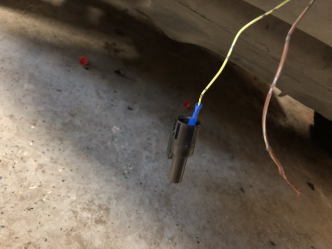

The end of the wires to the ambient sensor are too short to connect them so i attached couple of clips and compressor didn't come on and temperature didn't change from -40. One has ground and the other has nothing. Yes, also an o2 sensor p2237. And vtm-4 light as well which i think gave me a speed sensor for one of the wheels. So how do i know that this sensor for ambient temperature can be the cause? I very doubt it will not let my A/C compressor come on.

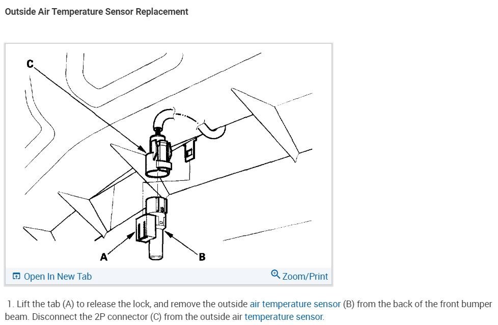

okay, so we have to figure out which temperature sensor has the broken wire. there's an outside temperature sensor and an Evaporator temperature sensors. One has a brown wire and the other is brown/white. The yellow and green wire is ground for both sensors. If the Evap temperature sensor wire (brown) is broken it will not allow the compressor to come on.
Jul 31, 2020 at 1:30 PM
NASER NASER
  • 836 POSTS
It is located on the front of the evaporator mounted to the plastic grille. Two wires, must be the outside temperature sensor cause of the colors. The evaporator wires are similar but they end up being black coming out of the sensor as am seeing in the diagram, which isn't the case here.
Jul 31, 2020 at 1:33 PM
AL514
  • 5,465 POSTS
Just go by if it's a brown wire or if it's a brown with a white strip, it's located behind the front bumper. The outside temperature sensor is like any other thermistor, same as a coolant sensor, intake air temperature sensor. It receives a 5 volt reference and the ECM monitors the voltage on the circuit to make calculations. Never apply 12 volts to it. You may have damaged the sensing circuit in the climate control unit.
Jul 31, 2020 at 1:46 PM

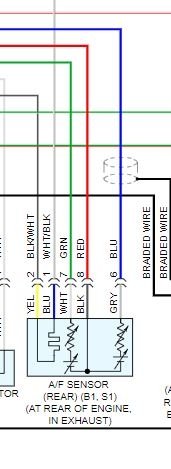

There may be other damaged wires too, depending on how that one got broken. I would follow that wire as far as you can and make sure there's no other damage. Here's the rear A/F sensor (02) Bank 1 Sensor 1. Check the wiring for this as well before replacing the sensor.
Jul 31, 2020 at 2:00 PM
NASER NASER
  • 836 POSTS
before catalytic right?
Jul 31, 2020 at 2:02 PM
AL514
  • 5,465 POSTS

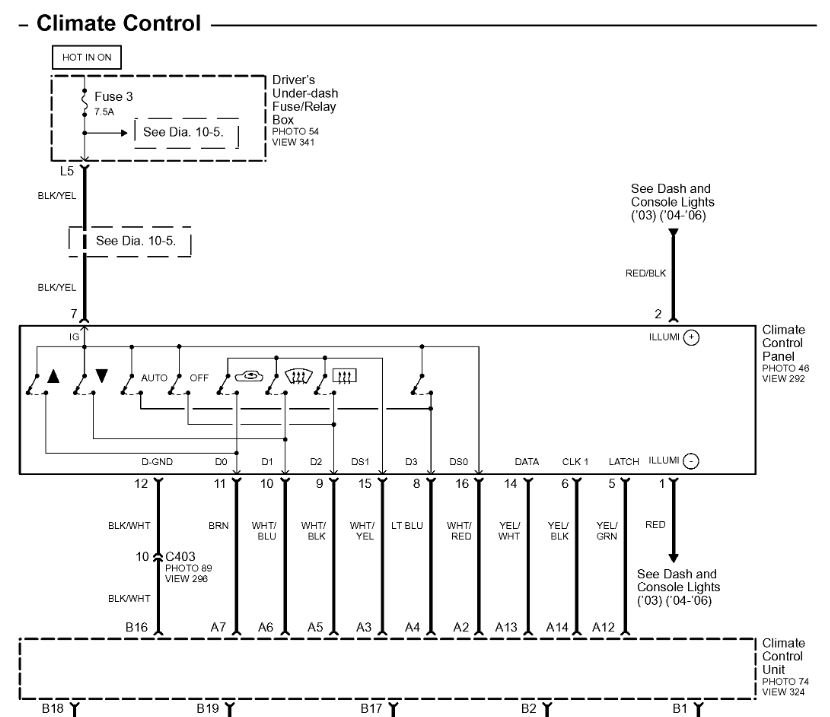

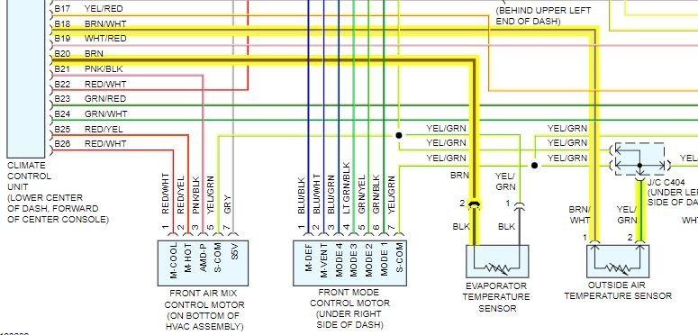

Yes, the A/F sensors are wide band 02 sensors and are before the catalytic converter, the 02 sensors after the cat are narrow band regular 02 sensors. Here's a diagram of the climate control unit if you want to check the brown/white wire coming straight out of it. Should have a 5 volt reference coming out. You may want to go through your fuses too, just to verify they're all okay. That broken wire hanging down could have shorted out on the frame. Check this #3 7.5amp Fuse as well, it powers up the climate control unit and panel.

No the were not hanging i cut them, they were just broken and insulated.

Fuse checked it more than once, all fuses have power and good. The A/C display is fully functional. And none of the wires behind it are brown/white.

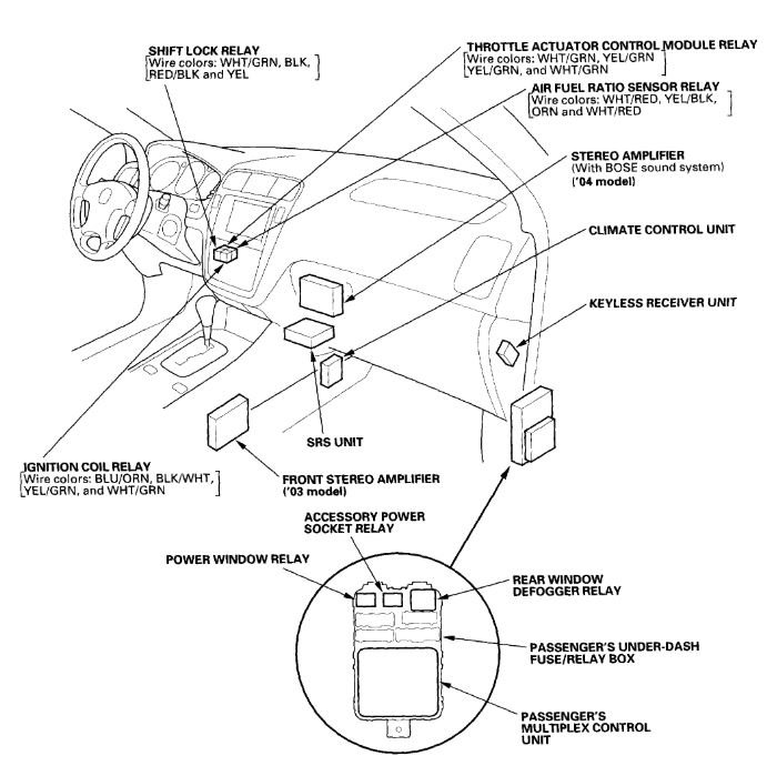

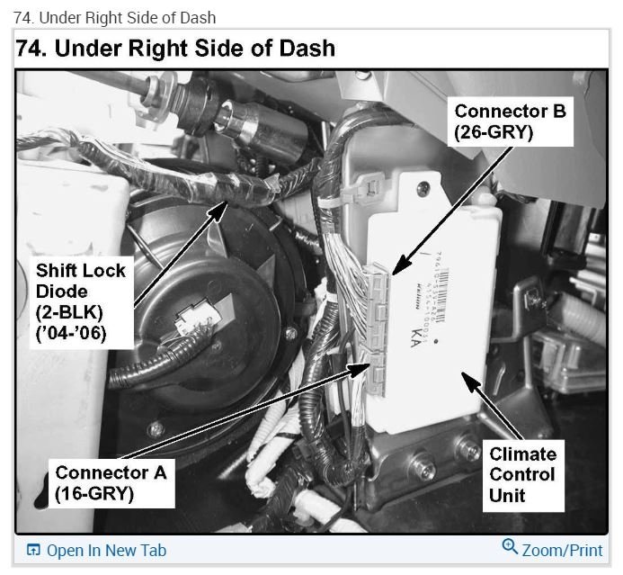

The climate control unit is different than the display panel with controls on it. The Climate control unit takes commands/inputs from the display panel. Here is its location:
Jul 31, 2020 at 3:33 PM
NASER NASER
  • 836 POSTS
found it. checked volts and it's 5v as you mentioned. also checked on the front sensor wires by attaching + and - via multi-meter to the 2 wires and also gave me 5 volts.

Resistance on the sensor is none, which i believe means it bad. The sensor harness wires were cut from the root of the clip so i had no way of connecting back.

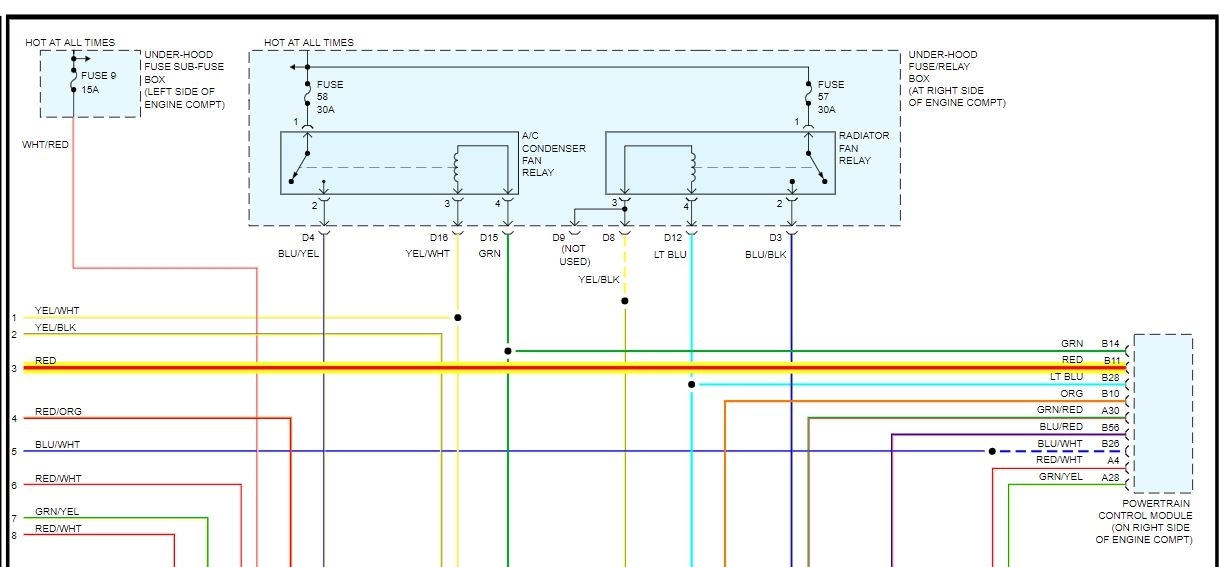

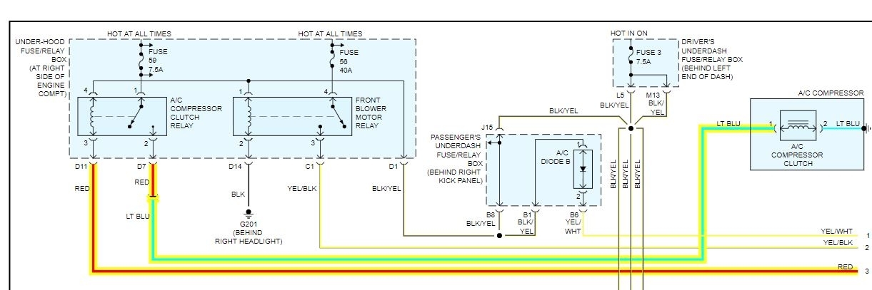

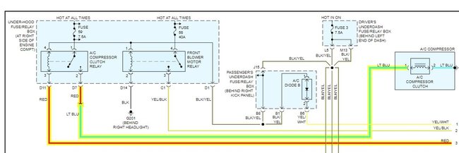

You can put 12 volts to the compressor if it's "unplugged" for a few seconds, if you look on the diagram of the compressor circuit, you can see the light blue wire is the power coming from the relay, but it's risky doing that. If the wire touches anything it will blow a fuse to start with, and you don't want to damage any computer components or burn something up. I don't recommend it. I'm not sure exactly how many wires the compressor has going to it. But it might have a ground wire or pressure solenoid/sensor inside the compressor, and you definitely don't want to damage any of that. I was wondering when did you take those pressure readings from the first picture?

I had to look closer at the picture, the system has even pressures on both sides, which is good. The pressures should even out when the system is off.

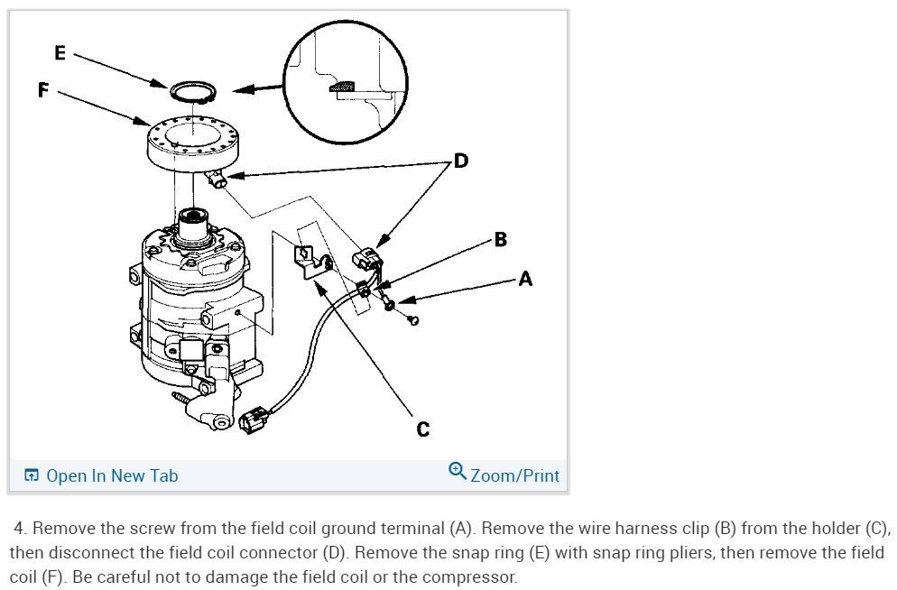

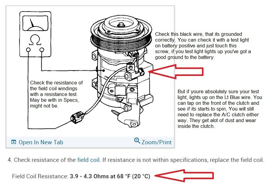

Replaced it with an Acura sensor and the harness connector. the display now reading okay, but compressor not kicking on. Tested the blue light while disconnected and it has power. So pretty much the compressor clutch? I seen people replacing just the clutch while compressor is still on the car, have you done that before?
Aug 5, 2020 at 2:14 PM
AL514
  • 5,465 POSTS

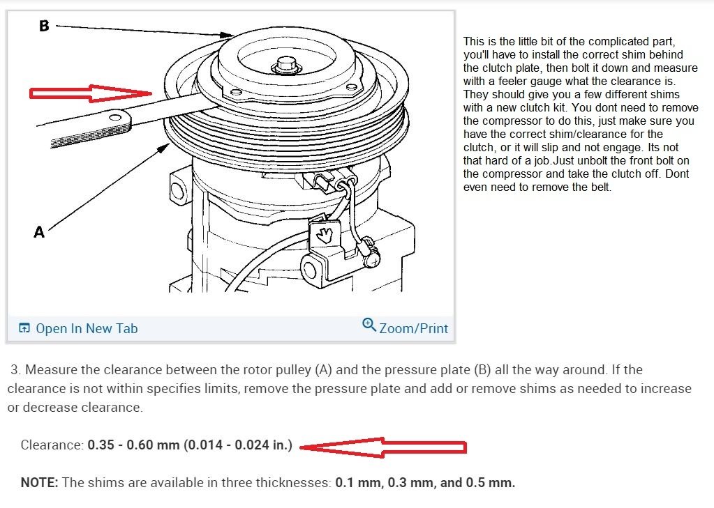

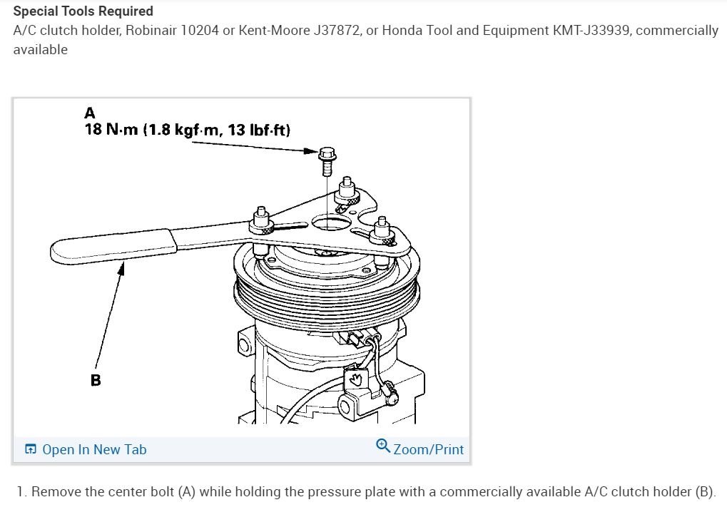

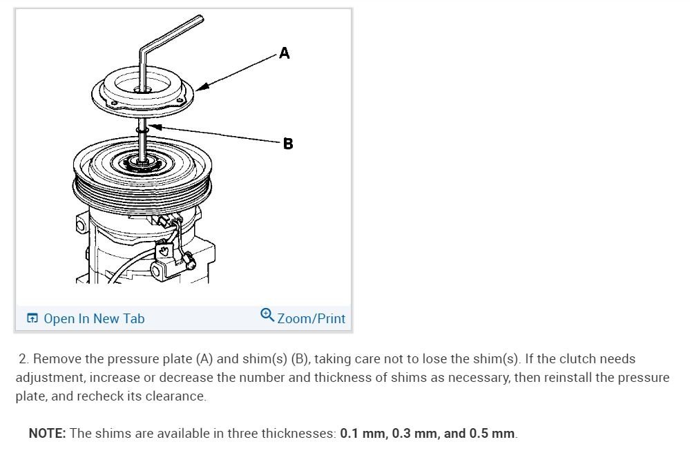

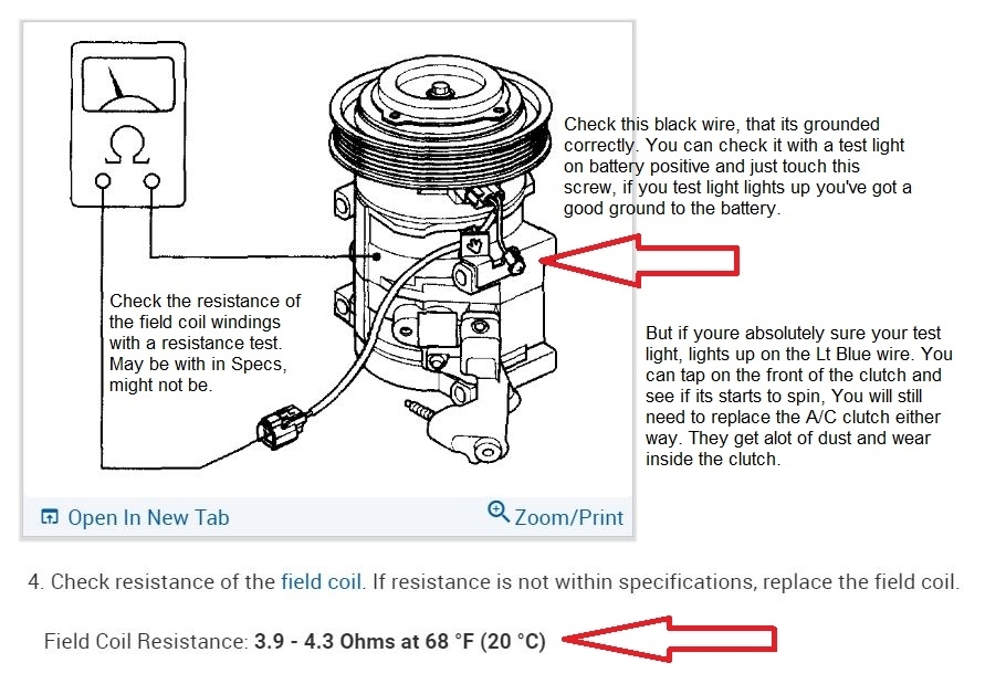

Yes, you can replace the clutch without even taking the belt off. Here are some diagrams with instructions on the proper shim and clearance. Try tapping on the clutch and see if it will free up, you will still need a new one though. As long as your powers and grounds are good, it should turn.
Aug 5, 2020 at 3:04 PM
NASER NASER
  • 836 POSTS

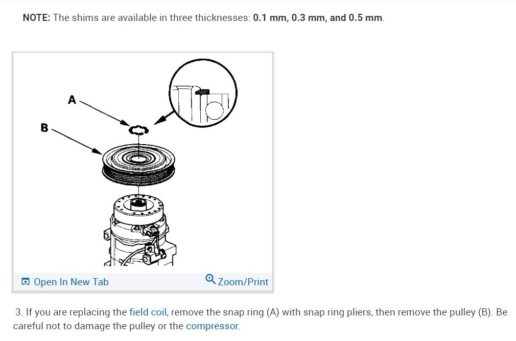

Yes, tried tapping then and nothing worked , but i think belt needs to come off as the clutch is behind the pulley. the one with the electrical connector.
Aug 5, 2020 at 3:09 PM
AL514
  • 5,465 POSTS

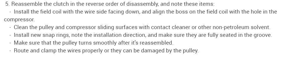

Yup you're correct, the belt does need to come off. Here's the instructions from All Data for A/C clutch replacement procedure .
