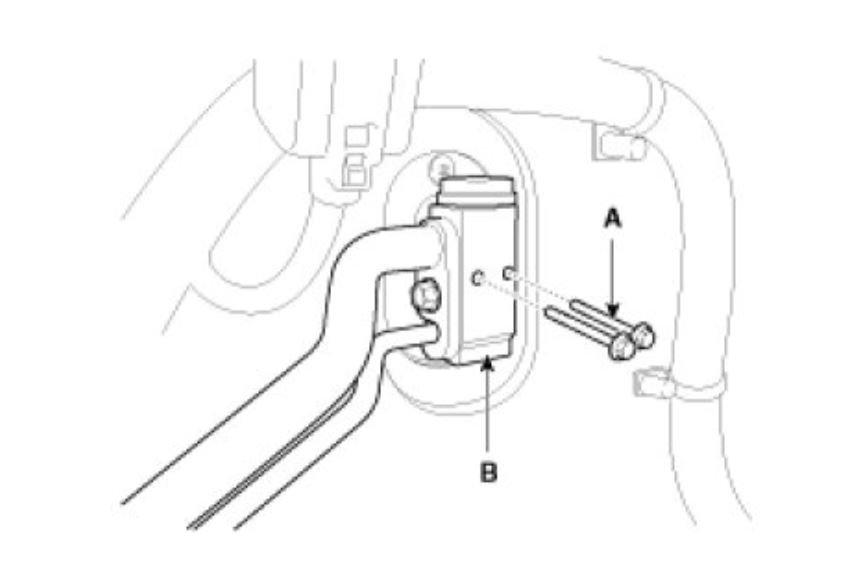

Oh okay, and is that expansion valve picture? That is under dashboard right?
Oct 11, 2019 at 11:33 AM
No, under the hood by the firewall.
Oct 11, 2019 at 11:55 AM
