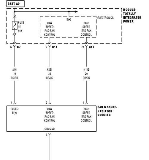

I will clean the condenser again and straighten the fins. The other thing is I had problem with the fan it was not engaging and the car was overheating. The problem was the fan connector was sparking and burn out. I just tighten the pins.
Jun 3, 2018 at 6:15 PM
Okay.
I would get a new pig tail for the connector and replace it.
Jun 3, 2018 at 6:18 PM
ZEMORZEMOR
  • 486 POSTS

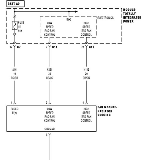

Today I cleaned the condenser and straighten the fins. Temperature is the same. Also I checked the fan operation. There are two relay's on the top of the fan. When I jumped the first one the fan run. When I jumped the second one the fan ran with the same speed. I heard this car has two speed fan? Low and high. How the computer command the high speed fan?
Jun 5, 2018 at 11:56 AM
The TIPM or the fuse box controls the high speed fan. The dark blue/orange wire should be hot to run the fan at high speed. If that wire is hot or has voltage, the fan itself is the failure.
