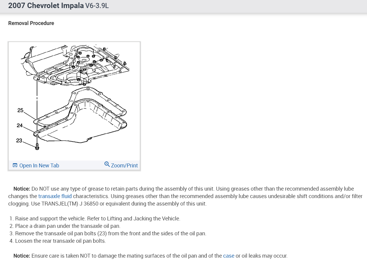

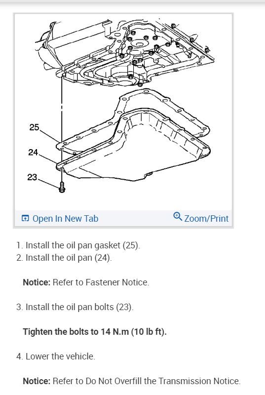

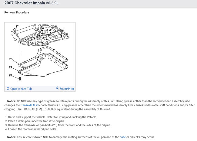

You are welcome for the help, that what we are here for. :) here are instructions that should help you with the transmission pan leak:
Notice: Do not use any type of grease to retain parts during the assembly of this unit. Using greases other than the recommended assembly lube changes the transaxle fluid characteristics. Using greases other than the recommended assembly lube causes undesirable shift conditions and/or filter clogging. Use TRANSJEL(TM) J 36850 or equivalent during the assembly of this unit.
1. Raise and support the vehicle. Refer to Lifting and Jacking the Vehicle.
2. Place a drain pan under the transaxle oil pan.
3. Remove the transaxle oil pan bolts (23) from the front and the sides of the oil pan.
4. Loosen the rear transaxle oil pan bolts.
Notice: Ensure care is taken NOT to damage the mating surfaces of the oil pan and of the case or oil leaks may occur.
5. Use a rubber mallet to lightly tap the oil pan or use a screwdriver to pry the oil pan loose.
6. Allow the fluid to drain.
7. Remove the remaining transaxle bolts (23).
8. Remove the oil pan (24) from the automatic transmission.
9. Remove the oil pan gasket (25).
10. Inspect the oil pan and the filter for the following foreign material:
* Metal particles
* Clutch facing material
* Rubber particles
* Engine coolant
11. Determine the source of the contamination.
12. Correct the source of the contamination.
Check out the diagrams (below). Please let us know if you need anything else to get the problem fixed.

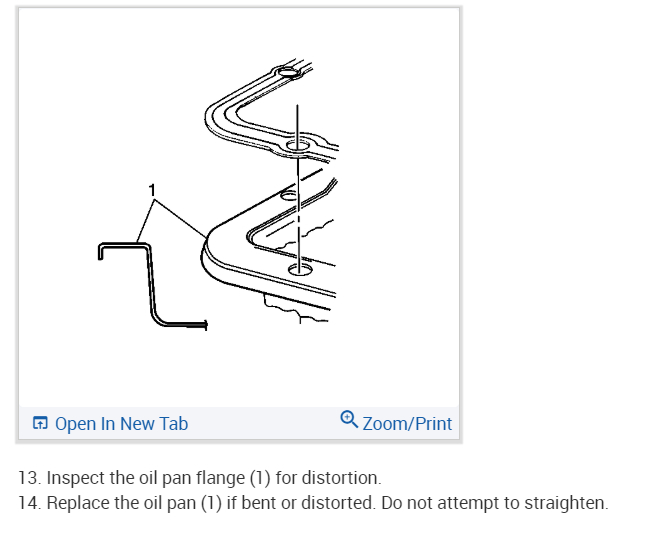

what is photo number 2? Is that just the outside part of the pan? and thanks for the information.
Mar 17, 2021 at 3:59 PM
(Merged)
Sorry, #2? I don't see it?
(Merged)
They are just showing you a cross section of the pan metal shape is all, it is not a part.

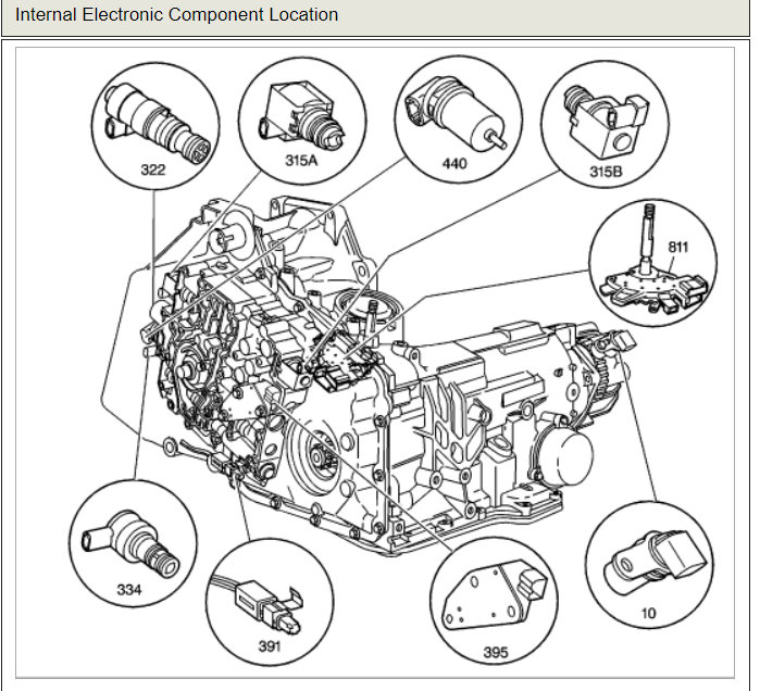

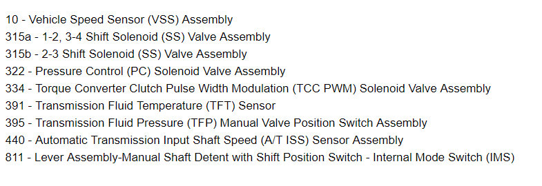

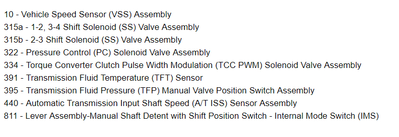

It sounds like one of two things has happened. First does the shift lights move when you are changing gears? If not then you need to replace the transmission range sensor which is located on the transmission near the shift cable hook up. Next is if the filter was not installed correctly with the right O ring or if they forgot the O ring the fluid will not be drawn into the transmission via the fluid pump.
Here is a guide to see what I am talking about for a correct transmission service.
Here is the transmission range sensor location. its #118
Cheers
Cheers
