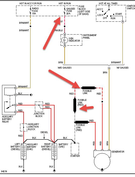

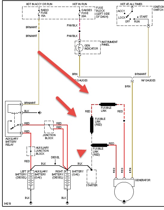

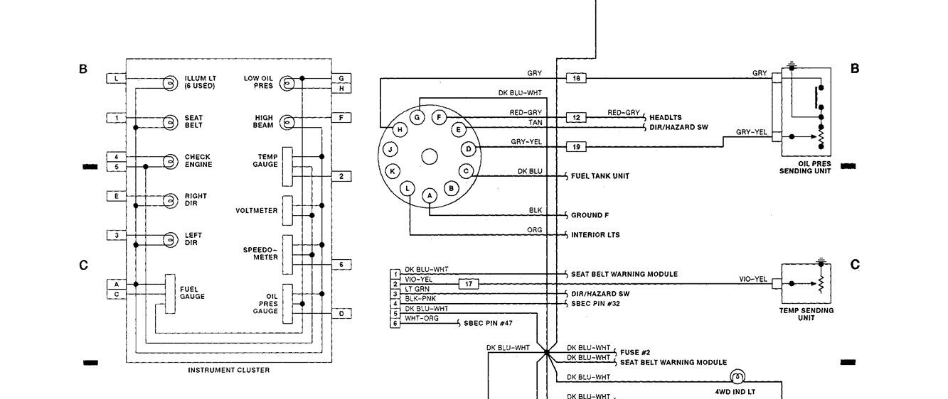

This sounds like a connection problem somewhere in the wiring harness. Here is a full diagram (below) of the alternator wiring that you will need to get the problem fixed.
Also here is a guide to help with the testing, check for power everywhere in the system

check items in pic these are on the starter and I'd bet on eof them is burnt up and not sending power they should have the same on like 12volts on both sides. they are available at auto parts. if you look on alternator it will be stamped or etched as to how many amps it has on the case by where you bolt it in.

the 15 amp difference isn't goin g to make a big difference unless you have a lot of power items like seats rear defogger etc and or maybe pulling a trailer. Just check what I said becais e those fusible links won't send power to alternator to make it work if they are burnt and I thin they may be.

ant LOOK at a fusible link you have to use either a test light or volt meter to see if power is going through it. should be same voltage on both sides I'd bet this is your problem cause it's not charging.

the brown wire does have power and it shuts the light out. I still think there is afusible link problem. there may be two that run off of the starter but onemore in the harness running down the intake to the alternator. If you can't find it have a pro look at it. and make sure your battery is in good shape even if it is new , doesnt' mean it's good. autoparts can test it. but I really think you have short in system causing your problem due to age. either that or your fusible links are hanging on by one or two strands and don't let the power go through them like it shold and causes this.
