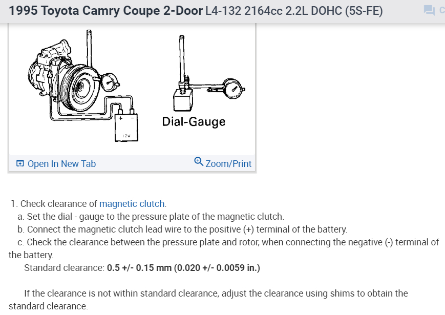

The magnetic clutch has a clearance specification.Sounds like when you reassembled it might be too tight causing it to get hot. I've attached a picture step below on how to adjust the gap.Hope this helps and thanks for using 2CarPros.
