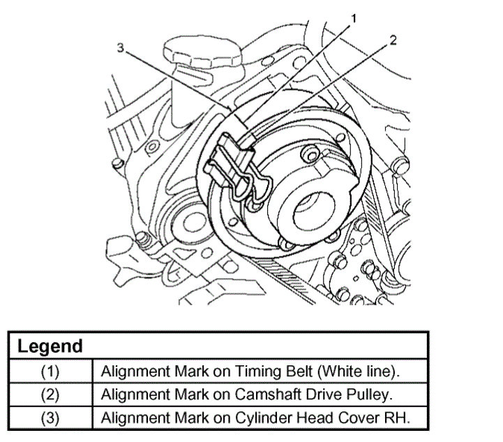

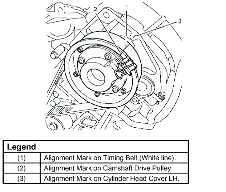

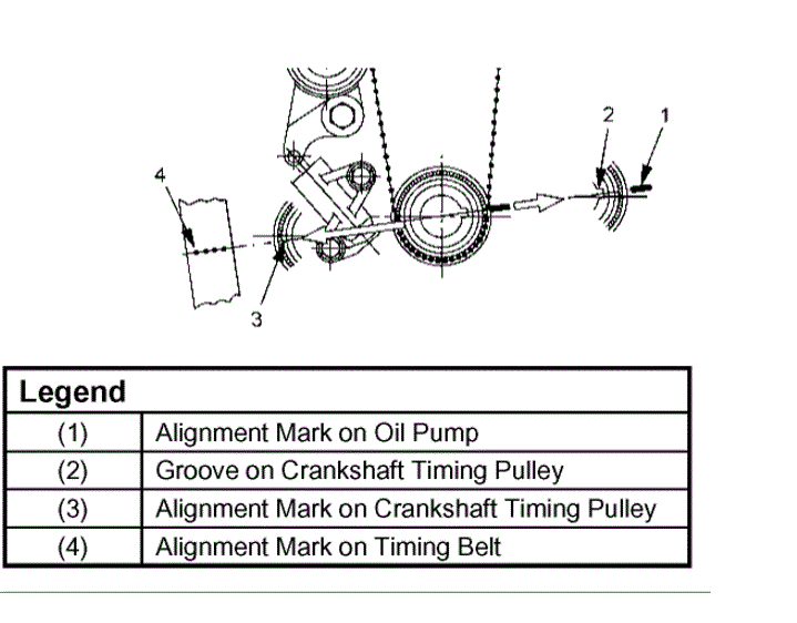

I found this diagram for you.
Oct 2, 2018 at 10:07 AM (Merged)
hope this helps.

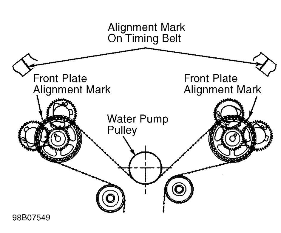

Changed the head gasket and the intake manifold gasket.Trying to find out how to set the cam timing because now I have no compression.
Oct 2, 2018 at 10:08 AM (Merged)
WRENCHTECH
  • 20,761 POSTS
If you have been cranking that thing with the belt out of time you have likely done serious valve damage now because that is an interference engine. http://i1198.photobucket.com/albums/aa448/Wrenchtech/89110885_1.gif https://www.2carpros.com/images/external/89110894.gif

change water pump and went to loosen crankshaft pulley bolt by holding intake camshaft sprocket but the belt jumped
now crankshaft and exhaust camshaft sprocket are in time but intake is not cause belt jumped teeth. Do I need to loosen that intake cam and rotate engine around to tdc and then rotate intake cam sprocket back to tdc also just not sure how to do this.
If the timing belt has jumped a tooth, you need to reset the timing. See if this page helps.
https://www.2carpros.com/diagrams/isuzu/rodeo/2003
