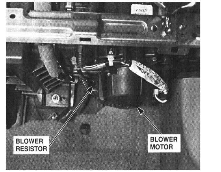

My car's AC only blows air in speeds 3 and 4, but it is not cold and only comes out from some vents. When I push the AC button, the light does not turn on so I never get cold air. Should I replace the blower motor, blower motor resistor, or blower motor switch?
Aug 25, 2020 at 2:02 PM
(Merged)
Good morning.
I attached a location of the blower motor resistor. It is the most common failure for the blower speeds not working correctly.
As far as the AC, that is a separate issue.
