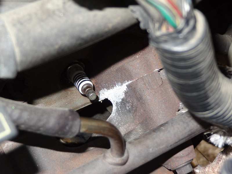

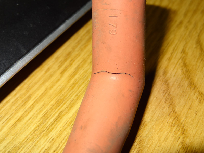

Hi saturntech9, Do you think the coil pack might be at fault? The cyl6 wire was shorting out for a long time before I started getting P0306. If I am getting spark at the no6 coil pack with a spark checker is it good or can the coil pack be a weak spark? If it sparks at all is it a good coil pack? If there's a spark problem on cyl6 should I also be getting cyl2 P0302 codes? Thanks Did you get the donation from Early January?

My main question is whether a constant shorting of the no 6 spark will damage the coil? From the images on my previous reply you can see the no6 was shorting to the ex manifold for quite a while. Thanks

Yes I got the other donation thank you. To check to see if the spark is strong enough take a old spark plug and see if your getting a nice blue spark not yellow or white?Did you replace that split boot?Also I want tell you if the coil is failing when it gets hot.Can you feel a miss at idle or driving down the road?What are the current codes since your latest repair?

I can't drive it since it's not registered. There is a bad miss at idle as though the cyl6 is not firing at all.I replaced all wires. I will check when hot and with a spare plug or my spark checker tool. Looking for blue spark right? Last codes were P0306 and P0174. I will recheck codes after I run it for a while. Thanks, Pete

Looking for blue spark keep me posted.
Feb 10, 2013 at 5:32 AM
I get steady blue spark attaching an old spark plug to no6 plug wire and ground. It was more blue at the center electrode than near the side post. When I turned the truck on it had code p0306. I cleared it and after running at 3300 rpm for a minute it flashed the mil and had code p0300.
