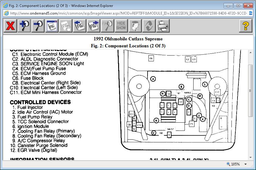

Looks like the none power wire has a partial ground somewhere.Unplug the computer and see if that ground is still there?

Its C1 in the diagram i posted.

Now I have no voltage across the connector, no ground on non power side, no continuity on non power side. So does that mean the computer is bad?
