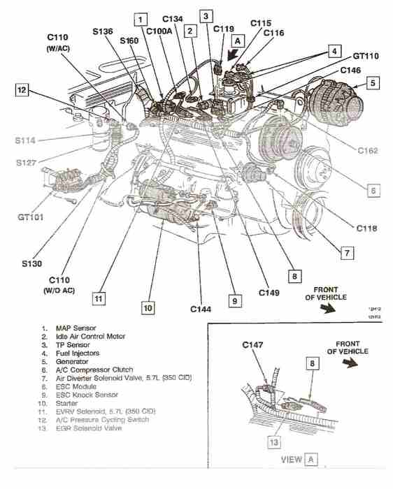

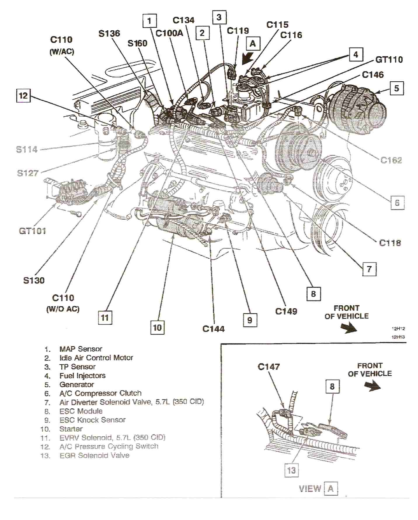

Ok, got the specs for timing 4 degrees BTDC with an automatic trans. You really need to get the timing light or borrow one from some buddy if you can't time it by ear. you have to start here. then go to the knock sensor because of the fuel.
Feb 18, 2012 at 11:03 PM
ok ty how can i tell if the knock sensor is bad
Feb 18, 2012 at 11:11 PM
It can be checked with an ohms meter, I believe it's something like 800 to 1200 ohms you can call AP store they'll help you with specs. too, if its close in that range it should be good. most cases they are good, I never seen a bad one unless it's broken. They cost almost $40 not cheap...

Work with the timing and knock sensor issue at hand and check to make sure the EGR Valve is working. The way to check it is to start the motor let it warn up fully, and rev the motor a little bit and see if the stem moves up and down through the slot on the side of the valve. Don’t put your finger through the slot to see if it moves or you will get burned "Very Hot"...
Feb 19, 2012 at 12:52 AM
i replaced the egr and the knock sensor hasnt been hooked up since i hve had it
Feb 19, 2012 at 12:59 AM
Come on we have been over this, I know you just replaced the EGR Valve and the Knock Sensor has not been hooked up...
Hook up the Knock Sensor and check the "NEW" EGR Valve to make sure it's working...

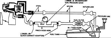

Just to give you some incite on that, a clogged injector(s) won't cause a under load ping, you may have more than one problem. If the TBI injector system has a clog somewhere it will cause a misfire condition which will cause a rough idle, one of your systems.
Now before you jump the gun on a clogged fuel injector you should know that if you don't have enough fuel pressure the injectors won't mist right and will drip. If you think your fuel pressure is low then try a little starting fluid while the motor is running if it picks up and starts to smooth out that maybe the trouble with the rough idle. You would need to do a fuel pressure test to make sure.

Well Like I said you should do a fuel pressure test to make sure, I wouldn't mess with that fuel injector that you say is dripping on idle unless you know you have good fuel pressure. And if you find you have good fuel pressure in specs not just a guess I would try fuel injector cleaner first, something like seaform good stuff from the AP store. If you find after this the injector is bad you would have to replace both of them in a set, they are not cheap, so don't guess here.
