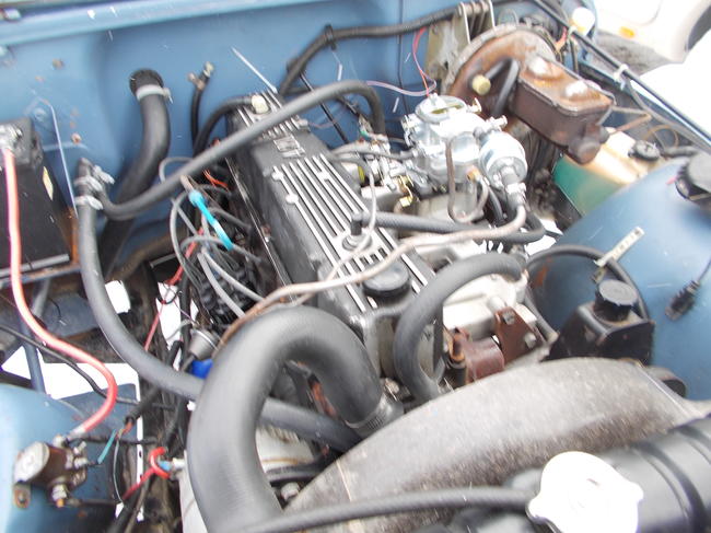

1981 Jeep CJ7 medic can you help me?
1981 JEEP CJ7

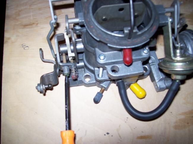

wish I was smarter about this digital picture business,

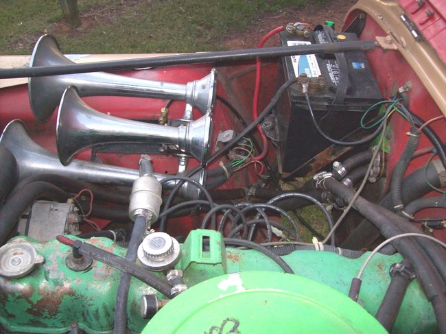

so the engine runs and it idles at around 700 maybe 650 and if I idle it down any more and the idle screw falls off the little cam the engine dies. so I screw it back in to where the idle screw just hangs on the end of the cam and it runs ok. then I backed off the curb idle screw to get the rpms as low as possible. I just duct taped the vacuum pipes coming out of the carburetor. have the pcv valve going to the brass fitting coming out of the intake manifold on its way to the egr valve. put the little hose on the egr valve to the little thing on the intake manifold with the 2 plastic pipes sticking straight up. then I put one of the front vacuum pipes on the carburetor on the same little valve with the 2 plastic pipes. the other vent from the rear of the valve cover just hangs out on the passenger side of the engine venting into the air. the 2 pipes on the front of the carburetor where the air horn is just don't have any hoses going to anything.

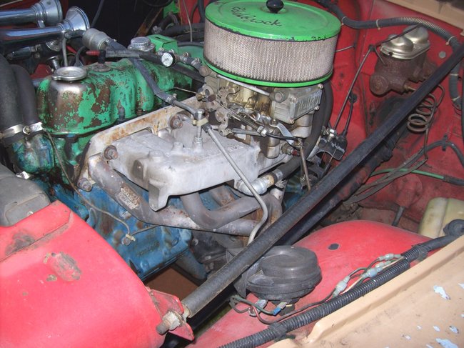

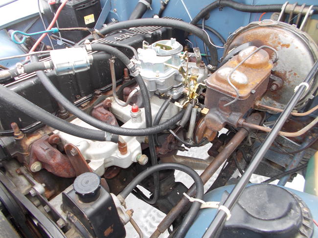

Feb 23, 2015 at 11:59 AM
DOIN' FINE
ONE PIC AT A TIME PER REPLY IS OK
YOU'LL LEARN HOW TO "RESIZE" LATER ON
SEND ME THREE MORE PICS
FROM THE DRIVER'S MIRROR (OR CLOSER) TO THE REAR AREA AROUND THE CARB
TWO SHOTS OF THE DRIVER'S SIDE OF THE ENGINE FROM OBLIQUE FRONT AND OBLIQUE REAR

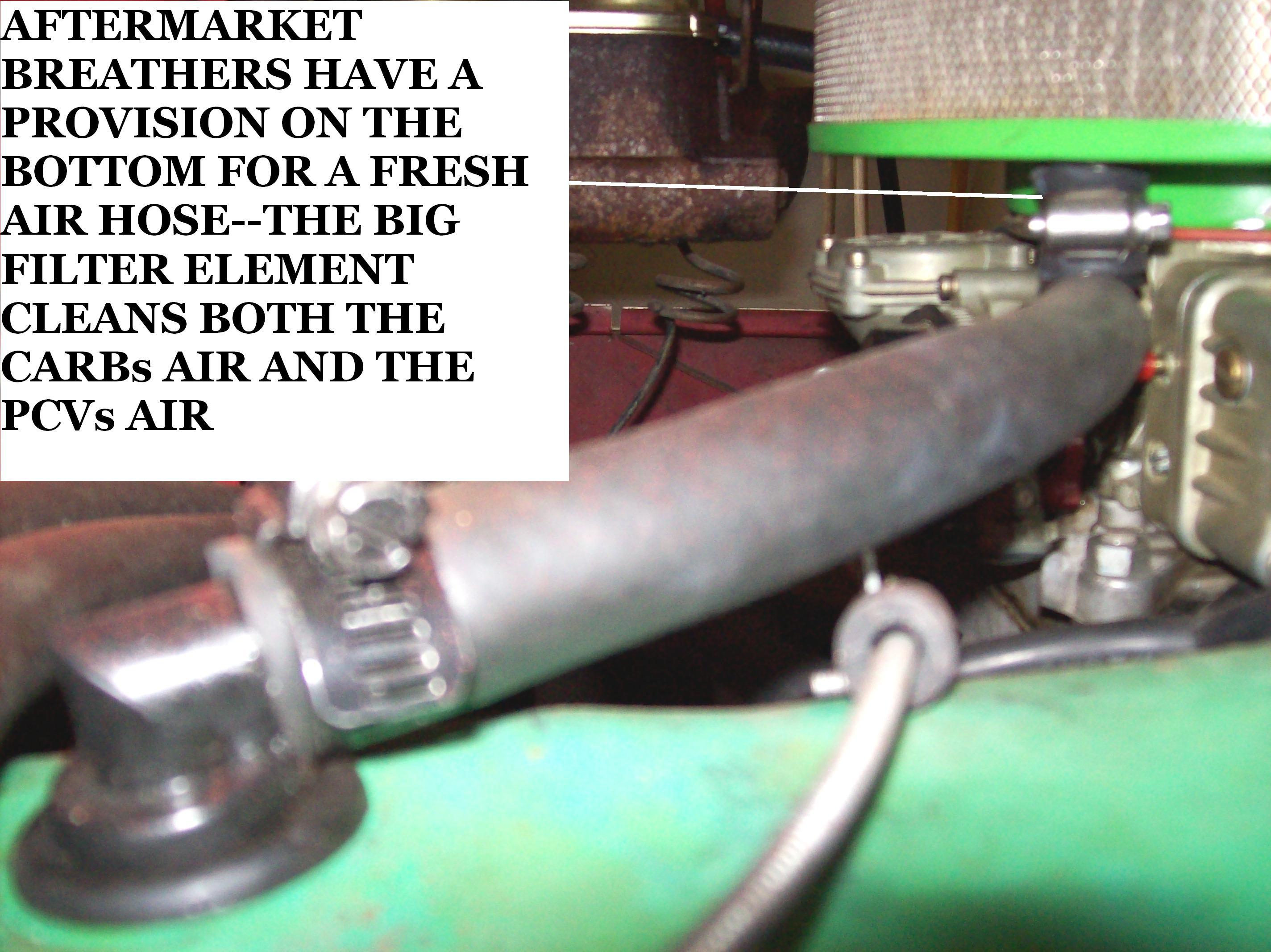

I'M GONNA CRITIQUE THE OTHER TWO PICS I HAVE

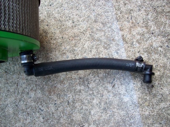

BELOW IS THE 1ST CRITIQUE
YOUR PIC/ MY AFTERMARKET BREATHER/ ORIGINAL BREATHER
I RECKON YOU KNOW TO CLICK ON MY PICS TO ENLARGE THEM
DID YOU SEE THE PICS WHERE I "RE-ROUTE" THE HEATER HOSES WITH TEEs TO GAIN MORE HEAT IN THE COCKPIT?
MORE CRITIQUES COMING - GO AHEAD AND SEND THE OTHER PICS, 1 PER REPLY
THE MEDIC
THE MEDIC

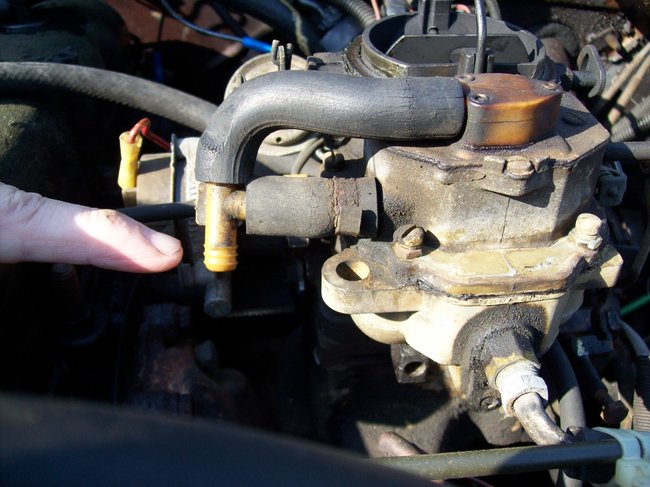

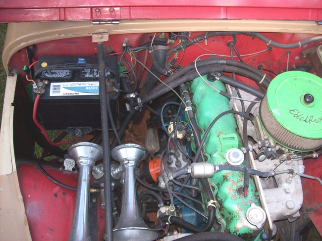

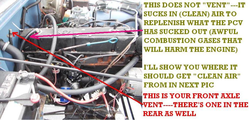

Feb 23, 2015 at 4:10 PM
THE "BAD" AIR FROM THE PCV IS SUCKED INTO THE CARB
THIS AIR IS "PART OF" THE 14.1/ 1 (CLOSE TO A PERFECT BURN) AIR/ FUEL RATIO
IF YOU "BLOCK" THE PCV SYSTEM'S AIRFLOW (FINGER OVER THE PCV), IDLE WILL SUFFER THE MOST.
INSTALLING A SECOND PCV VALVE IN FIREWALL END OF THE VALVE COVER WILL "CHECK" (IT'S SUCKING THE WRONG WAY THRU IT) THIS WOULD BE THE SAME AS CAPPING IT OFF
I HAVE TAKEN A PCV VALVE TO THE GRINDER AND GROUND THE LIP OFF, DROPPED ALL OF THE GOODIES OUT. DOING THAT, LEFT ME NOTHING BUT A HOLLOWED OUT ELBOW (WHICH CAN BE USED FOR THE FRESH AIR END, IF YOU CANNOT FIND AN ELBOW)
THE MAIN CONCERN WITH YOURS IS, IT'S SUCKING UNFILTERED AIR
A DIRT DAUBER CAN/ MAY HAVE ALREADY BUILT A MUD NEST IN THE OPEN END OF THE HOSE. (CHECK FOR THAT), AS IT IS BLOCKING AIR FROM EVENTUALLY GETTING TO THE CARB. THEN LET'S ATTACH THE HOSE THRU THE AIR CLEANER FOR FILTERED FRESH AIR.

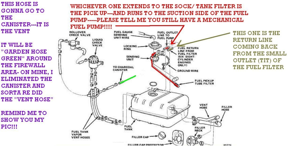

ABOUT TO WORK ON PIC #2
THE MEDIC

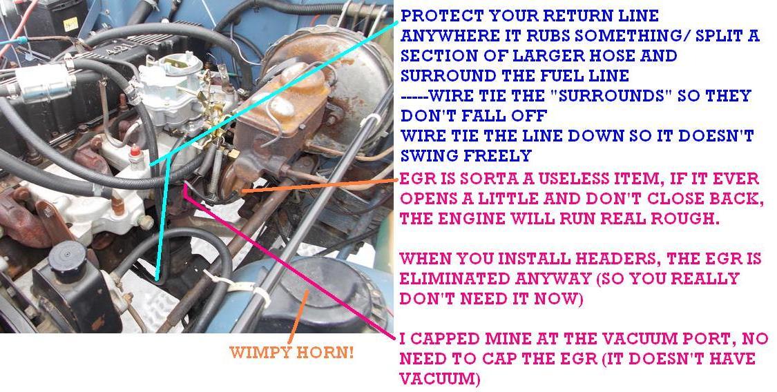

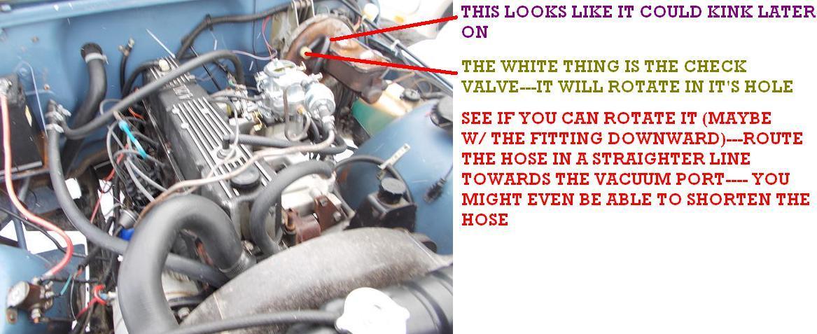

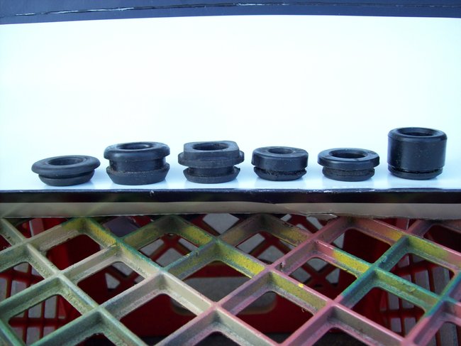

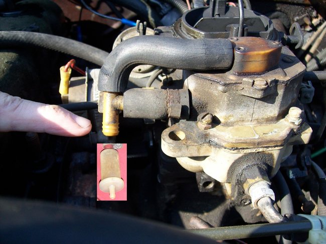

Feb 23, 2015 at 4:48 PM

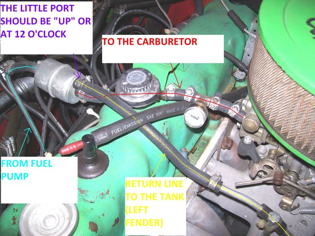

OK PIC 2
NEED THE OTHERS I REQUESTED!
WORKING ON PIC 3

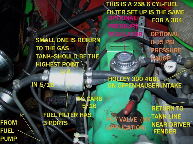

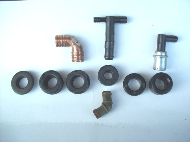

I HAVE FOUND THAT THE "NYLON RUBBERY VACUUM CAPS" (COLORED ONES) WORK THE BEST FOR CAPPING OFF STUFF. THE "REAL RUBBER CAPS" TEND TO ROT/ SPLIT/ FALL OF IN A FEW YEARS, THIS MAKES FOR A FUN "WHY AM I IDLING SO HIGH" OR "WHY AM I BOGGING DOWN", WHEN YOU ASSUME THE CAPS ARE STILL CAPPED!
SEE THE CAPS ON MY CARB, NOTE: THE BOTTOM LEFT BLACK ONE IS THAT OLE EVIL RUBBER KIND!
2ND BEST TO NYLON IS A SHORT PIECE OF FUEL LINE WITH A SMALL BOLT SHOVED TIGHT INTO IT (FUEL LINE IS BETTER THAN VACUUM LINE, AS FAR AS "HOLDING UP" OVER TIME
THE MEDIC

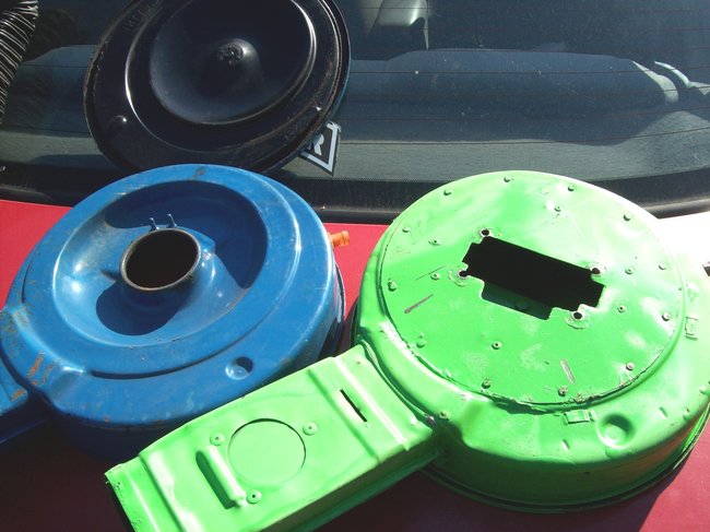

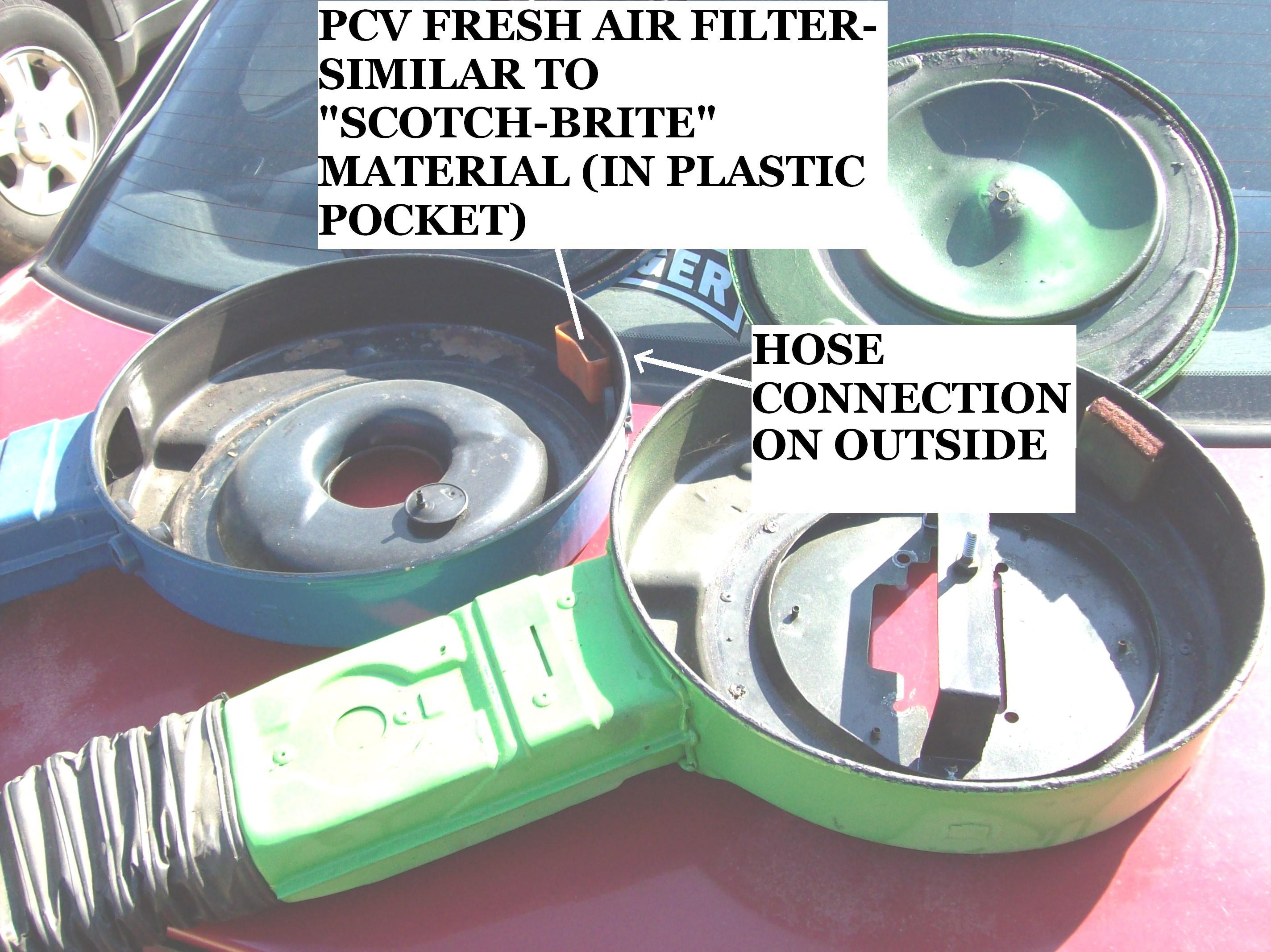

Feb 23, 2015 at 5:33 PM

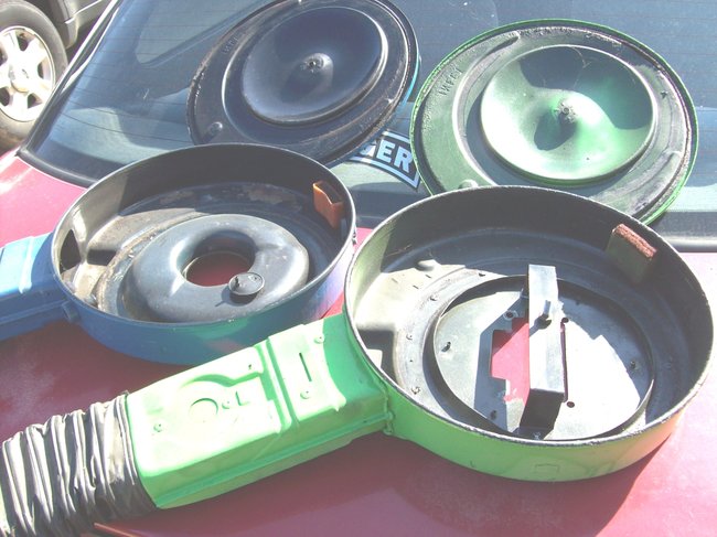

ok medic,
so I need a new air filter housing with a hose connection from the rear valve cover opening to the air cleaner through another filter inside the housing. that hose on the rear of the valve cover smokes a lot so I thought that was venting. so ill find another housing to get that hose connected. maybe the guys at the corner parts house can help me find one. the ship came with just a small round housing for the round element with no provision for any other hoses. i'll get that project next, thanks
IF YOU GET ANOTHER AIR CLEANER
GO WITH A SIZE THAT FITS A 2-5/8 INCH CARB
I MEAN OUT OF THE BOX FITS METAL TO METAL!
SOME PLACES HAVE LIKE A 4 INCH (OR OTHER) OPENING IN WHICH THEY WANT YOU TO USE A CRAPPY PLASTIC ADAPTER/ REDUCER TO MAKE IT FIT YOURS. THIS IS JUNK! HEAT WARPS IT AND YOUR CLEANER SINKS ON ONE SIDE
IF YOU CAN FIND AN ALUMINUM/ POT METAL REDUCER IT IS SO MUCH BETTER (THIS WAS THE STANDARD BACK IN THE 70's AND 80's)
BUT AS BEFORE--THE BEST-US KIND IS ONE THAT FITS PERFECT WITH NO REDUCER
MANY COME WITH A FITTING, AND YOU "KNOCK OUT" THE KNOCK OUTS ON THE BOTTOM SIDE THEN BOLT THE FITTING ON.
ALSO IF YOU HAVE CHOICES, PRICE THE REPLACEMENT FILTERS FOR EACH CANDIDATE, THIS WILL SAVE YOU MONEY AT REPLACEMENT TIMES!
THE INTERNET MIGHT BE A GOOD PLACE TO SHOP?
STILL GOTTA DO PIC 3!
THE MEDIC

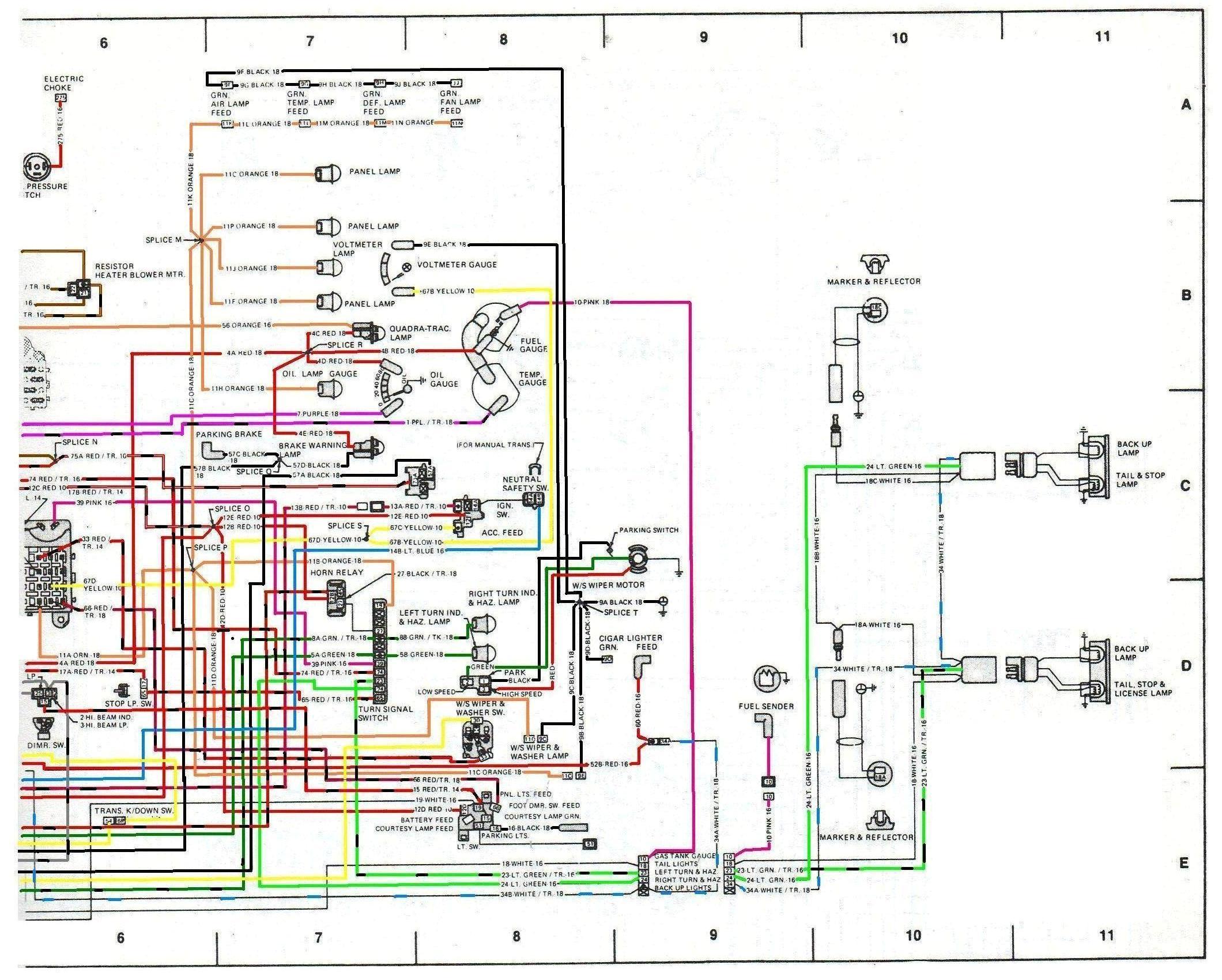

WANNA COPY A PIC OFF OF HERE?
RIGHT CLICK ON THE LITTLE PIC
CHOOSE/ LEFT CLICK "OPEN LINK IN INCOGNITO WINDOW" OUT OF THE CHOICES
THE WINDOW SHOULD POP UP W/ THE PIC, NOW AT FULL SIZE
GET ON TOP OF IT AND RIGHT CLICK
CHOOSE/ LEFT CLICK "SAVE IMAGE AS"
ANOTHER BOX WILL POP UP
AT THE TOP- I CHOOSE "MY PICTURES" (OR ANOTHER DESTINATION, IF WANTED, JUST STICK W/ MY PICTURES!)
AT THE BOTTOM NAME THE PIC WITH IT'S OWN UNIQUE NAME OR NUMBER (LIKE CJ MED101, CJ MED102, ETC) THEN LEFT CLICK "SAVE"
THE PIC IS NOW YOURS (SAVED IN "MY PICTURES" ON YOUR COMPUTER)
DEPENDING ON YOUR COMPUTER, YOU CAN "EDIT" THE PIC (DARKEN, BRIGHTEN, CROP, ETC) MAKE IT BIGGER, SMALLER, FLIP, ENLARGE, PRINT, ETC

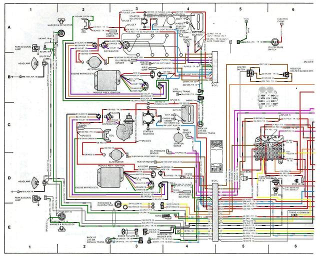

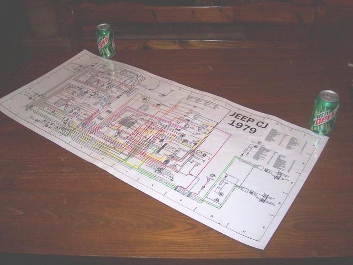

FOR INSTANCE, I TOOK A 1979 WIRE DIAGRAM (2 PAGES)
1979 WAS A GOOD YEAR IN THAT MOST OF THE BASIC (NON-COMPUTER) WIRING IS ABOUT THE SAME FROM '76-'86 (THE LATTER OF THOSE YEARS HAD A COMPUTER)
THIS DIAGRAM IS LIKE A MAP BETWEEN ALL OF THE ELECTRICAL PARTS, NEWER DIAGRAMS ARE LIKE FLOW CHARTS (EACH TYPE HAS IT'S OWN ADVANTAGES) I LIKE "THE MAP" MYSELF
I TOOK THEM TO THE "MICROSOFT PAINT" PROGRAM (SORTA PRIMITIVE) AND I COLORED EVERY WIRE TO THE BEST OF MY ABILITY TO THE CORRECT COLOR IT REALLY IS.
THE COLORS ARE LABELED SOMEWHERE ON THE WIRE
IF IT HAD A "TRACER" OR "STRIPE ON A WIRE (THE TRACER COLOR WAS NOT NOTED) EXAMPLE : DK.BLUE W/ TR 18 ( I COLORED THE WIRE DARK BLUE AND DOTTED THE WIRE W/ BLACK DASHES TO DISTINGUISH IT ("18" BEING THE GAUGE OF THE WIRE)
OF COURSE A "WHITE WIRE" IS A THIN BLACK LINE (WHITE IS NOTED SOMEWHERE ALONG IT)
IN PLACES, INFORMATION IS CRAMMED IN THERE, YOU MIGHT NOTICE THE BREAK IN THE WIRE IS INFORMATION, THE WIRE WOULD ACTUALLY TRAVEL ON THRU THE INFORMATION
FOR THE MOST PART, YOU CAN FIGGER IT OUT!
I EMAILED THE 2 HALVES TO AN OFFICE STORE
THEY ENLARGED IT QUITE A BIT
I ASSEMBLED THE 2 HALVES (THE JOIN, IS THRU THE FUSE BOX AREA)
THE RIGHT SIDE ON TOP (OVER THE OVERLAP) IS THE BEST FIT
I THEN HAD 'EM LAMINATE IT
(ALL FOR ABOUT $15-$20)
HERE'S MY GARAGE VERSION AND THE 2 PIECES

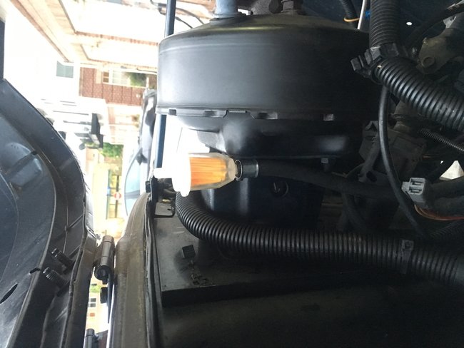

Feb 24, 2015 at 6:05 PM
Sorry to jump on an old post, but what exactly are you using here for the fuel tank vent instead of the charcoal vapor canister?

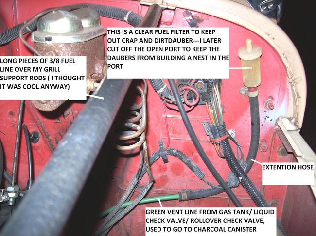

OK I MISSED WHERE YOU JUMPED ON, GLAD YOU DID!
HERE'S OUR MESSAGE YOU SENT
IF YOUR EMISSIONS ARE CHECKED IN YOUR REGION, MY DEAL JUST AIN'T GONNA FLY!
NOT CHECKED OR DEEMED TOO OLD TO CHECK
MY WAY WORKS JUST FINE OUTTA THE TANK AND ON THE CARB THE VAPORS ARE SUCKED INTO THE CANISTER VIA A VACUUM LINE WITH THE ELIMINATION OF THE VACUUM LINE, NUTHIN' REALLY GETS SUCKED THRU IT.
HOWEVER THE GREEN GARDEN HOSE COLORED HOSE (FROM THE TANK) DOES NEED TO BREATHE (AS WELL AS THE BOWL VENTS ON THE CARB).
THE GARDEN HOSE COLORED ONE IS FROM THE TANK, BEFORE IT GETS UP FRONT (IN THE REAR FENDER) THERE IS A LIQUID CHECK VALVE (FOR SPLASHING GAS) AND A ROLLOVER CHECK VALVE (IN CASE YOUR ROLL OVER)
THESE REMAIN OPEN TO VENT THE TANK, UNLESS: LIQUID TRIES TO COME OUT/ OR YOUR RIG IS UPSIDE DOWN!
MY FUEL FILTER DEALEE WAS EXTENDED UP WITH A PIECE OF FUEL LINE AND A CLEAR FUEL FILTER (TO ALLOW IT TO BREATH/ TO KEEP THE DIRT DAUBERS (BUGS) OUT OF MY LINE
IF YOU HAVE A CARTER BBD, I SIMPLY ADDED ANOTHER FUEL FILTER JUST BELOW THE "TEE" IN THE BOWL VENT LINES. HENCE I HAD 2 BREATHING FILTERS, ELIMINATED A FEW LINES AND MY CRUMBLING CANISTER.
SINCE THEN I HAVE ADDED A HOLLEY 390 CARB AND A OFFENHAUSER 4 BARREL INTAKE TO MY 258. (18 MPGs KICKING AROUND/ POWER IF I GET ON IT!) THAT ELIMINATED THE BOWL VENT FILTER.
I STILL HAVE THE OTHER. NO FUEL SMELLS AT ALL IN THE COCKPIT
I HAVE ALSO FOUND THAT EXHAUST STRAIGHT OUT THE BACK JUST ROLLS BACK IN (DRAFT SUCTION FROM THE BODY), SO I KICKED MINE OUT THE SIDE RIGHT BEHIND THE REAR TIRE, MOST OF IT DOES NOT CIRCULATE BACK IN.
FEEL FREE TO CREATE A FREE QUESTION AND ASK FOR ME OR SIMPLY JUST JUMP ON BOARD OF A POST I HAVE ANSWERED (I WILL GET AN EMAIL NOTIFIER), THIS WILL ALLOW OTHERS READING IT TO FIGGER THEIR STUFF OUT TOO, AND WE WILL BE ABLE TO POST PICS TOO!
I DO APPRECIATE YOU CONTACTING ME, KINDA LETS ME KNOW MY PECKING AIN'T ALL IN VAIN! THIS AID AT ALL? THE MEDIC
### Hi Medic, I noticed in a previous post that you are using some sort of clear fuel filter for the vent line coming from the tank instead of the charcoal vapor canister. How exactly does this work? My charcoal canister is shot and when I removed the lines from it and plugged the vacuum hoses, I have a bad fuel smell in the cab of my cj7. As finding another vapor canister is almost impossible and $$$, I am looking for other options. Does your little fuel filter keep the gas smell out of the cab? Thanks!
PICS
1) GREEN HOSE/ FUEL FILTER FOR BREATHING
2) THIS IS WHERE I ADDED THE OTHER FUEL FILTER WHEN I HAD A BBD/ IF YOU PLUG THESE VENTS, WHEN YOU SHUT OFF THE ENGINE, THE FUEL SORTA BOILS OUT OF THE CARB ALL OVER THE ENGINE
3) NOTE: MY EXHAUST BLOWS OUT THE SIDE, NOT THE BACK
YOUR TURN
THE MEDIC
PICS
YOUR TURN

Thanks for your response Medic.
to follow up, passing emissions is not an issue for me. I have a weber 32/36, have done the nutter bypass, and currently have the EGR blocked off. Off my weber I have the ported vacuum going to the distributor, and my PCV connects to the front base plate of the weber. The manifold vacuum is connected to my brake booster, and all other vacuum lines are blocked off. The carb bowl vent is open to the air. This is when noticed two things: an increased smell of gas in the cabin, and also it was a little more difficult to start the jeep.
I thought about hooking the canister back up, but I am not sure if my canister is leaking vacuum, in addition, upon removing it, its hard as a rock and I cannot feel any loose charcoal move it in. I assume that its now one solid rock of charcoal, and probably not effective anymore anyway.
As it seem almost impossible to find a new canister, or its pretty darn expensive, I am now looking at other options to include bypassing the canister all together. In my setup, I assume that I can use the glass fuel filter coming from the tank and mount this to the firewall. How does this really work? Does fuel in the glass bowl keep the fumes from escaping, but allow it to when/ if it builds up pressure? Should I loop the carb bowl vent back onto the base of the weber airfilter so that any fumes simply get put right back into the top of the car to be burned? Is anything else required in my setup?
Thanks in advance. (From what I have read so far, you are a huge asset to folks out here!!!)

May 2, 2016 at 7:21 AM
NOTHING COMPLICATED AT ALL
THE ONLY THINGS THAT WILL OCCUR IS
1) FUEL TANK EXPANSION MAY PUSH A FEW FUMES OUT (REMEMBER, THERE AIN'T NO SUCTION ACTION AS WAS WITH THE CANISTER AND IT'S VACUUM LINE) FILLING UP WITH FUEL MIGHT PUSH SOME OUT AS WELL
2) TANK CONTRACTION AND FUEL USAGE MIGHT SUCK IN AIR THRU THE VENT LINE
3) THE FILTER ON THE END IS A CHEAP $3 PLASTIC VOLKSWAGEN TYPE FILTER, IT IS "DRY", ALL IT DOES IS KEEP TRASH AND BUGS OUT OF THE LINE, WHILE ALLOWING AIR TO PASS BOTH WAYS.
WHEN I HAD A BBD CARB, I INSTALLED THE SAME KINDA FILTER ONTO THE BOTTOM OF THE PLASTIC TEE IN MY PIC
I NEVER TRIED SUCKING IT BACK THRU THE CARB (OR VACUUM PORTS), THAT WOULD BE ONE MORE LINE TO MAINTAIN OR TAKE LOOSE TO GET THE BREATHER OFF, OR IF ON A PORT, IT WOULD PROBABLY MAKE THINGS RICHER
IN DOING THESE MODIFICATIONS, I'VE NEVER HAD A FUEL SMELL ISSUE
OTHER PLACES TO LOOK FOR FUEL ESCAPING IS ALONG YOUR RETURN LINE TO THE TANK
AND OF COURSE, WHEN IN MOTION, SWIRLING EXHAUST COMING BACK INTO THE JEEP

May 2, 2016 at 4:39 PM
Thanks for the additional info and links. I have done quite a bit of research (who knows how many hours/days...) but only stumbled upon this site the other day. I have already started to read some of the previous posts, and its giving me some good ideas/knowledge! I will have to finish the articles after work though....
My exhaust already comes out just behind the rear tire, but I still need to check for gas line leaks along the return line (which I assume you're referring to the 2nd line off the main fuel filter, right?)
Regarding the VW filter, do you happen to have a part# that I could grab from you?
Also, is there still a need to run the fuel vent line all the way from the tank to above the canister? Can you just mount the line and VW filter high in the rear wheel well, as long as its after the roll over valves?? (Sorry, I haven't checked myself yet)?
THANKS!!!

May 3, 2016 at 7:19 AM
THE REASON I MOUNTED MY VENT/ FILTER HIGH WAS FOR THAT "JUST IN CASE" POSSIBILITY THAT THE CHECKS IN THE DRIVER'S SIDE REAR FENDER LEAKED OR FAILED (DUE TO AGE). I FIGGERED THAT IN BOUNCING AROUND/ CLIMBING/ TILTING SIDEWAYS ON AN INCLINE, FUEL WOULD HAVE TO CLIMB HIGH UP IN THE VENT TO GET OUT. THE OTHER REASON BEING IF I DID GET IN DEEPER WATER, WATER WOULD HAVE TO BE ALMOST UP TO THE HOOD BEFORE IT COULD SEEP INTO THE VENT.
WHATEVER YOU DO, DEFINITELY GO ON THE OUTLET END OF BOTH CHECKS (TANK, THEN CHECKS, THEN THE VENT
I SORTA GOT MY FEEL DOING THE EXTREME KINDA STUFF WITH CJ-5s 1-5 WHEN I WAS A BIT YOUNGER. I DO KNOW EXACTLY WHAT A PRETTY MUCH STOCK CJ-5 CAN AND CAN'T DO! IF THE NEED EVER AROSE, I COULD PUSH THE LIMITS WITH "MR. JEEP" ('77 CJ-5) OR "WILLY" (MY '46 WILLYS)
HOWEVER, I WILL SOMETIMES CLIMB, DESCEND OR GET THE RIGHT OR LEFT SIDE HIGHER, BUT MORE OF A GENTLE BUNNY SLOPE KINDA WAY. I AVOID MUD, BUT IF IT'S THE ONLY WAY TO GO, TO GET TO MY DESIRED DESTINATION, I'LL GO THRU IT! BUT KEEP IN MIND, I DON'T JUST DIVE IN, I FIND THE EZ WAY THRU IT.
HERE'S THE FILTER, I LIKE IT BECAUSE IT'S CHEAP AND YOU CAN CHOP IT OFF (THE ENDS ARE STEPPED FOR DIFFERENT SIZES). I USE 'EM FOR DIFFERENT THINGS, ONE WAY BEING, ADD A FUNNEL AND SOME TUBING AND YOU CAN STRAIN GAS OUT OF A DIRTY CAN. YOU CAN USE ANY FILTER WITH THE RIGHT SIZED NIPPLES
http://shop.advanceautoparts.com/p/bosch-fuel-filter-e100033434bos/10809890-P?searchTerm=fuel+filters

PICS BELOW
1+2) JEEP OEM FUEL SET UP (THE REGULATOR AND MINI FUEL PRESSURE GAUGE ARE "BELLS AND WHISTLES" I ADDED ON, I ALSO BENT NEW STEEL LINES TO DRESS IT UP SOME)
3) FUEL TANK DIAGRAM
4) THE FILTER AND PIPE EXTENSION I ADDED (I SHOW IT AGAIN TO GO WITH DIAGRAM 3, FOR OTHERS WHO MIGHT SEE THIS)
YOUR TURN-KEEP DISHING OUT THE QUESTIONS! OR REMIND ME OF ANY I DID NOT ADDRESS.
THE MEDIC

BLOW BY?
I HOPE YOU HAVE LITTLE
THAT REAR HOLE IS FRESH AIR TO BE SUCKED INTO VALVE COVER/ INTERNAL ENGINE.
IT REPLENISHES THE CONTAMINATED AIR/ WATER VAPOR/ COMBUSTION GASSES (BLOW-BY) THAT, IF LEFT IN THERE, WILL CORRODE THE METAL PARTS INSIDE
IF I REMOVE THE REAR HOLE ELBOW AND PUT MY THUMB ON THE HOLE, (IF ALL IS "IDEAL") WITH THE PCV SUCKING (NORMALLY) MY ENGINE WILL BEGIN TO LOSE RPMs (STARTS DYING DOWN)--AS THE PCV (EVEN THOUGH IT'S SUCKING BAD GASSES) PROVIDES THE CARB/ INTAKE WITH PART OF THE "COMBUSTION AIR" IT NEEDS TO PRODUCE BEST AIR/FUEL MIX IT CAN.
WHEN THE ENGINE NOW RUNNING KINDA BAD, I REMOVE MY THUMB, AND I HEAR A BIG RUSH OF AIR SUCK INTO THE REAR HOLE. THE ENGINE IS RUNNING PERFECTLY AGAIN!
IF THIS DOES NOT OCCUR, EITHER YOUR GASKETS ON THE ENGINE BLOCK (VALVE COVER AND OIL PAN, EVEN A REALLY BAD REAR MAIN OR TIMING COVER SEALS) ARE SUCKING AIR OR YOU HAVE A LOT OF PISTON BLOW-BY. USUALLY ANY BLOW-BY IS SEEN PUMPING A LOT OF SMOKE OUT OF THE REAR VALVE COVER HOLE
USING THE INCORRECT PCV MIGHT ALLOW TOO MUCH OR TOO LITTLE AIR, AS WELL AS PLUGGING IT OFF, CRIMPING THE LINE. THE LACK OF THIS AIR WILL MIGHT NEAR MAKE IMPOSSIBLE TO SET YOUR MIX SCREWS CORRECTLY.

Regarding the carb bowl vent, should I attach a line and filter from the carb to along the firewall that is inline with the filter from the tank? I imagine that you would want to keep this filter in a vertical position to serve its purpose...

NICKED THE "CRANKSHAFT" THE REAR MAIN SURROUNDS IT
THE PIC I SHOWED THE CARB BOWL VENT HOSES (TEEed) TOGETHER AND ONE OF THEM FILTERS HOOKED ON TO THE BOTTOM OF THE TEE. ORIENTATION DOES NOT MATTER, FUEL DOES NOT COME OUT OF THESE HOSES, IT JUST NEEDS TO BREATHE.
IF YOU CAP 'EM OFF, WHEN YOU STOP DRIVING AND SHUT IT OFF, THE INABILITY TO "VENT" WILL MAKE THE BOWL SORTA BOIL OVER AND RUN OUT OF ANY OPENING (NOT ONLY A BIG FUEL SMELL, BUT A FIRE HAZARD TOO!)
I RECKON YOU COULD TIE THE BOWL VENTS TO THE FUEL TANK VENT, JUST REQUIRES MORE HOSE, A TEE, AND THAT'S JUST ONE MORE HOSE TO MAINTAIN AND CLUTTER THE COMPARTMENT!
WHEN I GET HOME, I'LL SEE IF I CAN TAKE PICS OF THE VENT HOSE ROUTING FROM THE REAR TO THE FRONT

Back to the carb bowl vent, on my 32/36 Webber, basically off the front corner I would attach a small piece of line, and then the fuel filter correct? So I guess it doesn't matter if the filter is horizontal or vertical here right?

FORGOT YOU HAD THE WEBER
I'M PRETTY SURE THERE IS NOT A BOWL VENT PORT ON IT
SO YOU PROBABLY AIN'T GOTTA WORRY ABOUT IT!

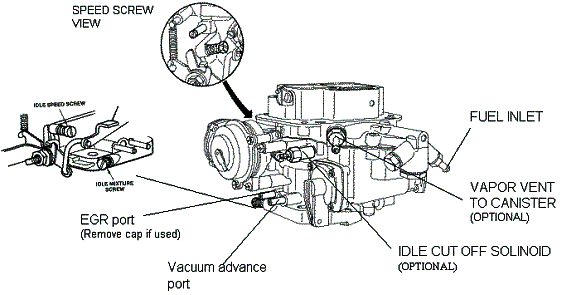

THOSE DIAGRAMS I SENT WERE FOR THE CARTER 2 BBL BBD, MY HOLLEY 390 DOES NOT HAVE A PORT FOR THE BOWL TO VENT EITHER
THE MEDIC

IT MAY BE THAT YOU ARE GETTING MORE BLOW-BY ON THE PISTON RINGS THAN THE PCV CAN SUCK OUT.
HERE'S SOME PICS OF DIFFERENT GROMMETS
