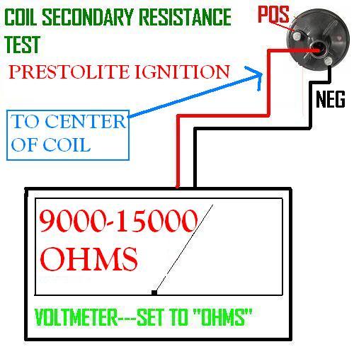

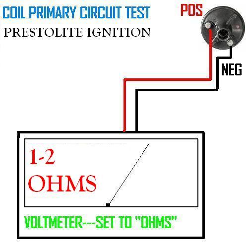

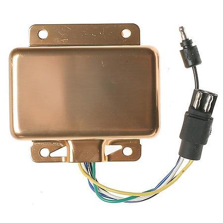

3) DO THESE TESTS OF THE COIL--WANNA MAKE SURE YOU HAVE THE RIGHT ONE------SEE PICS 1 AND 2.........YOUR VALUES?

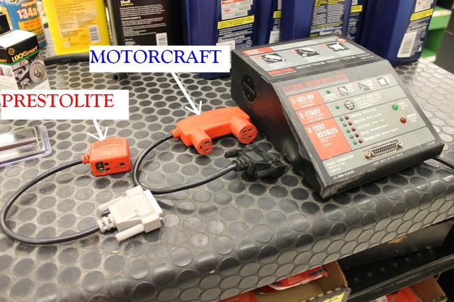

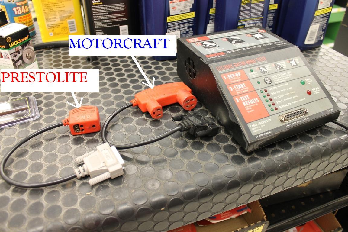

4) TAKE YOUR IGNITION MODULE TO AN AUTO PARTS STORE---IN MY PIC, THIS IS THE "MACHINE" THAT TESTS MODULES AT "ADVANCE AUTO PARTS". THE CONNECTORS IN MY PIC (LEFT) IS FOR PRESTOLITE (RIGHT) IS FOR MOTORCRAFT..............TEST THIS PUPPY OVER AND OVER 5-8 TIMES, IF IT FAILS ONCE, REPLACE IT............TEST THE NEW ONE THE SAME WAY BEFORE YOU LEAVE THE STORE ........INSIST!
