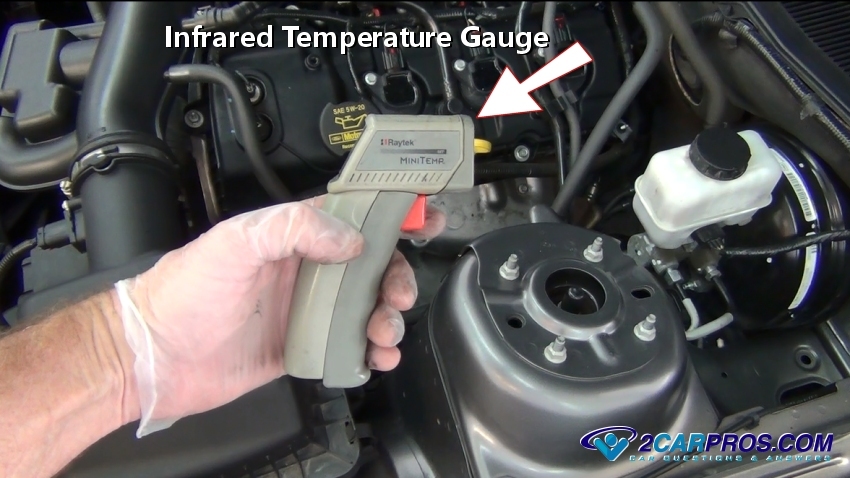

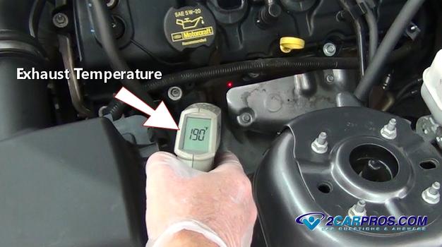

 If no service light is triggered with a steady misfire, use an infrared thermo gun to test the exhaust temperature of each cylinder.
infrared temperature meter
Start the engine cold, quickly take a reading at the front of each cylinder's exhaust port on the manifold while maintaining similar placement of the beam over each individual port, a misfiring cylinder will be considerably colder than the remaining cylinders. Example: Three of the exhaust ports test at 190 degrees while one is at 81 degrees, the cylinder at 81 degrees is misfiring.
exhaust termperature

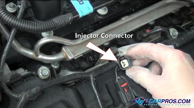

If no results are yet gleaned, start the engine and allow to idle, remove the fuel injector electrical connector on each cylinder one at a time while observing the engine performance, if no change is observed at a particular cylinder, the misfiring cylinder has been located.
injector connector

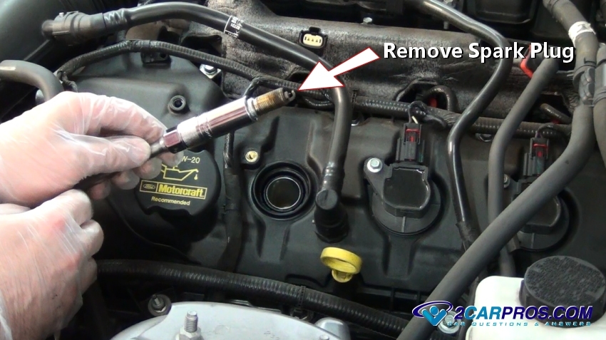

Once the misfiring cylinder has been located, remove the spark plug for inspection, before removing the spark plugs, mark the plug wires (if equipped) to identify their positions in the firing order, this will help for proper reassembly.
remove spark plug

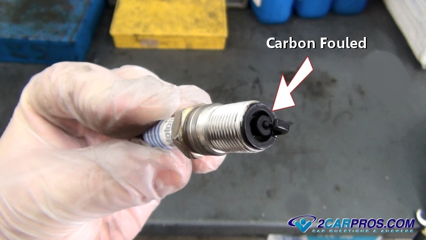

 When a cylinder runs rich it will carbon foul the spark plug causing it to short circuit. Malfunctions for this condition include partially plugged fuel injector or catalytic converter, low compression, failed fuel pressure regulator and excessive fuel mixture.
carbon fouled spark plug

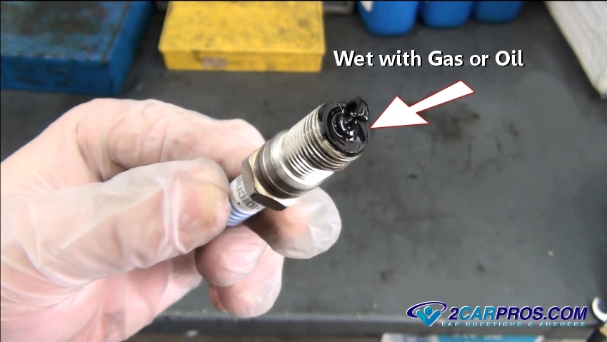

A wet spark plug with gas or oil can mean a fuel injector is stuck open, fuel regulator has failed, no cylinder compression, broken piston oil control ring, blown head gasket or excessive leakage from the valve stem seals.
spark plug fouled oil gas

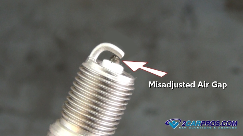

A spark plug must be properly gapped with a specific measurement from the electrode, a misadjusted air gap can result in a misfire.
misadjusted spark plug air gap

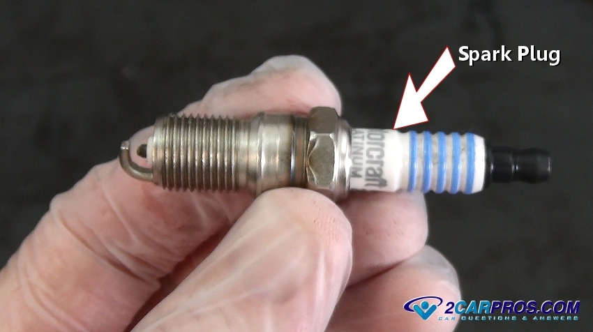

Using a proper spark plug with a correct air gap will help ensure operation of the ignition system.
spark plug

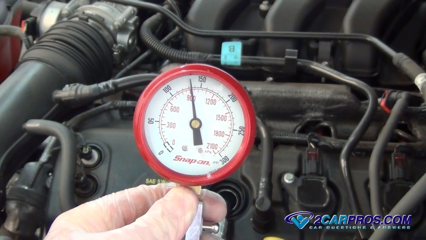

If the spark plug is wet with fuel or carbon fouled upon removal, a compression check is needed, perform a cylinder compression test to locate a mechanical failure. If compression is low, it could mean worn out or broken piston rings, flat camshaft, broken valve spring, burnt or leaking intake or exhaust valves, dropped valve seat or blown head gasket.

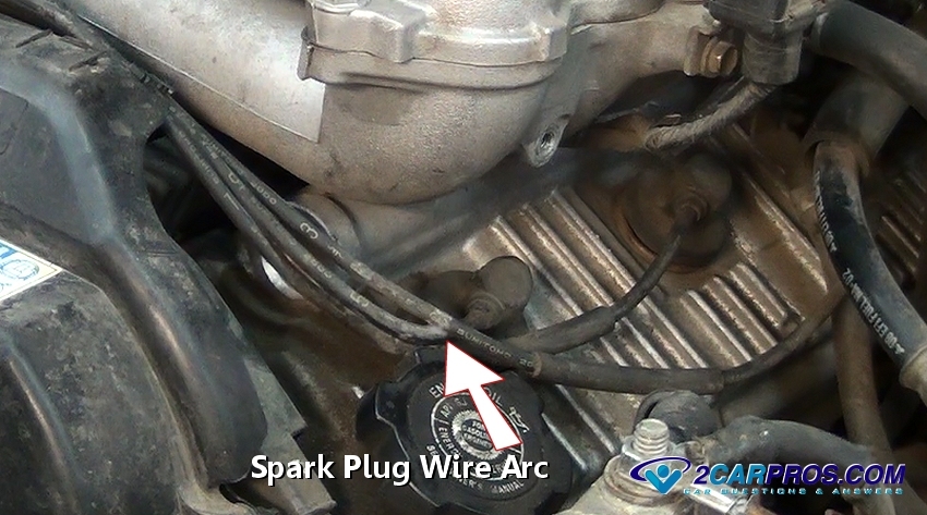

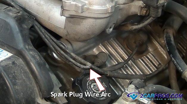

Spark plug wires are designed to transfer an electrical charge from the coil to the spark plug, when these cables wear, they can short circuit causing a misfire./
spark plug wire arc

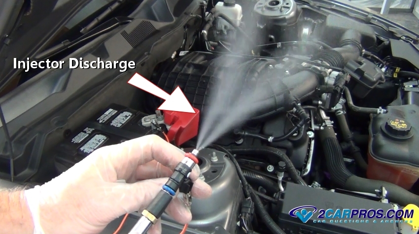

A fuel injector regulates the amount of fuel which is consumed by the engine, if the injector operation has failed the cylinder will misfire.
injector discharge

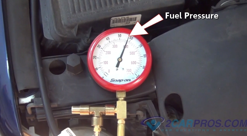

Fuel pressure must maintain a constant pressure, if this flow is impeded by a clogged fuel filter or weak fuel pump the engine can produce a random misfire.
proper fuel pressure

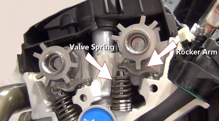

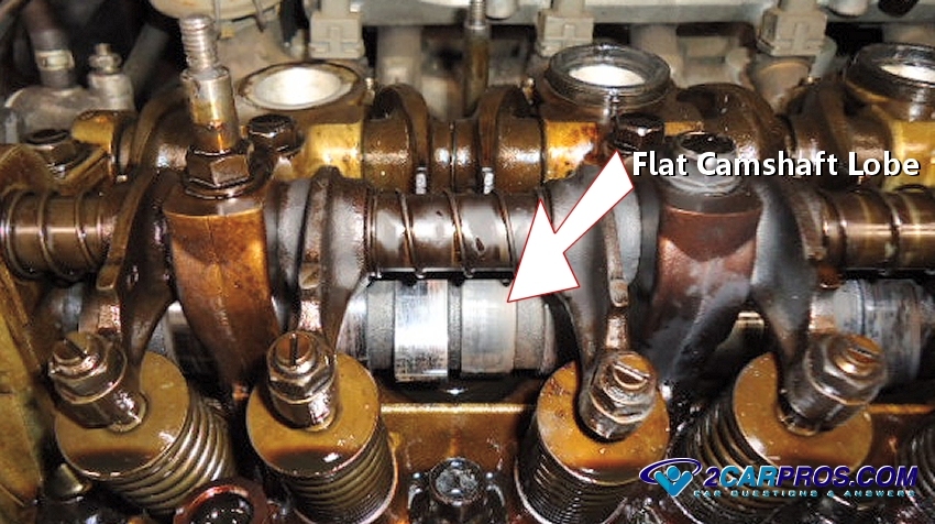

Each intake and exhaust valve utilizes a spring which will return the valve to its original position (closed). If a valve spring has broken or a cam lobe has worn down, it will cause the engine to misfire and run rough due to the loss of compression. These conditions don't always show up in a compression test, because a compression test is performed at engine cranking speed. If a camshaft lobe is halfway worn down, it will show up only when the engine is running and under load.
flat camshaft lobe
 In some conditions a broken valve spring can effect different aspects of engine performance for example: If just a small part of a coil breaks off, the spring can still close the valve but only at low RPM's, causing a high RPM misfire. If the spring breaks somewhere in the middle it will affect both idle and power conditions. To test for this condition, remove ignition coil connector or ignition system or fuel pump fuse to disable the engine from starting. Remove valve cover(s) to gain access to visually inspect the valve train. Inspect the condition of the valve springs, use a flashlight and small mirror to aid in the inspection. Have a helper crank the engine over while observing rocker arms and cam lobes, confirming full movement, if one or more lobes are traveling less than the others the camshaft has a flattened lobe and replacement is required.
valve spring rocker arm
