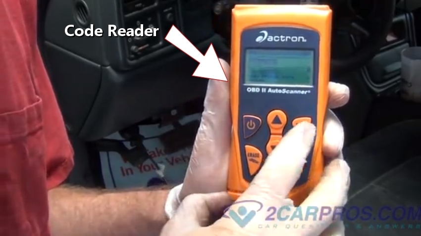

Step 1 - If a malfunction has occurred that the computer has realized, the check engine or service engine soon light will be illuminated. First read the trouble codes and then define them to determine the repair needed. Many times an engine can hesitate without the computer detecting a problem, if this is the case proceed to the next step.
code scanner

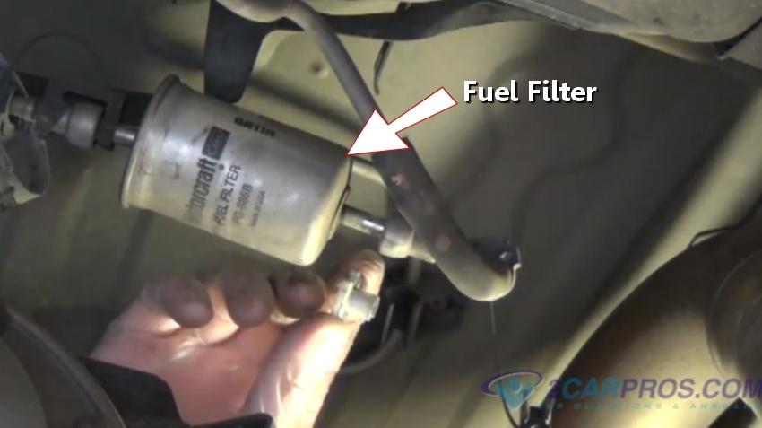

Step 2 - Poor fuel pressure can cause the engine to go "lean" when the throttle is opened. The first check is to remove the fuel filter and check the flow by trying to blow through it, the filter should flow freely.

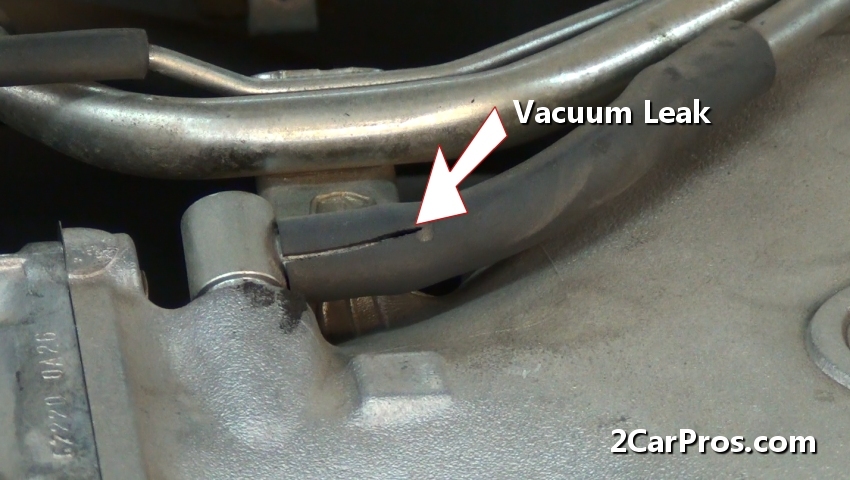

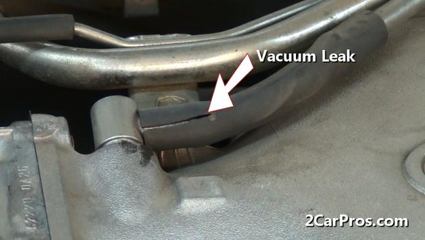

Step 3 - The engine depends on a sealed system to contain vacuum the engine creates while running. If this vacuum system develops a leak it can cause the computer to react on false data resulting in a hesitation. Inspect the system and repair any vacuum  lines that are damaged.
vacuum leak

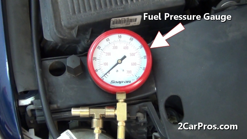

Step 4 - The engine's fuel system must operate at a specific pressure, if this pressure is inadequate the engine will hesitate. Locate the fuel pressure test port or use a fuel filter adapter to connect a fuel pressure gauge and check the reading.

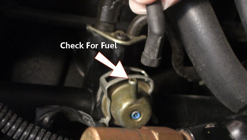

Step 5 - The fuel system pressure regulator is designed to increase the fuel pressure when the throttle is depressed. This pressure increase is used to enrich the fuel mixture when the engine is under load. Though some vehicles utilize an internal regulator located at the fuel pump (in tank) others are located at the engine fuel rail which can be tested much easier.
check for fuel

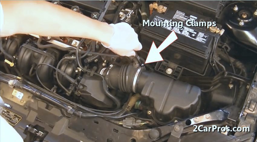

Step 6 - The air intake to the engine is metered by a mass air flow sensor, this sensor provides feedback data to the computer which is then processed. If this intake system is allowed to leak it will cause a misreading making the engine hesitate. Inspect the intake boot for tears or holes and replace if needed.

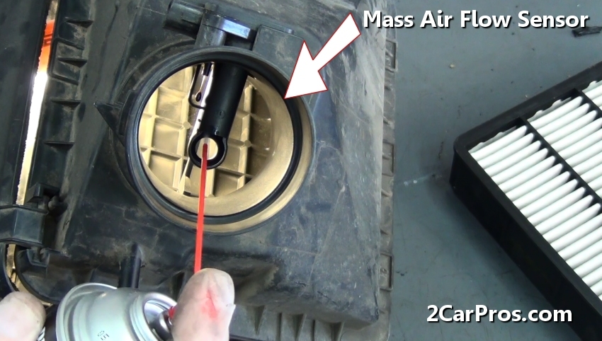

Step 7 - The mass air flow sensor is used to measure the air that travels into the engine. Inside this sensor is a hot wire that becomes contaminated which inhibits its ability to provide correct information to the computer. If this sensor has more than 70,000 miles servicing the sensor can help cure engine hesitation.

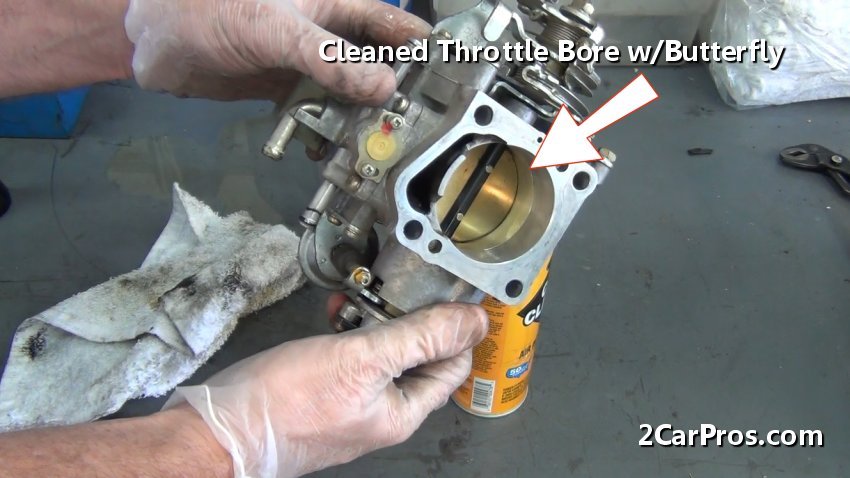

Step 8 - The throttle bore is designed to control the volume of air the engine will ingest. The butterfly and throat of the bore (plate) becomes contaminated with impurities and must be cleaned much like the mass air flow sensor. Once this condition is corrected the engine can return to normal operation.
cleaned throttle bore

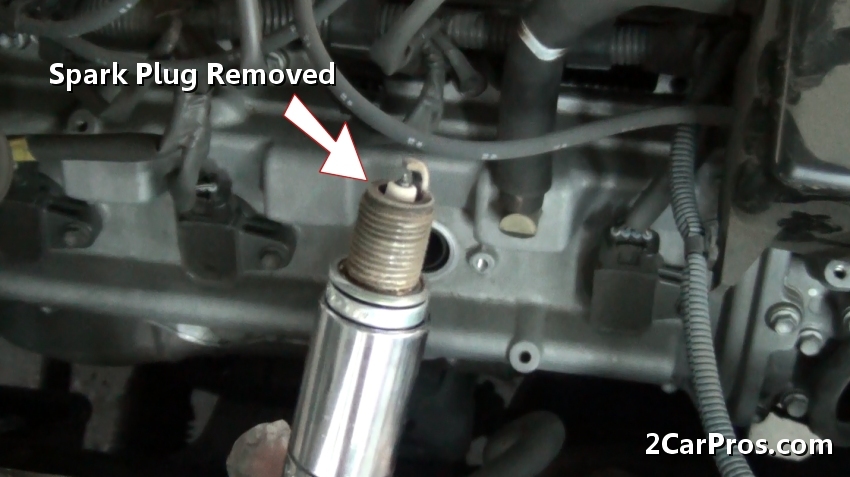

Step 9 - The spark plugs of an engine are designed to ignite the fuel air mixture inside the combustion chamber to provide the engine's power. If these spark plugs or maladjusted or worn they can cause the ignition timing to change causing a hesitation, remove the spark plugs to inspect.
