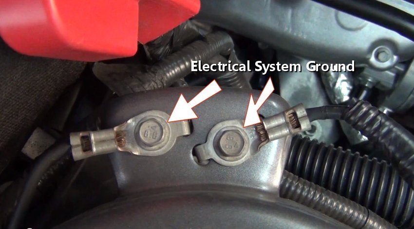

Computer systems require a good power source and clean ground to properly operate, in particular the injector drivers. These drivers rapidly open and close the injector which controls the amount of fuel entering the engine. If the ground has high resistance it will affect the injector duration allowing excess fuel to enter the combustion chamber.
Computer Ground
