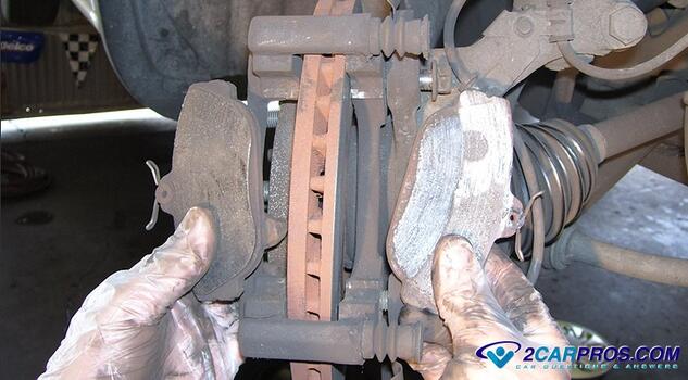

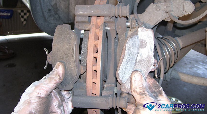

Uneven brake pads wear is a common problem with braking systems and can cause safety concerns. During any brake job when removing the brake pads you may notice that one brake pad is severely worn while the opposite pad in the caliper looks relatively unused, this is the first sign there is a problem. In this guide we show you why this problem occurs and what to do to fix it, we address this issue in the order of popularity.

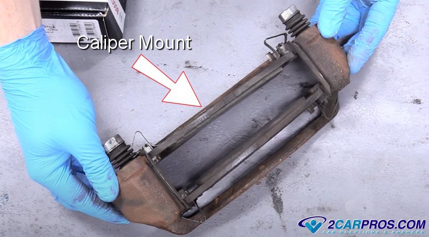

1. Contrary to what you may think it is not the caliper piston that is causing the problem. Here is what a typical brake caliper mounting bracket and brake pad carrier looks like.
automtoive brake caliper mount and brake pad carrier

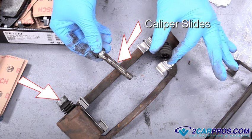

2. The number one cause for uneven brake pad wear is seized or poorly lubricated caliper slides. This condition will not allow the brake caliper to "float" freely which will cause uneven brake pad wear. The slides must be removed, cleaned and lubricated with brake grease at each brake job service interval.
automtoive brake caliper slides

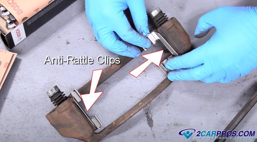

3. Brake pads are held in place by anti-rattle clips which can become worn or corroded, not allowing the pads to move freely which can cause the pads to "stick" inside the caliper mount, these should replaced with each brake service to prevent irregular pad wear.
automtoive brake pad anti rattle clips

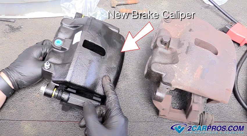

1. Inside the brake caliper there will be two or four pistons which if one or more of the pistons experience internal rust or corrosion causing the piston to seize inside the caliper housing, the only fix for this is to replace or rebuild the brake caliper.
new automotive brake caliper
